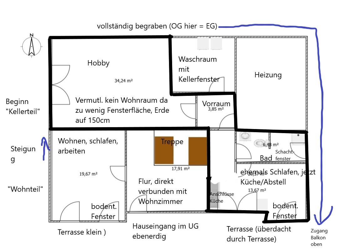

- I currently live in the basement, but because it is not fully separated from the living room (only one door), this is a huge problem and cannot continue long-term — or I will move out.

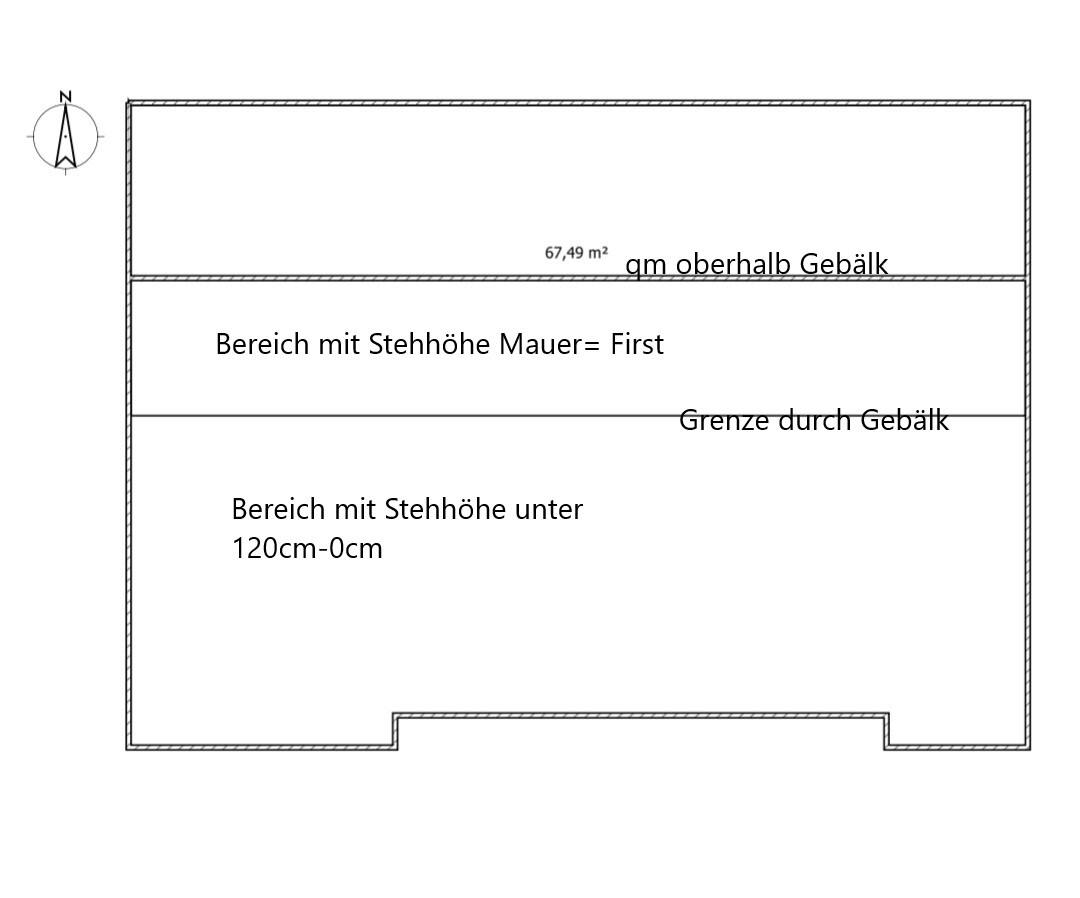

- The roof could be raised, but construction work (floor ceiling insulation, new photovoltaic system) has created conditions that, from our perspective, could make finishing the top floor uneconomical.

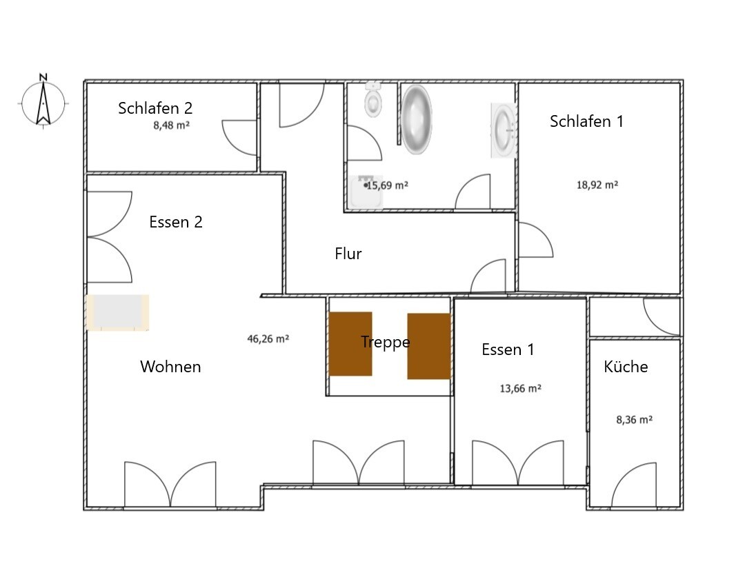

Upper floor (OG)

1. Roof expansion with external staircase.
Disadvantage: everything must be moved and newly created upstairs; it would only be one apartment without any view or balcony. An external staircase might not be approved by the local authority (building permit/planning permission). This would need to be specifically planned and checked.
2. Roof expansion with internal staircase: an entrance on the north side already exists, as well as an opening in the floor slab upstairs. I like this.
Disadvantage: again, everything must be newly created, and my parents would lose part of the hallway and the second bedroom (= the only possible children’s room near the parents, which might be unattractive for future buyers). Advantage: results in a 3-room apartment with an additional office, good for two people.

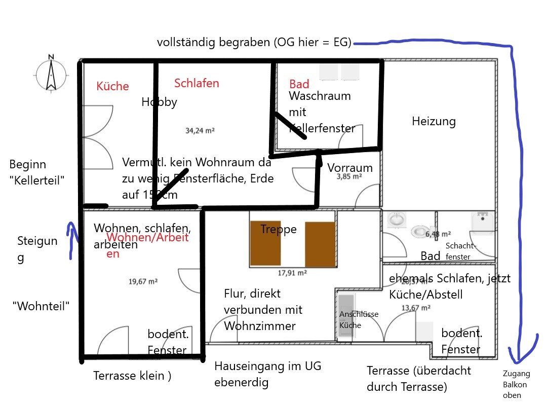

3. Connecting the ground floor “living, sleeping, working” area with the hobby room as kitchen/sleeping area, and the laundry room as bathroom. I like this idea too.
Disadvantages: According to the structural engineer, this is possible, but a pump would be required to carry wastewater upward, and part of the hill at the back would need to be excavated for light wells. Also, the fuse box control is located in the hobby room; exposed pipes would need boxing-in everywhere, and it’s unclear whether this conversion would be permitted at all. My current living space would at least already be finished, and no pipes would have to be run throughout the entire house. Small for two people.
4. The opposite connection: hobby, bathroom, kitchen/storage. Entrance to the right of the stairs.
Disadvantage: I don’t like this. 13sqm (140 sq ft) is far too small for living and cooking/dining, and the hobby room never gets direct light due to the neighboring house. My apartment would consist of the worst rooms in the house and would still occasionally have to be crossed through for laundry. Advantage: very cheap, as no functional rooms would have to be altered. To me, this is a botched job and no real solution, a money pit.
5. ???
Some sort of connection between the two living spaces downstairs. Possibly affordable because the kitchen and bathroom are already present, but no one can tell us how this would be feasible.
5. ???
