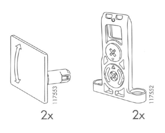

My two newer Rationell drawers had white plastic holders; the front was attached by rotating the side cover plates on the cabinet frame 90°. I was able to find the relevant instructions, and the parts look like this:
The manufacturer is unknown to me.
I would suggest trying the Ikea spare parts service to get the correct holder – otherwise, you can look further.

EyesOnly122 Feb 2016 10:35Hello,
for those who need it, here are the spare part numbers and the link where they can currently still be ordered from Ikea.
> Spare part number: 117552
> Front bracket
> Spare part number: 117553
> Side cover and simultaneous fastening
> Spare part number: 112792
> Matching screws
EyesOnly12
> Front bracket
> Matching screws

IKEA-Freund2 Feb 2016 11:13Hello,
You linked the numbers for the most recently sold version, but according to an IKEA expert, it was actually about the version before the previous one of the Rationell drawers.

EyesOnly123 Feb 2016 13:17Hello,
You linked the numbers for the most recently sold version, but according to the IKEA expert, it was actually about the at least the second previous version of the Rationell drawers.
Regards,
IKEA-FriendHello,
It is quite possible, but thanks to your post about the "new" version, I also discovered the new parts and, since this post is easy to find through Google, I have summarized everything briefly.
Anyone now searching for replacement parts for the new version will be able to find them as well.
