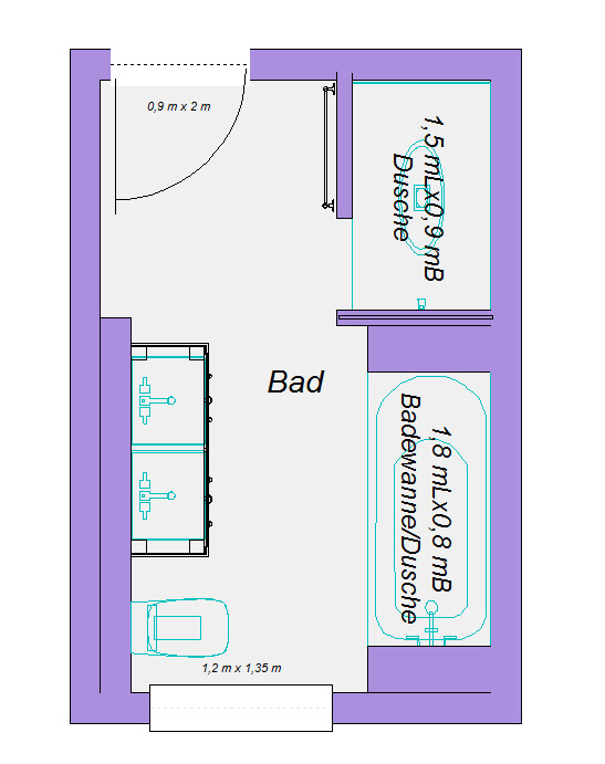

Since there is so much support here on various topics, I’m sure we can also get some help with bathroom planning 😉
Our bathroom is 2.58 x 4.00 meters (8.5 x 13.1 feet) in size, and we basically just want a walk-in shower measuring 1.40 x 1.00 meters (4.6 x 3.3 feet) and a not too large vanity unit. We’re also unsure whether we even want two sinks ^^
The floor plan currently looks like this:
We then recreated it in a room planner to see how the larger shower might fit.
The cabinets next to the shower I actually only added to mark the boundary because otherwise, it’s hard to tell where they end.
We’re not really keen on the corner bathtub, so we prefer a regular one placed along the wall, ideally with a rounded corner (like, for example, the Kaldewei Meisterstück Centro Duo 1, but in a more affordable version 🤨), since that allows easier access to the window.
The bathtub in the planner is 1.80 x 0.80 meters (5.9 x 2.6 feet), and there are still about 80 cm (31 inches) left to the wall.
Oh, and the vanity unit shown is 1.40 meters (4.6 feet) long; I just wanted to see what the maximum size could be.
What ideas do you have? We seem to have quite a bit of flexibility with the layout, but unfortunately, we’re not very creative 🙄
Looking forward to hearing from you

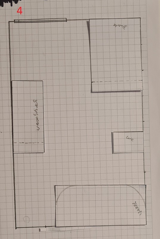

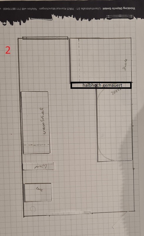

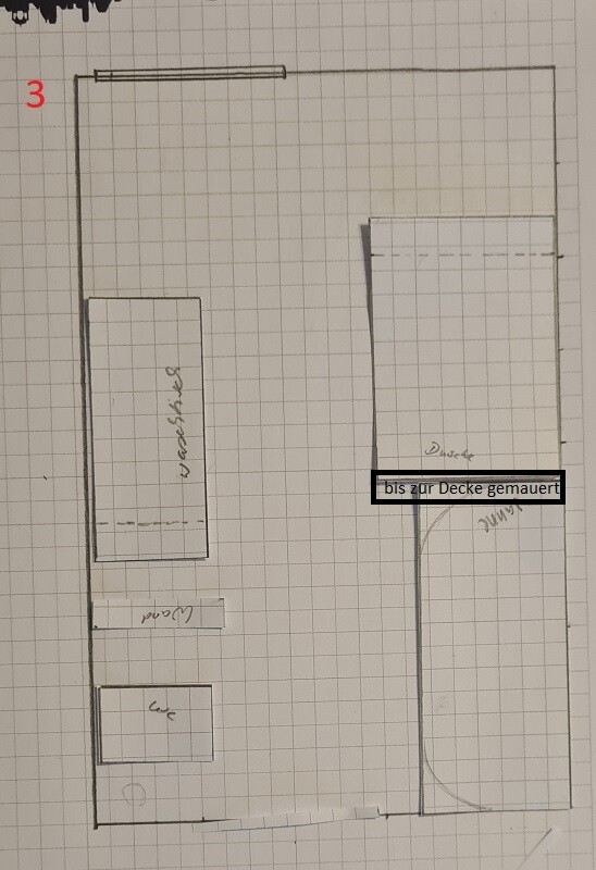

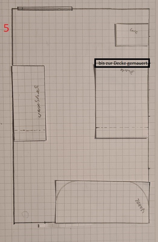

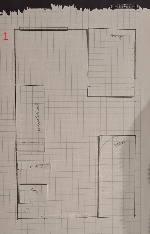

Here are a few paper bathroom layouts; my favorites are numbers 5, 4, and 1. The partition for the toilet in number 5 is really great, but I wonder how it feels to have a wall like that immediately to the left. Somehow I had imagined the 4m (13 feet) bathroom length to feel bigger. :p
What do you think?

Bertram1002 Feb 2022 17:08I would choose option 5 and swap the shower and the bathroom. The wall needed for the shower is already there. Then add a half-height privacy screen at the end of the shower. This way, the toilet will be in natural light but not so prominently right at the entrance.
