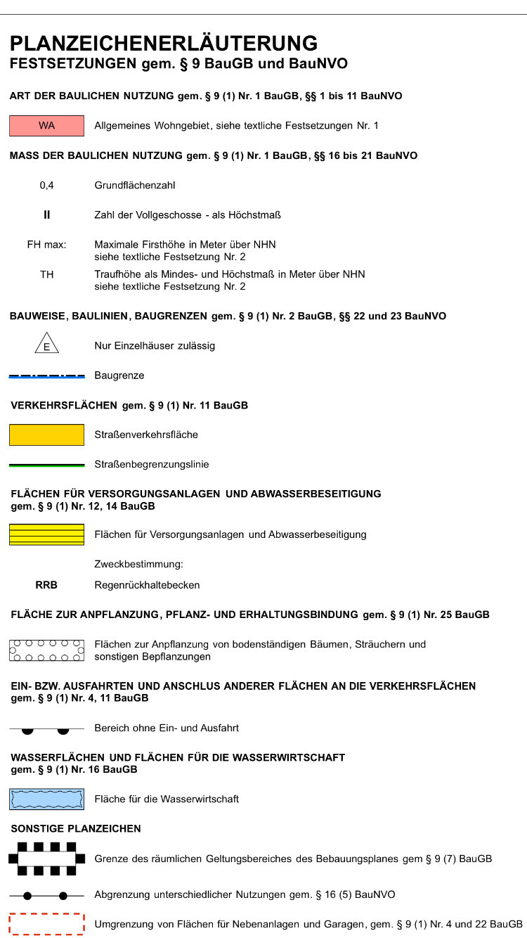

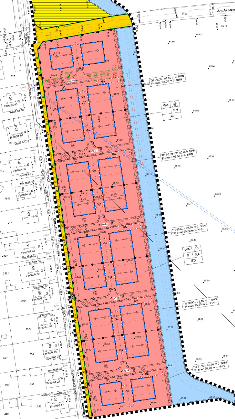

We are just starting to plan a single-family house.
Today, after a long wait, we received an offer for a plot of land. I have attached a picture.
It is plot number 14.
Now I naturally have some questions. The access is from the south, which is not ideal. On the other hand, it is a dead-end street, so the garden can be oriented towards the south, right?
What do you think about the overall orientation? It is important to me not to have sunlight only until midday.
Is it possible to estimate from the plan how long the sun will shine on the property?
Thank you very much for your support.

Andrea3004 schrieb:
I would say it’s rather average to dangerously incomplete knowledge 😀I meant, for example, whether you can identify what the "frame" on the plot is for your house, how many square meters and floors it is allowed to have, etc.
Andrea3004 schrieb:
I don’t know how to get the development plan sharp and readable so that I can upload it here. I’ll try to manage that...A smartphone screenshot probably won’t be any better. Links are not allowed here. So it’s best if you tell us the municipality and the number of the development plan.
You can also describe in words what the red / yellow / green plots in the legend mean.
Andrea300411 May 2017 16:25So, theoretically, does the development of plot No. 15 affect "our" plot No. 14?
A townhouse is generally not allowed. Only a gable roof and two stories.

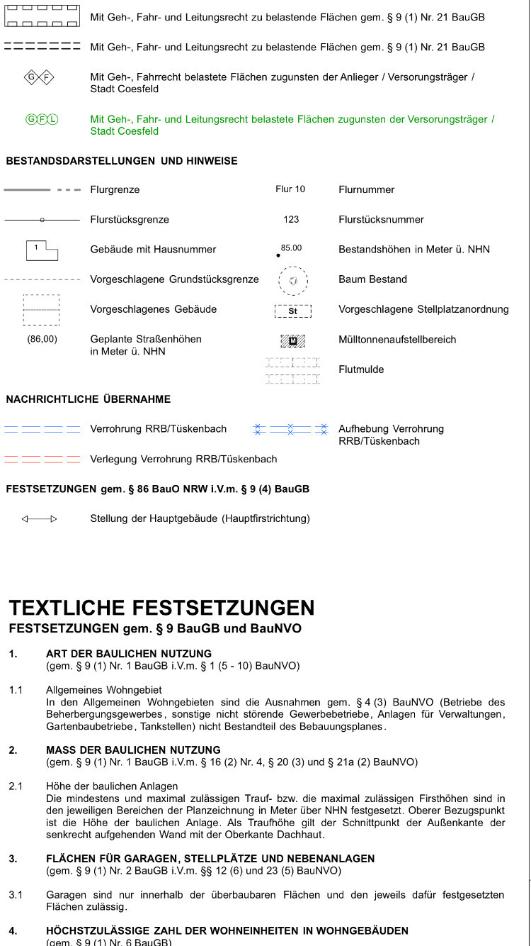

I have attached some more pictures. Hopefully, they help to see more clearly.
It is basically the fourth plot from the bottom on the right side. The part marked as an easement has been entirely assigned to our plot.
Andrea300411 May 2017 16:28The colors only indicate who is marketing the property. They have no other significance.
Andrea3004 schrieb:
Townhouses are generally not permitted. A townhouse can also have a gable roof and was probably only given as an example for 2 full stories.
Andrea3004 schrieb:
So, does this mean that the development of lot No. 14 theoretically depends on the building on lot No. 15?
A townhouse is generally not allowed. Only a gable roof and two stories.The shadow from lot No. 15 probably falls mostly within the setback area toward the street, and the shadow from the garage on lot No. 16 falls on your utility easement area.
In my opinion, this is a prime lot, with quite a good value level for Coesfeld.
I don’t see any exclusion of townhouses. Only the requirement for red brick cladding is not exactly my preference, but if you don’t like that, then you probably shouldn’t move to Münsterland.
The development plan is reasonable, even if you don’t fully utilize the site coverage ratio, including the garage. But two full stories (and with a roof pitch up to 40° which practically allows for two and a half stories) certainly won’t feel too cramped.
In my opinion, this is a prime plot of land I completely agree. To the east, there are no possible developments; to the south, the neighboring garage is at most 3m (10 feet) high and acts as a privacy screen, and the neighboring house is at least 13m (43 feet) away, aligned with the eaves side. To the west, there is only a shadow from the neighboring house late in the evening—so full sun all day. Additionally, the property is detached and located on a cul-de-sac. Given all this, accepting the easement and private access is definitely worth it.
