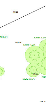

sauerpeter26 Feb 2017 10:01Ok, I’ll try to explain in more detail this time. Last time, it had to be quick.
We are building an urban villa with a garage that is supposed to stand directly next to it. Please take a look at the attached sketch. At the top is the neighbor’s elevation at 69.39 meters (227.7 feet). Then comes the boundary line, where the garage is planned to be, in the area without an elevation indication. At around 69.48 meters (228.3 feet), there is already part of the house.
I’m not sure if I understood everything correctly, but if we want to build our garage now, from the neighbor’s perspective the garage would be more than 3 meters (10 feet) higher. He is situated at a lower elevation. I have to consider it from the neighbor’s point of view, right? The architect said that the elevation in the area where the garage should be is at least 69.48 meters (228.3 feet) as well (this still needs to be measured), so then the garage might be possible. The problem is: according to the local design regulations, the garage must have a gable roof sloping toward the street at a 45-degree angle. That would make the height completely incompatible.

sauerpeter26 Feb 2017 10:10Our right neighbor’s property is roughly at the same level as ours. However, the left neighbor must have completely excavated a section of their land back then, which is why their property appears to be lower in some spots. Now we have to deal with that somehow.
The architect said that we could also build the house and garage at a lower level, but then there would be a dip in the driveway. When driving onto the property, you would effectively go slightly downhill since the public area in front of the lot is at an elevation of 69.70 meters (229 feet). That doesn’t make any sense, because I would constantly have to deal with large amounts of water and puddles during rain.

I still don’t understand either nothing or nothing that makes sense: Your plot is 9 cm (3.5 inches) higher than the neighbor’s. The height of the garage should not exceed 3 m (10 feet), cautiously measured from the neighbor’s ground level—that much I can follow. But the neighbor has a flat-roofed garage, and your garage is supposed to have a 45° pitched roof (which means the roof alone would be 3 m (10 feet) high at a length of 6 m (20 feet)). My question remains open: how are the garage roofs, "flat at the neighbor’s" and "45° pitched at yours," supposed to comply with the SAME set of design regulations?
