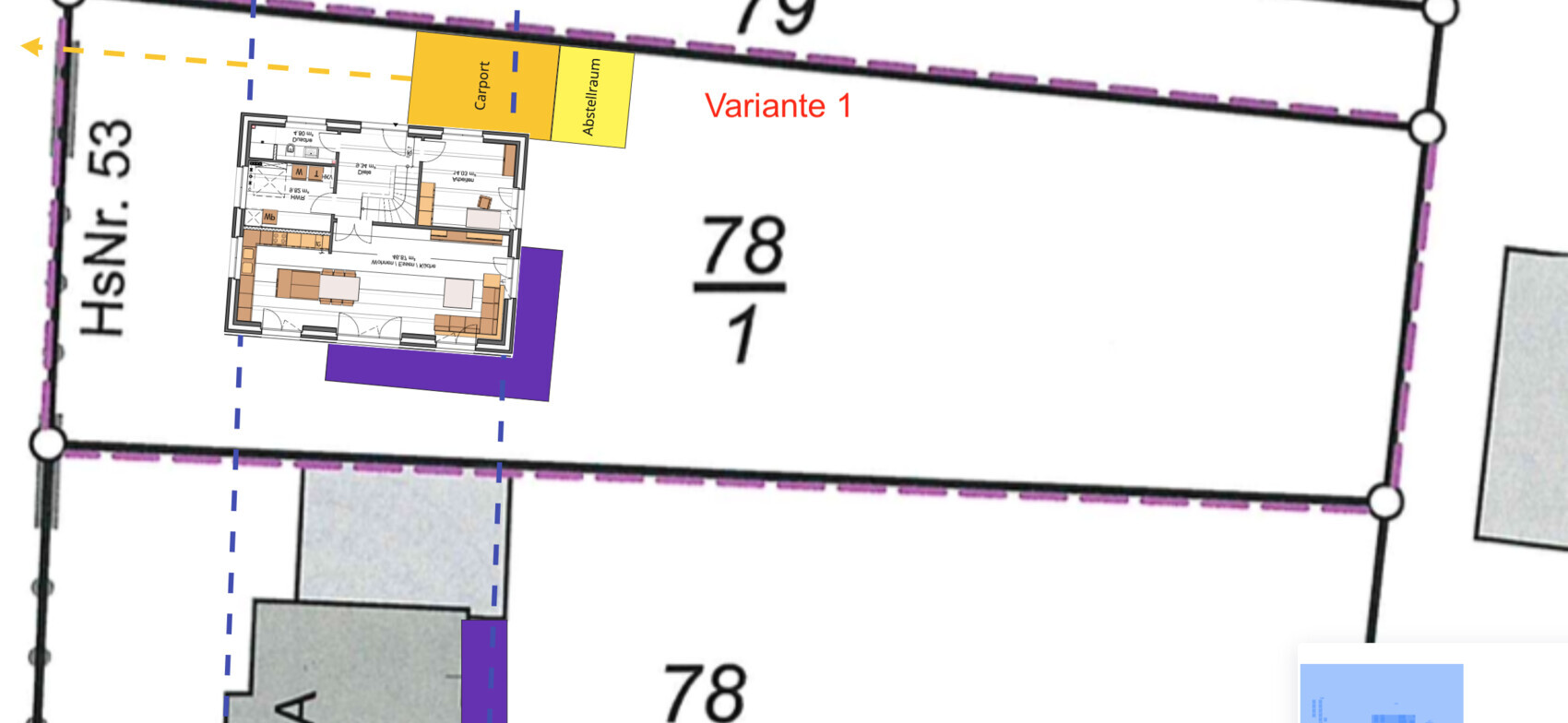

Option 1: Carport (4x6m (13x20 feet)) plus possibly a storage room (4x3m (13x10 feet)) on the north side of the house. We could place the driveway either towards the "main road" or possibly towards the field access road – this still needs to be clarified with the local authority (building permit / planning permission).
The downside here is that the guest room would no longer receive natural light from the north.

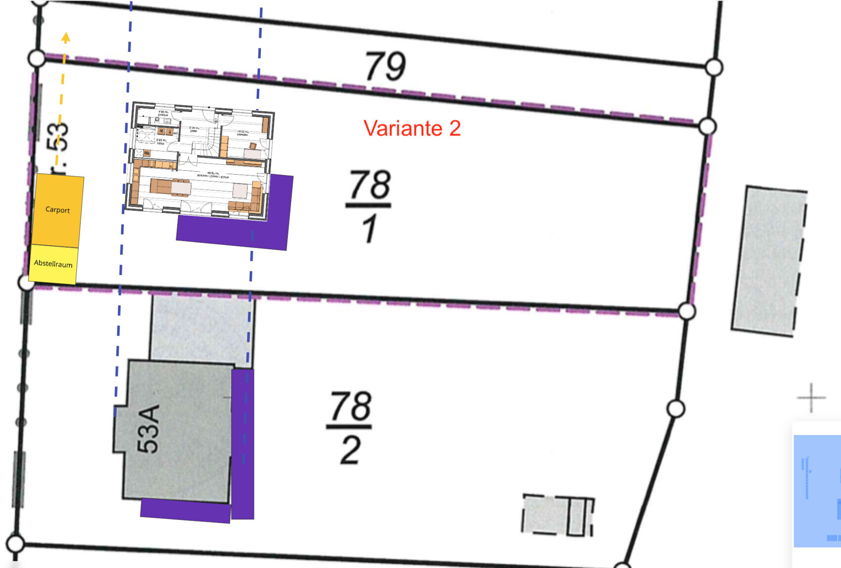

Option 2: Carport at the corner of the plot (see image right.jpg)
The benefit we see here is privacy from the street and 1 meter (3 feet) more space towards the neighbor’s garage on the south side.
We would build the carport so that it aligns with the kitchen window in length, allowing a view past it.

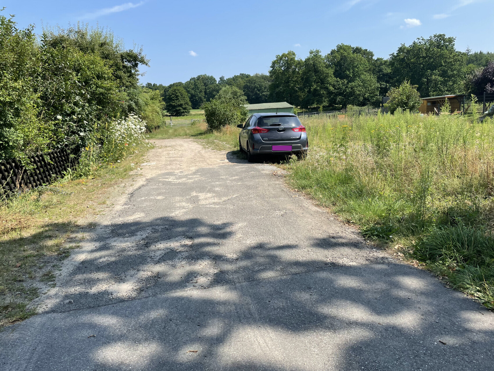

Gray car parked on the field access road, hedges and flowers on the left, tall grass and meadow on the right.

MaxiFrett schrieb:
Option 2: Carport at the corner of the property
I’m pretty sure (pretty sure! 😉) that a carport right next to the street is not allowed.
I would also keep that corner free for a bench or two chairs (west side).
MaxiFrett schrieb:
Option 1: Carport (4x6 m (13x20 ft)) plus possibly a storage room (4x3 m (13x10 ft)) on the north side of the house. We could have the driveway facing the “main road” or possibly the field path – we still need to clarify this with the local authorities.
The downside here is that the guest room would no longer get any natural light from the north.
Great choice! Personally, I wouldn’t have mirrored it, but that’s really a matter of personal preference.
You can easily do without the north window in the office if the east window is large enough.
Maybe your wardrobe will be placed there anyway?
MaxiFrett25 Jul 2021 14:50
I am actually (really! 😉) quite sure that a carport directly adjacent to the street is not allowed.
I found the following information in the FAQs of easycarport.
  • A footprint up to 30m² (323 sq ft) and a maximum average wall height of 3m (10 feet) are exempt from building permits / planning permission.
  • The parking space depth (length) must be at least 5m (16 feet).
  • For boundary construction, the carport may be built up to a maximum of 9m (30 feet) along one boundary and 15m (49 feet) along all boundaries combined.
  • The parking space width is set at 2.50m (8.2 feet), or 2.40m (7.9 feet) for carports with one side wall.
  • A driveway of 3.00m (10 feet) must be available between the planned parking area and the public traffic area (street).
Regarding the requirements for boundary construction, the following conditions apply:
  • Construction directly on or up to 1.00m (3.3 feet) away from the property boundary is only permitted if 1. the parking space is smaller than 36m² (388 sq ft), 2. the length does not exceed 9.00m (30 feet), and 3. the planned carport’s highest point does not exceed 3.00m (10 feet). Since disputes with neighbors often arise after building a carport, it is recommended that the builder try to obtain written consent from the neighbor.
Based on this, our carport is under 9m (30 feet) length and 36m² (388 sq ft); the driveway would also be over 3m (10 feet).
25 Jul 2021 15:19
MaxiFrett schrieb:
I found this in the FAQs of easycarport.
Haha… better check the building regulations of your country, possibly construction law, etc. There is no zoning plan, but if you take a closer look at the cadastral map, you will find some imaginary lines or boundaries 😉
In rural areas, it is generally prohibited to build right on the property boundary along the road… in the center of a city, the property boundary usually coincides with the building line.
By the way, the company relies on boundary construction that borders the neighbor’s property, not the street.

or possibly towards the dirt road
I consider that to be out of the question.

From an urban planning perspective, option 1 is preferable; option 2 offers better land use, but I would modify it (double carport without storage room).
I’m actually (actually! 😉) quite sure that a carport directly adjacent to the street is not allowed.
Based on the cadastral map, I would also have doubted its approval, but aerial images show that two neighbors have already placed their ancillary structures in front of the actual building line in the front yard area. The question remains whether they asked for permission or just built it like that.

If the carport is allowed next to the street, I would build a double carport and drive in directly from the main road—without parking spaces in front of it. Then you can add a storage room at the back, which also provides privacy.

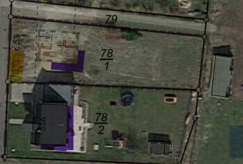

You have now placed your living area with the large windows directly opposite your neighbor’s house, creating the worst possible view. Therefore, I would definitely move the house as far north as possible. Also because the sun will quickly disappear behind your neighbor’s house in winter. In your Google screenshot, the shadow casting is already clearly visible. Your south-facing garden will be nicely shaded and will visually become a dark spot :p
Luftbild eines Grundstücks mit Grenzlinien und Gebäude-Overlay
If you really want to orient the house this way, I would move it as far east as possible, so it is not directly facing your neighbor. You have enough space for that, right?
