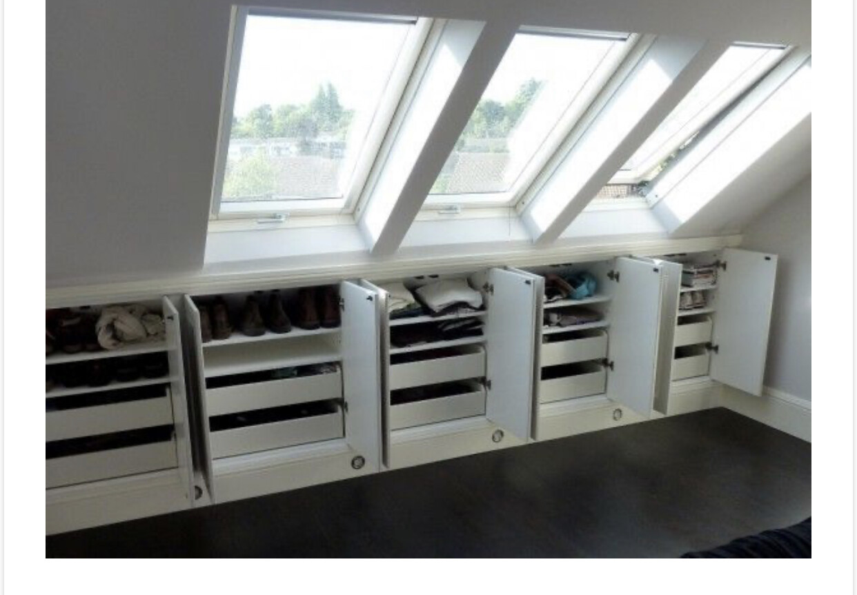

Specki schrieb:This is roughly how it looks, with or without doors...
This way, each child’s bedroom could also have a small storage closet. And the actual storage/workroom becomes a bit larger. You’d just add a partition wall or similar.
