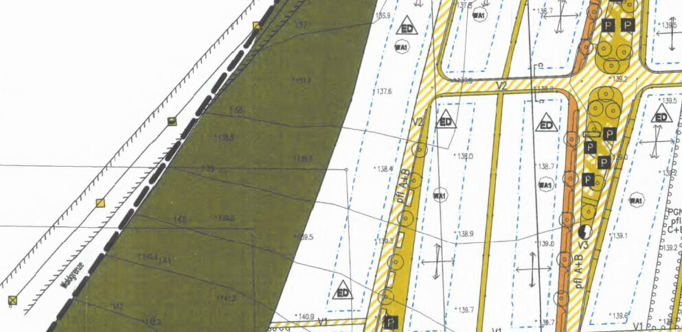

As previously announced, our old house in Baden-Württemberg has now been sold, we have moved to the Leipzig district, and we can now focus on our new house. Due to our age, we have deliberately downsized both the lot size and the living space. We have a first architect’s draft. I have already noted a few change requests and am now looking forward to your additions, criticism, and suggestions. If further plans or similar are needed, I will gladly provide them as long as I have them available.
Thank you in advance for taking the time to help me.
Lot size: 567sqm (6,105 sqft)
Slope: visually not noticeable; if this is important information, I will look for where to find it
Site occupancy index: 0.35
Floor area ratio: 0.8
Building envelope, building line, and boundary: see attached drawing
Edge development: not allowed/desired on our part
Number of floors: 2
Roof type: hipped roof
Style: classic, conservative
Orientation: ?
Maximum heights/limits: “Top of raw floor slab of ground floor to ridge height of main roof max. 11.5 meters (38 feet)”; “Top of raw floor slab of ground floor to eave height of main roof max. 7.0 meters (23 feet)”

I don’t quite understand why you want to position the house so far into the lot when the beautiful west side faces fields and woods, and there’s only a street at the front. That way, you’re actually reducing your garden space. Also, I’m not sure why you plan to place the bedroom facing south towards the street instead of swapping it with Workroom 1 (northwest, facing the garden). A sauna in a large wellness bathroom with a view of the garden is a nice feature—we have that too. Since there’s plenty of space for two of you, you might consider placing the sauna at the bottom of the plan, with a window looking out to the garden (where the WC and washbasin are currently located), and then have the door to the bathroom right after the stairs. The WC and shower could be placed in a T-arrangement where the sauna and shower are now. A future buyer could then separate the sauna as its own room and convert it into a dressing room. On the ground floor, I would shorten the hallway and utility room by about 50cm (20 inches) to give the living room 50cm (20 inches) more depth. 3.55m (11.6 feet) is quite narrow. The last two steps of the staircase usually disappear into the ceiling and wouldn’t be visible. You seem to want the rest exactly as it is, and I’m sure you’ll make it look great.

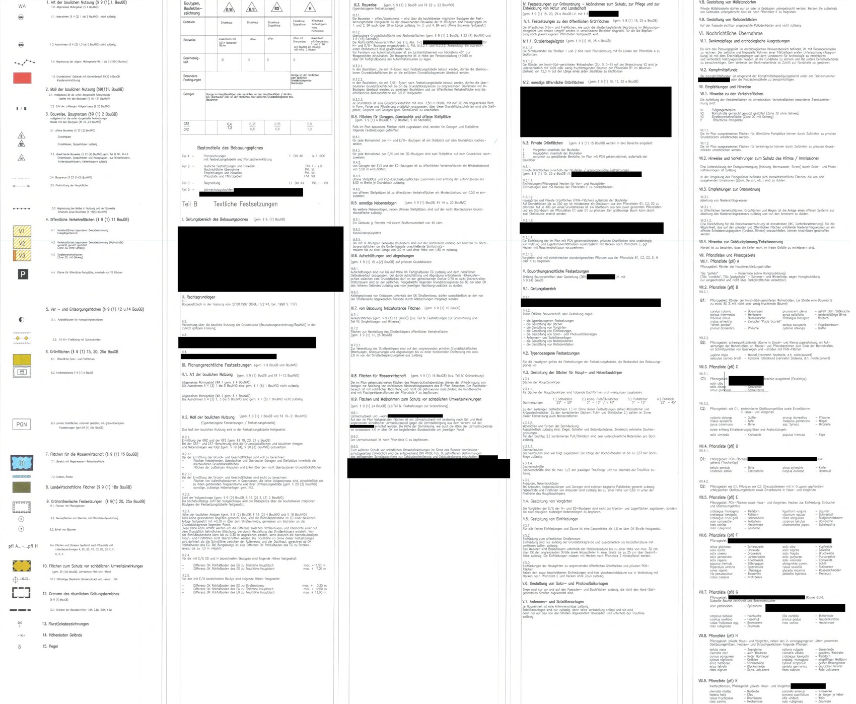

I’m following up with what the original poster has emailed me so far: I have included the legend and the textual provisions with their original redactions—which I will not comment on here—from the combined drawing/text plan document. I also reconstructed her extract from the image section of the original PDF so that at least what is shown can be somewhat “read.” Unfortunately, the extract really doesn’t show much, including no parcel boundaries :-(
