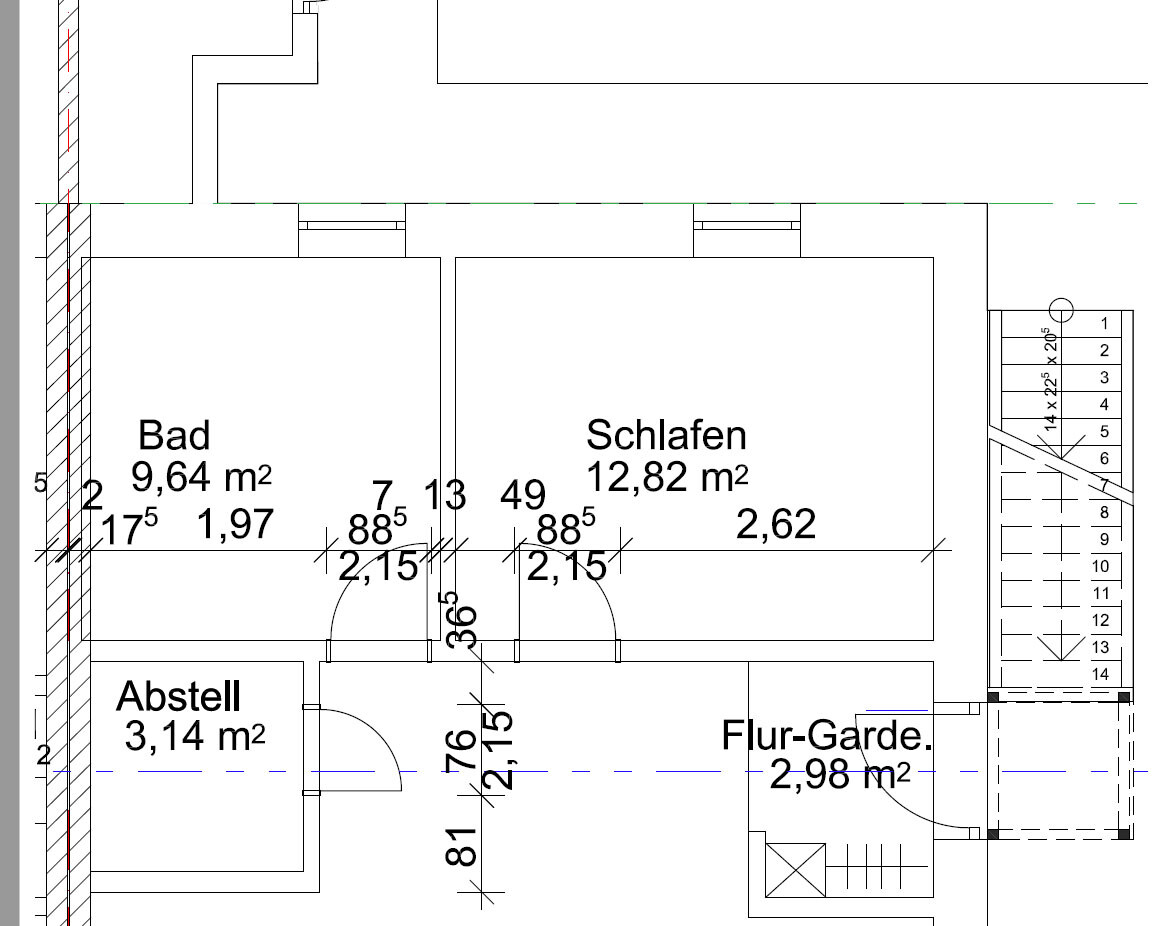

knalltüte26 Jul 2020 17:42... completely forgot to note down the measurements separately since the dimension chains are not shown.
The rooms are each 3.21 m (10.5 feet) deep, the bathroom is currently 2.93 m (9.6 feet) wide, and the bedroom is 3.99 m (13.1 feet).

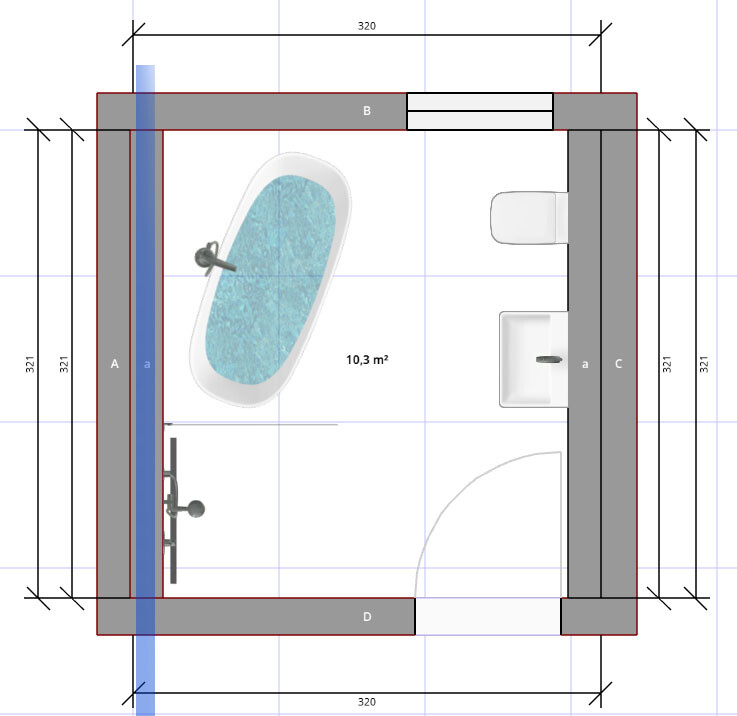

knalltüte26 Jul 2020 17:59This is what my current plan looks like, with a width of 320cm (126 inches).
The blue lines show the planned ductwork for the mechanical ventilation system from the external utility room to the laundry room.
However, about 1.4m² (15 sq ft) of space is "lost" due to the roughly 22cm (9 inches) deep pre-wall installation elements in the bathroom.
This is a bit unfortunate for the small living unit, and I would like to avoid it, but I can’t find a better solution.

pagoni202026 Jul 2020 18:47I would probably skip the freestanding bathtub. In my opinion, such a tub needs enough space around it, but often I see setups (like in my former neighborhood) where the tub has to stand quite close to the wall, with the fixtures squeezed in between.
I would much prefer a nicely built-in bathtub. My feeling is that the freestanding one would look cramped; I would rather go for 180 or 190cm (71 or 75 inches) for that.
How about placing the bathtub to the left after the door, and the shower at the top left of the plan? That way, the shower could really have the desired size, with the toilet and shower facing each other.
