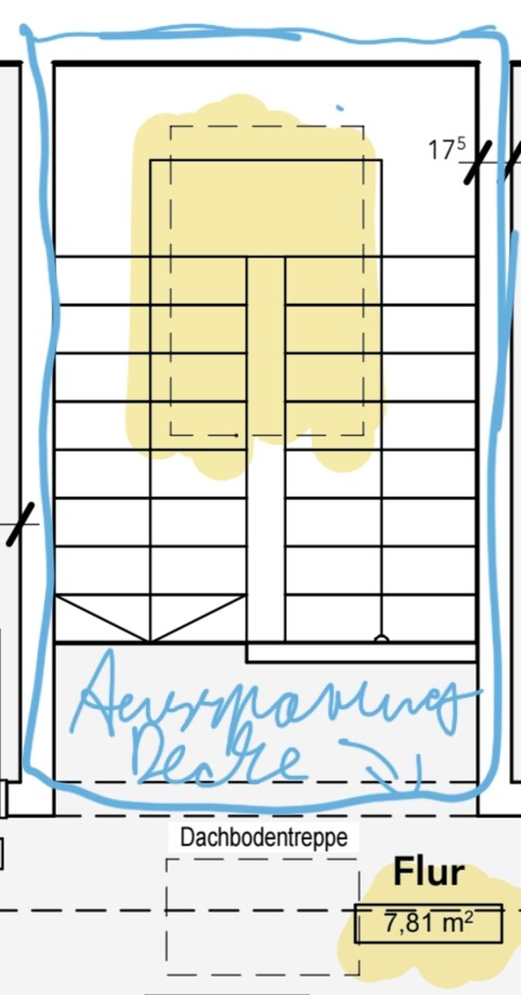

In our specific case, as already mentioned, a roof window was planned in the original design with the idea to better illuminate the corridor on the upper floor and also the end of the ground floor. For this, the floor ceiling would have to be interrupted, and the opening on the attic would be framed accordingly. It would have looked like the attached drawing. We abandoned this idea for practical reasons (cleaning, storage space in the attic). We have not yet discussed the issues of cleaning and ventilation with the architect regarding fixed glazing. That is why I am looking here on the forum for alternative ideas.
