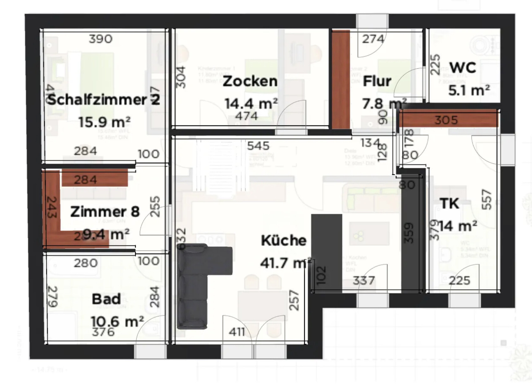

Here’s an idea that comes to mind (just a rough sketch, not fully developed, purely spontaneous)
Floor plan of an apartment with kitchen, bathroom, hallway, WC, bedroom 2, room 8, gaming area.
Summer27
9 Jul 2024 08:06
Wouldn’t it make sense to include your daily routine along with your evening or even all-day hobby in the planning?
This is something that comes to mind (just a rough idea, not fully developed, more of a spontaneous thought)
Wow, thanks so much for the effort you put into this spontaneous draft. It definitely helped me realize that I need to free my mind from fixed rules like all rooms opening off a hallway and having a centrally located entrance area.
The only thing I personally feel is missing is the sports area. A treadmill and rowing machine aren’t very decorative, so I’d prefer to keep them out of the living space. Taking them into the office would probably make things too cramped, especially since I like to watch TV while running, which I guess would bother my husband.
After your general and specific feedback, we had mentally gone back toward the original floor plan. But then I saw this interesting draft. We’re also reconsidering whether we really need a side entrance or if placing the main entrance on the shorter, east side as originally planned might be better.
We’ll continue to discuss this intensively today. And maybe our builder will have a creative suggestion as well.
