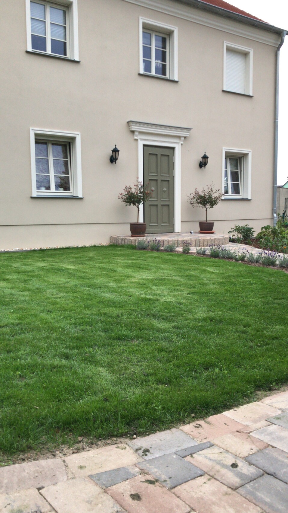

Zweistöckiges cremefarbenes Haus mit grünem Eingang, zwei Laternen, Topfpflanzen und Rasen
driver55
29 Nov 2021 18:59
Georgian2019 schrieb:
Otherwise, 5 ceiling spotlights turn on when it should be bright
Everyone has their own preference. 😉
Personally, I prefer it bright, of course.
Georgian2019
29 Nov 2021 19:41
In winter, it’s dark anyway in the mornings and evenings, so at least passersby can see through the door windows what’s going on in the hallway.
