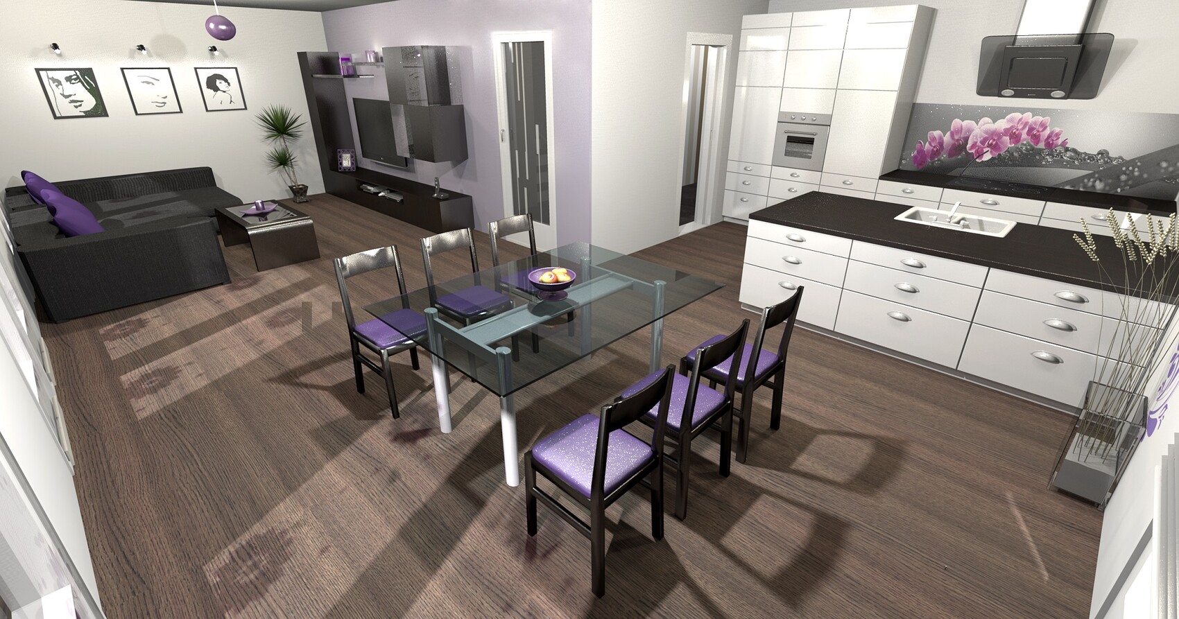

1. The doors to the living room and kitchen will probably be sliding doors, mainly because it is awkward otherwise to enter the kitchen and the door would hit the kitchen cabinet behind. Accordingly, the wall extension between living room and kitchen will be removed as it won’t be needed, creating more space in the dining area.
2. The peninsula will be made wider and possibly a little longer; the sink will be placed there, the cooktop will remain somewhere along the long kitchen countertop.
3. The windows in the living-dining area will probably all be floor-to-ceiling because otherwise, it looks unattractive from the outside. It’s not ideal that the sofa will be right in front of the right-hand floor-to-ceiling window, but it can’t be helped. Since the patio door used daily will be the one in the middle, this is bearable.

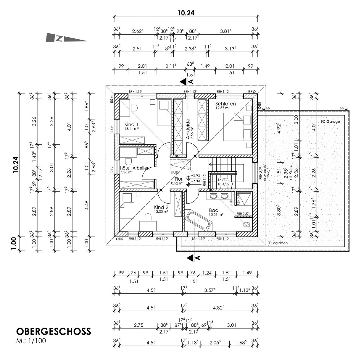

- Upper floor:
1. The door to the bedroom will of course be as wide as the others; no idea if this is a mistake on the architect’s drawing, we haven’t discussed it with him yet.
2. The bathroom layout definitely needs to be changed. We like T-shaped solutions, but a toilet right next to the door is a no-go, plus we want a larger shower. Recently, I found a bathroom floor plan here in the forum with dimensions similar to ours and adapted their bathroom design *shame* into our bathroom. It looks like this:
We actually like it; spacious shower (approx. 1 x 1.80 m (3 ft x 6 ft)), unsure if a glass door is needed since the wall is under the shower and there is no long side wall; hidden toilet (niche approx. 95 cm (3 ft) wide, should be sufficient?); just need to check whether that works with the window by the toilet or if we have to shift it (and consequently also the ones in the utility room and possibly child’s room 2 and guest WC).
3. Our biggest concern is the window in the walk-in closet... it spoils the west exterior view, and because of the window, only narrow cabinets seem possible on the left side of the closet (which I could live with).

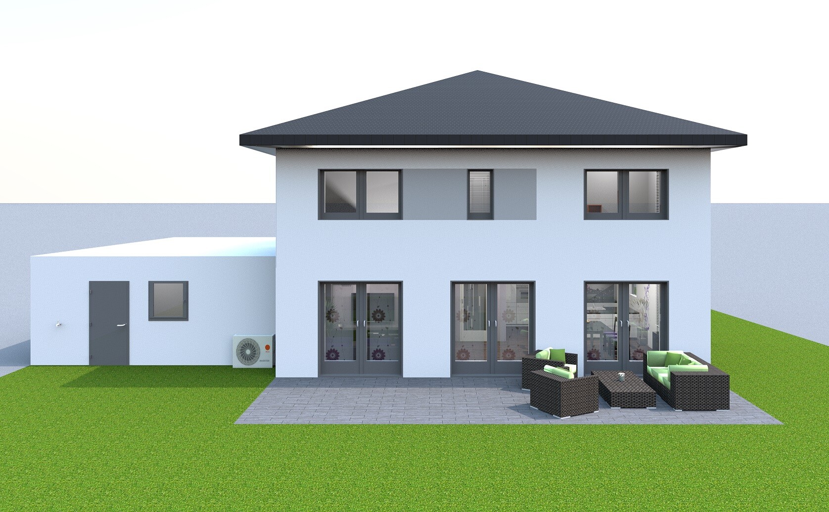

- West elevation:
Speaking of which... the ground floor windows will be floor-to-ceiling for a uniform look. But I find the middle window upstairs (in the walk-in closet) spoils the view. What do you think, is the view bad? I tried making all windows uniform—floor-to-ceiling on the ground floor and with sills on the top floor. It would look like this:
Can it be left like this, or is it a no-go? I don’t know... the west elevation really gives me a headache... and seems to be the only seemingly insurmountable problem in the design.

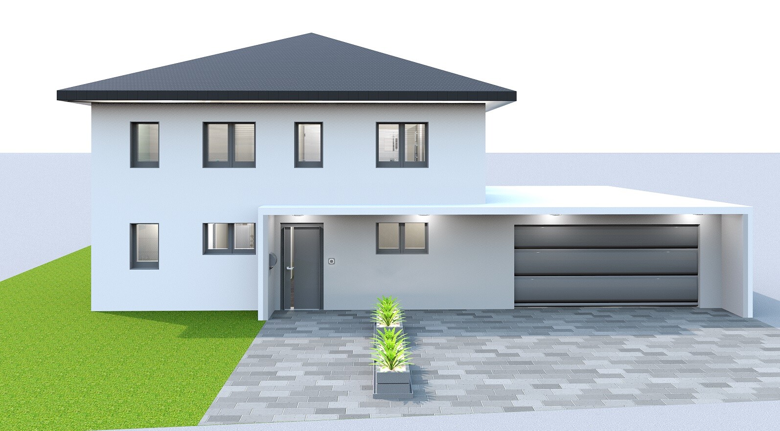

- South elevation:
We don’t like that the windows on the ground and upper floors are not aligned, but unfortunately, it can’t be changed. That’s why I had the idea not to make the kitchen window (bottom right window) floor-to-ceiling but rather a "light strip," which of course gives us more design freedom in the kitchen (distance between kitchen units, width of island, etc.). It would look like this:
And I can live with that. Or what do you think? The south side is not so important to us anyway because the neighbor’s garage stands at the property boundary, and our house will have only about 3.50 m (11 ft) space to the boundary but will sit considerably higher than the neighbor’s due to the filled plot.

- Upper floor:
- West elevation:
- South elevation:

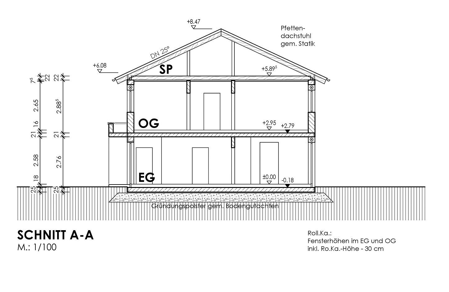

So, now that our floor plan is finalized, I’d like to post an update. Not much has changed, as the layout already suited us well overall and no major issues were raised here in the forum.
The building permit application was submitted with the current floor plan and has already been approved. Significant changes are therefore basically no longer possible, nor do we want any, since we really like the floor plan. Minor adjustments can still be made, so if you have any ideas, please feel free to share them.

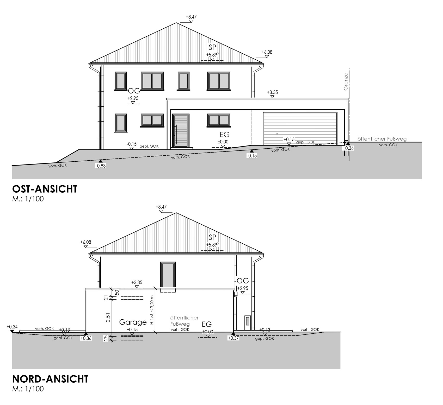

Regarding the window issue: we slightly adjusted and standardized the window sizes on the east side (street side). The kitchen window on the south side is no longer floor-to-ceiling, as we probably wouldn’t have used it as a garden access anyway, and it feels more balanced this way. On the west side, I wasn’t entirely comfortable with the window in the dressing room. We moved it a bit so that 60cm (24 inches) cabinets fit on both sides, and it is no longer floor-to-ceiling either. In my opinion, the exterior view isn’t perfectly balanced, but that’s the compromise we have to accept. I can live with that. The important thing is that the windows fit well inside the rooms. Later, when we apply the exterior plaster, we will play with colors to try to visually soften the unevenness, and I think it won’t look bad in reality. I am attaching some screenshots from Sweet Home 3D where I tried to recreate the design. Please consider the SH3D images just as a rough guide, as it’s not 100% precise.
The window on the north side (stairwell) is not finalized in terms of dimensions yet; it may be shortened slightly. We are currently discussing this with our planner.
We did actually change the bathroom layout to the alternative I showed in my first post. Whether this will be changed again remains to be seen. This doesn’t have to be decided right now.
As for Children’s Room 1 and the study, we are still considering whether to remove the wall (as was suggested here in the thread) to create a larger children’s room (essentially with a dressing area) and use Children’s Room 2 as the study, only separating the two rooms once we decide to have a second child. We have briefly discussed this with the structural engineer, and it should be feasible. Whether we will actually do this will be decided before construction starts.
Karlstraße10 Dec 2016 15:27Conclusion: Cohesive design!
But please remove that gray box around the windows on the south side—what is it supposed to be? Trying to suggest a kind of light strip? It’s half-hearted and unnecessary, I would skip it. For the walk-in closet, consider adding a small wall right at the entrance so you don’t face a wardrobe directly, but could instead hang a mirror on the wall there, for example. Unless no tall wardrobe is planned for that spot, then it’s a different matter.
Oh, and for the kitchen, I might consider a freestanding kitchen island that is more square and positioned in the middle. I find that nicer than the layout you sketched. That’s exactly what we have right now in our rental, and I don’t find it practical or attractive.
