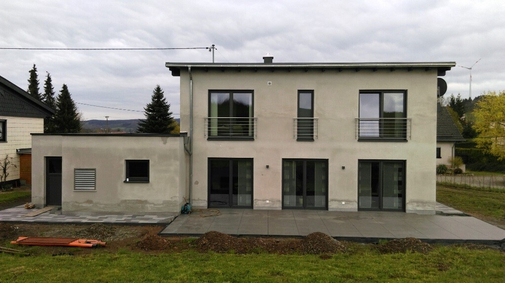

Hello!
Your house plan somehow reminds me of ours.
Here are a few things I would change:
- All living room windows should be floor-to-ceiling and only 2.01m (6.6 feet) wide. We did the same. That’s more than enough. I don’t see why one should be wider.
- Remove the short wall section in the living room.
- I would even skip the door to the kitchen. We preferred to place kitchen cabinets along the right wall of the plan. Otherwise, you will have little to no space for tall cabinets.
- Overall, I’m not happy with the layout upstairs. It looks like the study room is just squeezed in between the two kids’ rooms. Both kids’ rooms are quite small and planned with only narrow wardrobes. The upstairs bathroom is relatively large but also very difficult to furnish.
The dressing room window shouldn’t be a problem, though. We have a narrow window there (children’s bathroom), and all the others are 2m (6.6 feet) wide. Maybe a real photo will help you visualize it better:
Edit: Looking again at our design, I would definitely add a window to the garage/storage room.
Jochen, thank you for your response as well.
Jochen104 schrieb:All floor-to-ceiling windows are already on our list; we will definitely do that. Regarding the width, you might be right, and it’s something worth considering. It would also contribute to a more uniform appearance.
- All the living room windows are floor-to-ceiling and all only 2.01 m (6 ft 7 in) wide. We have the same. That’s more than enough. I don’t see why one should be wider.
Jochen104 schrieb:Yes, definitely. That’s already on our list as well. We will have sliding doors in the kitchen and living room, so this wall extension doesn’t make sense anymore.
- Remove the short wall in the living room.
Jochen104 schrieb:That’s not an option for us. It’s important for us to have a door to the kitchen and a door to the living room. I have already roughly planned the kitchen, and there should be enough space for everything even with the door.
- I would even omit the door to the kitchen. We prefer to place kitchen cabinets on the right-hand wall of the plan. Otherwise, you have little to no space for tall cabinets.
Jochen104 schrieb:Your criticisms are not unfounded, of course, but even if it makes me seem a bit stubborn, none of these issues really bother us. The home office ended up like this because we didn’t see where else to put it. Originally, we considered it on the ground floor, but then the large kitchen-dining area would have been too small. Upstairs, the office only fits where it is now, and we are very happy with that location. Everything basically depends on the landing staircase in the center of the house – but that is very important to us and ranks high on our “must-have” list. We already visited a show home with a very similar arrangement regarding the staircase, kids’ rooms, and the office, and we liked it a lot. So for us, this is completely acceptable. We might also follow kbt09’s suggestion and leave out the door between the kids’ room and the home office for now, as the office is just a “reserve” room in case we decide on a second child. The kids’ rooms are not very big, that’s true, but in our opinion, they aren’t too small. We’ve seen similarly sized rooms in new builds among acquaintances and find them perfectly acceptable. Of course, bigger is always nicer, but since we also want a large walk-in closet and a reasonably sized bathroom, that’s the trade-off. But even that doesn’t really bother us; nowadays, many houses have kids’ rooms around 12–14 m² (130–150 sq ft). The fact that the wardrobes in the kids’ rooms are actually rather narrow (somewhere between the two wardrobe widths in the walk-in closet) only occurred to me because of your remark, thanks for that. But that should be fixable by shifting the door in kid 2’s room a few centimeters (in line with the door to kid 1’s room) and moving the window in kid 1’s room slightly (we’re still working on the south elevation anyway). Arranging the bathroom is not so easy, that’s true, because it is rather narrow – but that is also due to the landing staircase, which, as I said, is a must-have for us. Still, I think it can work well. My revision of the bathroom layout already looks very good to us; a little more fine-tuning (and possibly swapping the bathtub and washbasin) and it should be perfect.
- In general, I don’t like the layout upstairs. It looks like the home office was just squeezed in between the two kids’ rooms. The two kids’ rooms are very small and are only planned with narrow wardrobes. The bathroom upstairs is relatively large but also very difficult to arrange.
Jochen104 schrieb:Thank you so much for the photo; it really helps me visualize it much better, and I have to say, it doesn’t look bad. However, you also have floor-to-ceiling windows everywhere upstairs, which I should consider for our design; I’m worried about kid 1’s room, which isn’t very big and would then have floor-to-ceiling windows on both sides, which of course reduces options for furniture placement (e.g., a desk)… we’ll see. Regarding a window in the storage room, we also thought about it but then felt it might take up useful space and might not be necessary. Do you think we should install the window? We’re still undecided and will reconsider. The advantage would be that the storage room wouldn’t be so pitch dark.
The walk-in closet window shouldn’t be a problem. We have a narrow window there as well (children’s bathroom) and the others are all 2 m (6 ft 7 in) wide. Maybe you can imagine it better with an actual picture:
I find it quite practical when part of a wardrobe is only 40cm (16 inches) deep. You should keep in mind how much you hang (for that you need 60cm (24 inches) depth) and how much you store in drawers or shelves. Personally, it annoys me when wardrobes where I keep T-shirts, sweaters, socks, underwear, etc., are that deep. You never really need it. I’d rather have more running meters of wardrobe with only 40cm (16 inches) depth. That way, you can easily reach the items. Looking at it now: we have 4m (13 feet) of wardrobe, no walk-in closet yet (planned for the new build), and a continuous depth of 60cm (24 inches). That works great for hanging clothes, but for everything else, I would personally prefer shallower shelves that are not too high—more boards or, even better, drawers. Right now I pile up high stacks of T-shirts because with 60cm (24 inches) depth, the shelf height can’t be too low (otherwise it’s hard to reach items at the back), yet I have about 25cm (10 inches) of free space in front of the unstable piles. Eventually, you start stacking in a second row. Not ideal. I’d rather have shallower shelves where everything is easy to reach at the front.
But if you prefer to hang a lot and fold less, the ratio of 60cm to 40cm depth should reflect that.
My T-shirts are folded, so I need shelves accordingly. Those who prefer to hang them need more 60cm (24 inches) deep wardrobes.
In the kitchen, I would leave out the door and instead make the patio door at the dining area double-sized—or even larger. I think that would also improve the exterior appearance on the south side. In return, this side could be fitted with kitchen cabinets (this was mentioned here before, I believe). Instead of the door, for example, you could have windows or a strip of daylight above the countertop, possibly wider than the planned patio door (I would extend it across the entire length of the countertop). This would provide more light and be more useful.
