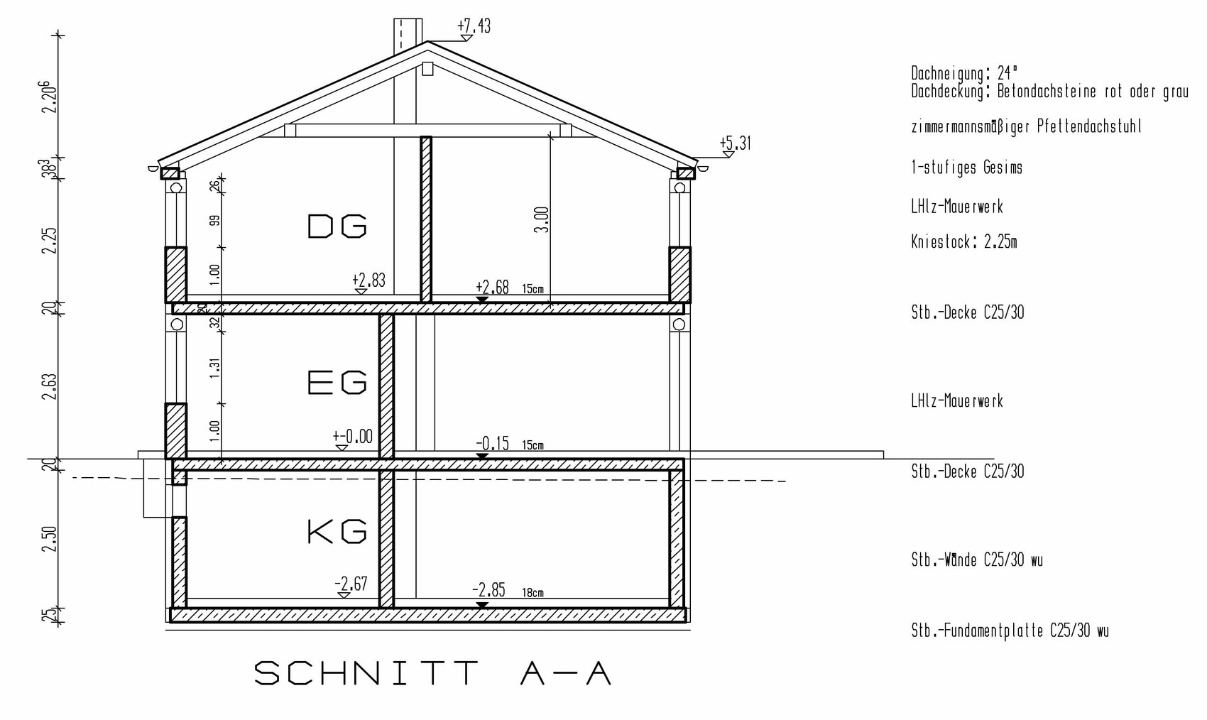

Cross-section A-A of a three-story house with basement, ground floor and upper floor.

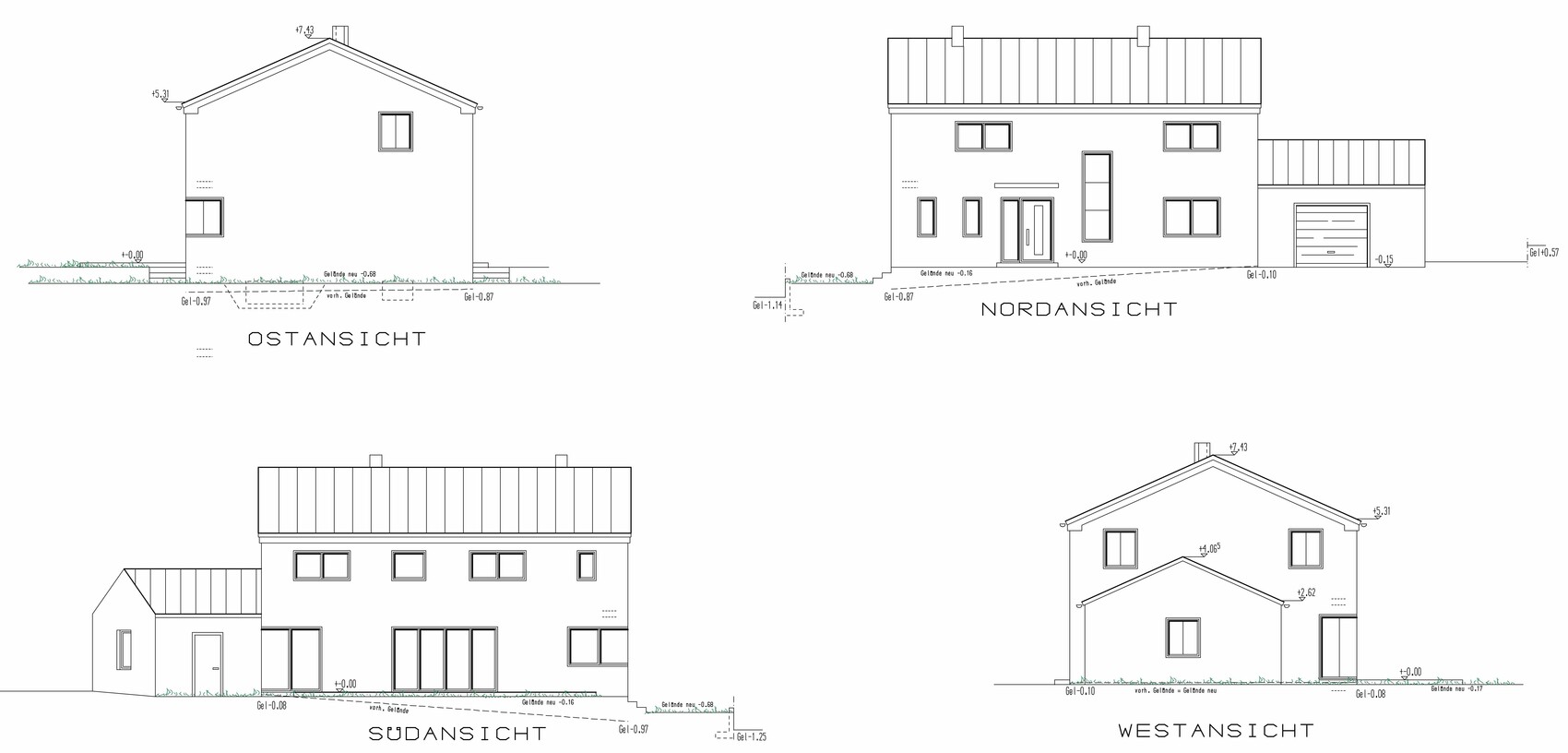

Four house elevations (east, north, south, west) of a two-story building.

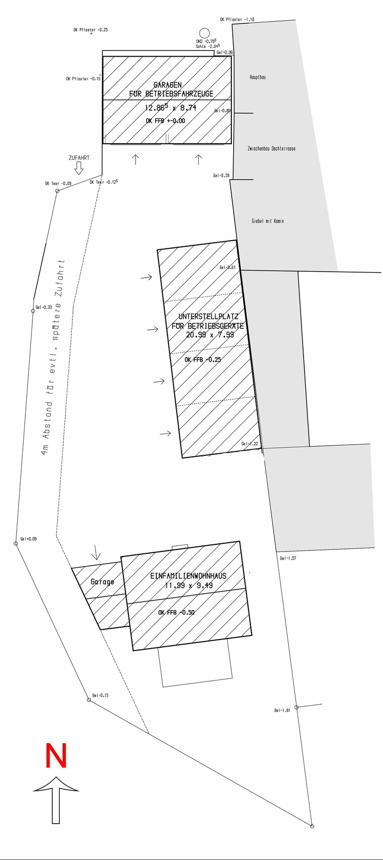

Site plan: garages for company vehicles, parking space, single-family house, driveway, north arrow.
