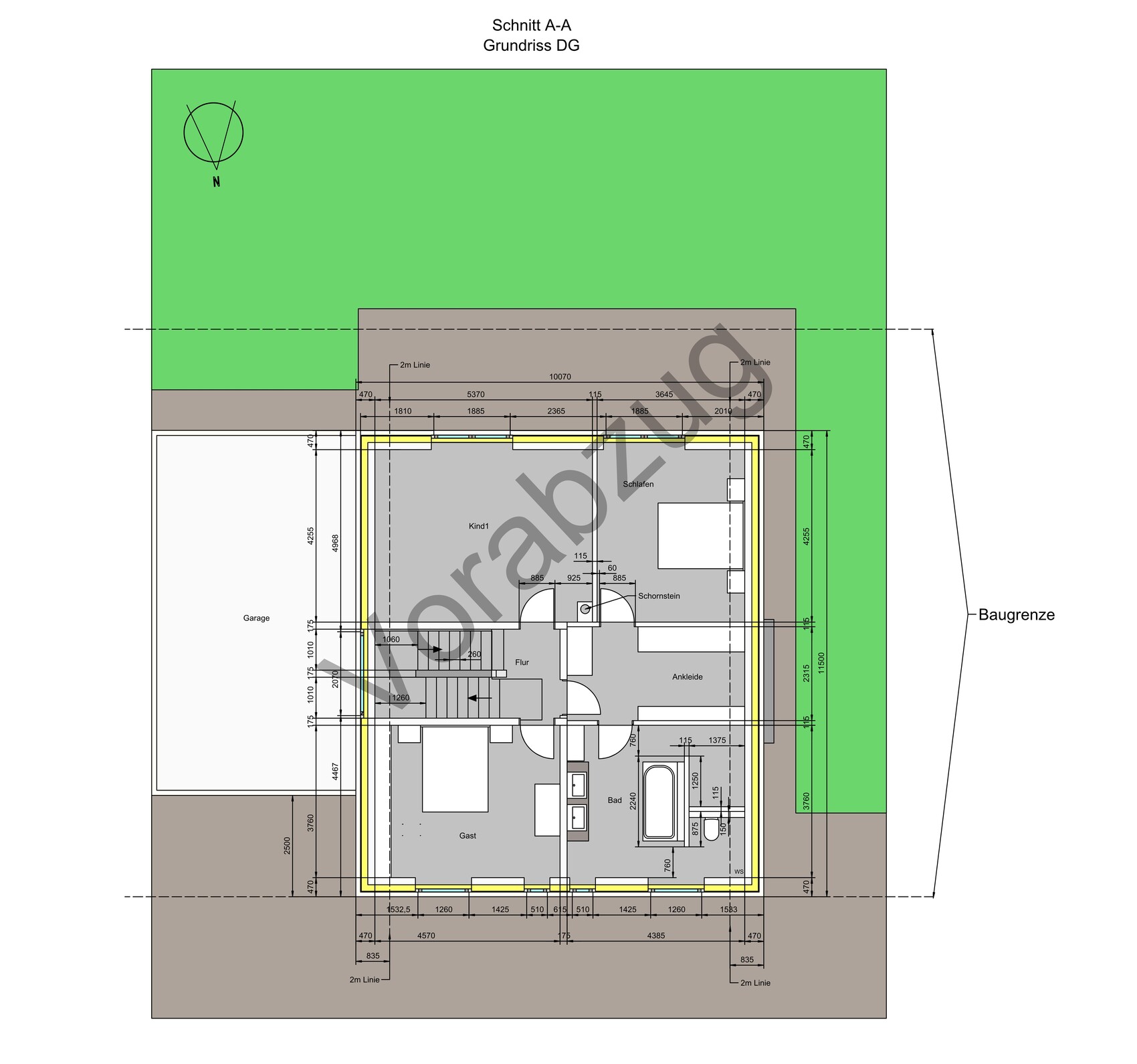

  • The steep roof with a low knee wall is unfavorable and is neither required by the building permit/planning permission nor by space needs. A better solution would be a (very) high knee wall with a 22-25° roof pitch, possibly constructed as an exposed rafter roof structure inside. This way, you avoid problems with sloping ceilings and can plan windows on the eaves sides.
  • The airlock/vestibule is, for the reasons mentioned by @ypg, not a good idea (even if you don’t want to hear it). If you don’t want to give up the idea, omit the garage door but design the exterior wall so that a side entrance door can be easily added later. If you still miss it in three years, you can retrofit the door (which you probably won’t do 🙂 ).
  • I would eliminate the small storage room next to the ground floor kitchen and instead extend the tall cabinets all the way to the west exterior wall. This provides nearly the same storage space but is much more accessible. You can also use deeper cabinets there (kitchen manufacturers offer such systems in my opinion).
  • The ground floor WC should logically be extended to the exterior wall, and possibly plan for a shower.
  • This allows you to shift the wall between the hallway and ground floor WC slightly to the right on the plan and install a larger front door with glass side panels to bring more light into the hallway.
  • On the upper floor, I would definitely move the wall between the hallway and dressing room/bedroom downwards on the plan to better suit the stairwell.
  • In this context, you could also shift the wall between the child’s room and bathroom downwards on the plan to ‘streamline’ the bathroom and give the child more space.
  • I would also relocate the door between the bedroom and dressing room upwards on the plan and eliminate the separate dressing room/bathroom access (quickly crossing the hallway once is really not a problem).
  • Please tidy up the doors from the hallway to the guest room/child’s room (currently too complicated).
Hello Hangman,
thank you for your feedback.
I will shortly upload an upper floor plan that we initially designed. It was quickly discarded because there was only a small window at the lower part, resulting in very little daylight in the dressing room. Due to the photovoltaic system, we did not want to include skylights or dormers there. I like the idea of a higher knee wall since it would allow for a taller window in the dressing room. What do you think of this floor plan?
Tomorrow I will try to redesign the ground floor according to your ideas and see how it looks.
I haven’t found many supporters for the garage door yet 😉 .
Maybe I will find a solution where the airlock can be realized separately from the office.

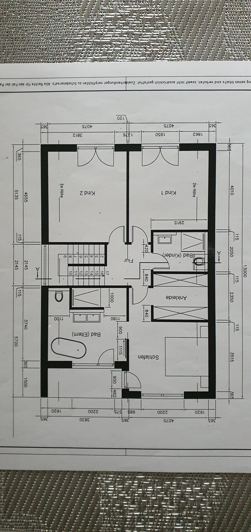

Do you work from home often, or is the office just a buffer room? If you regularly spend 8–10 hours a day in that "office," please do yourselves a favor and reconsider the layout. But if you just want to use the room for storing small items, I see it more as a vestibule or cloakroom, and then the door can of course stay.
I would arrange the upper floor differently. You don’t really need a large wardrobe room—since you’re planning a basement where winter clothes can be stored. I would not place the children's room directly next to the bedroom.
This is how we planned it...
