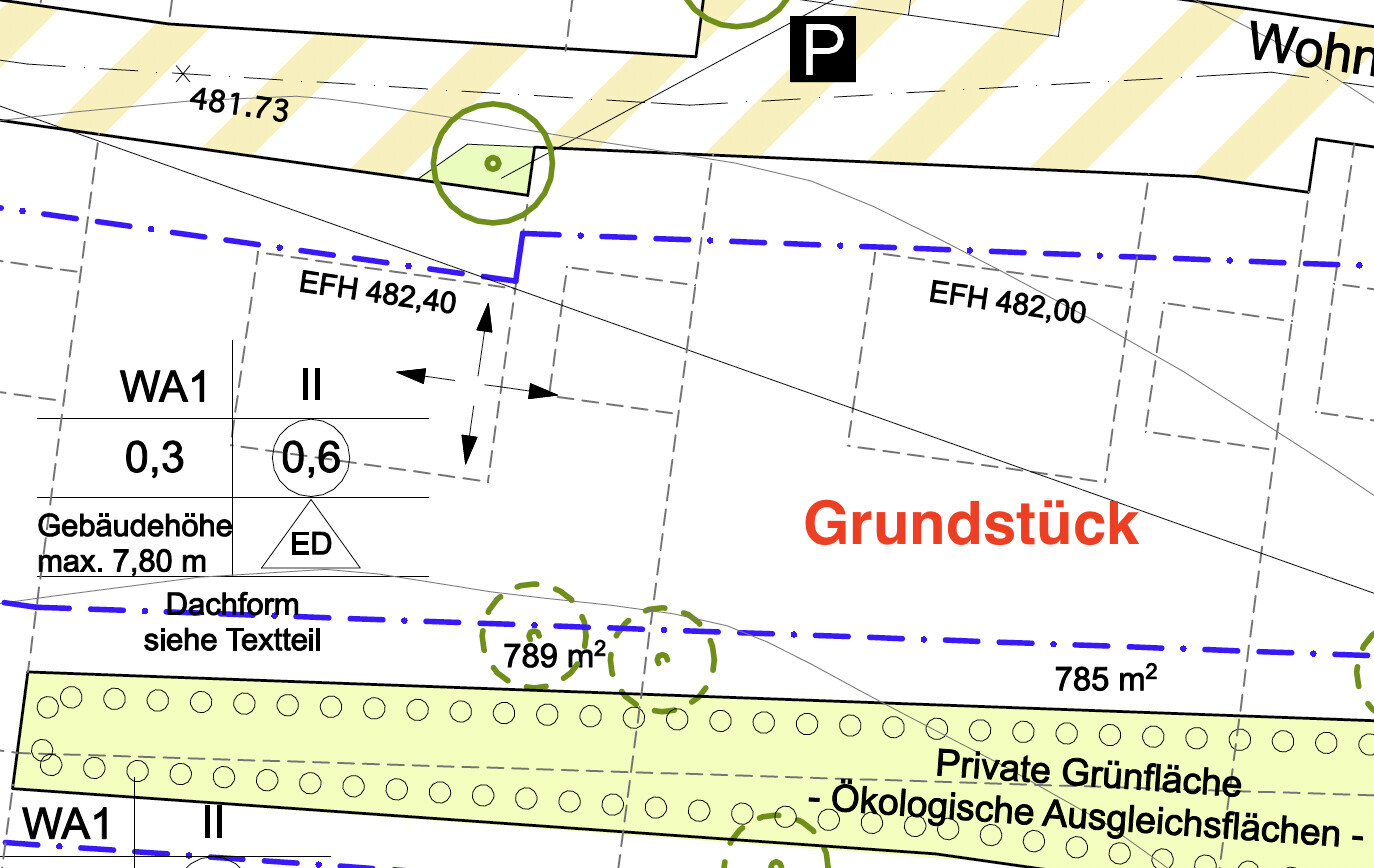

Plot size: 785 sqm
Slope: 7.1% (2.00m (6.6 ft) over 28m (92 ft) plot)
Site coverage ratio: 0.6
Floor area ratio: 0.3

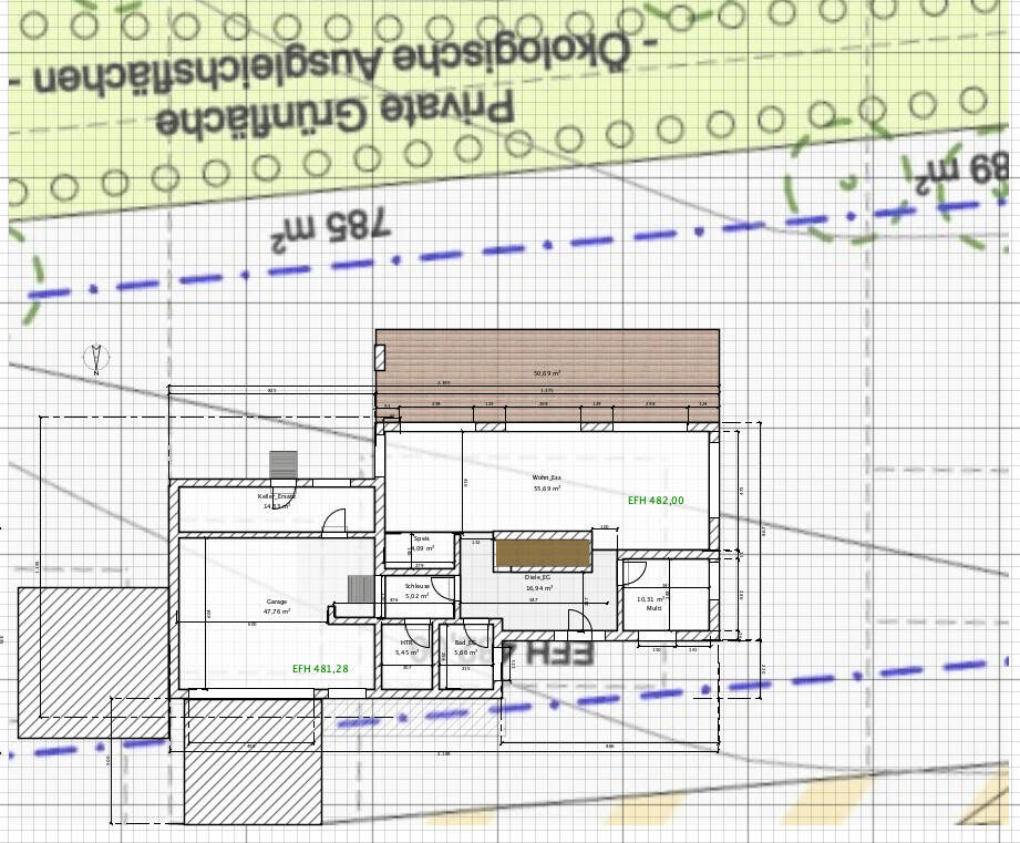

Building envelope, building line and boundary: see photo

Orientation: see photo

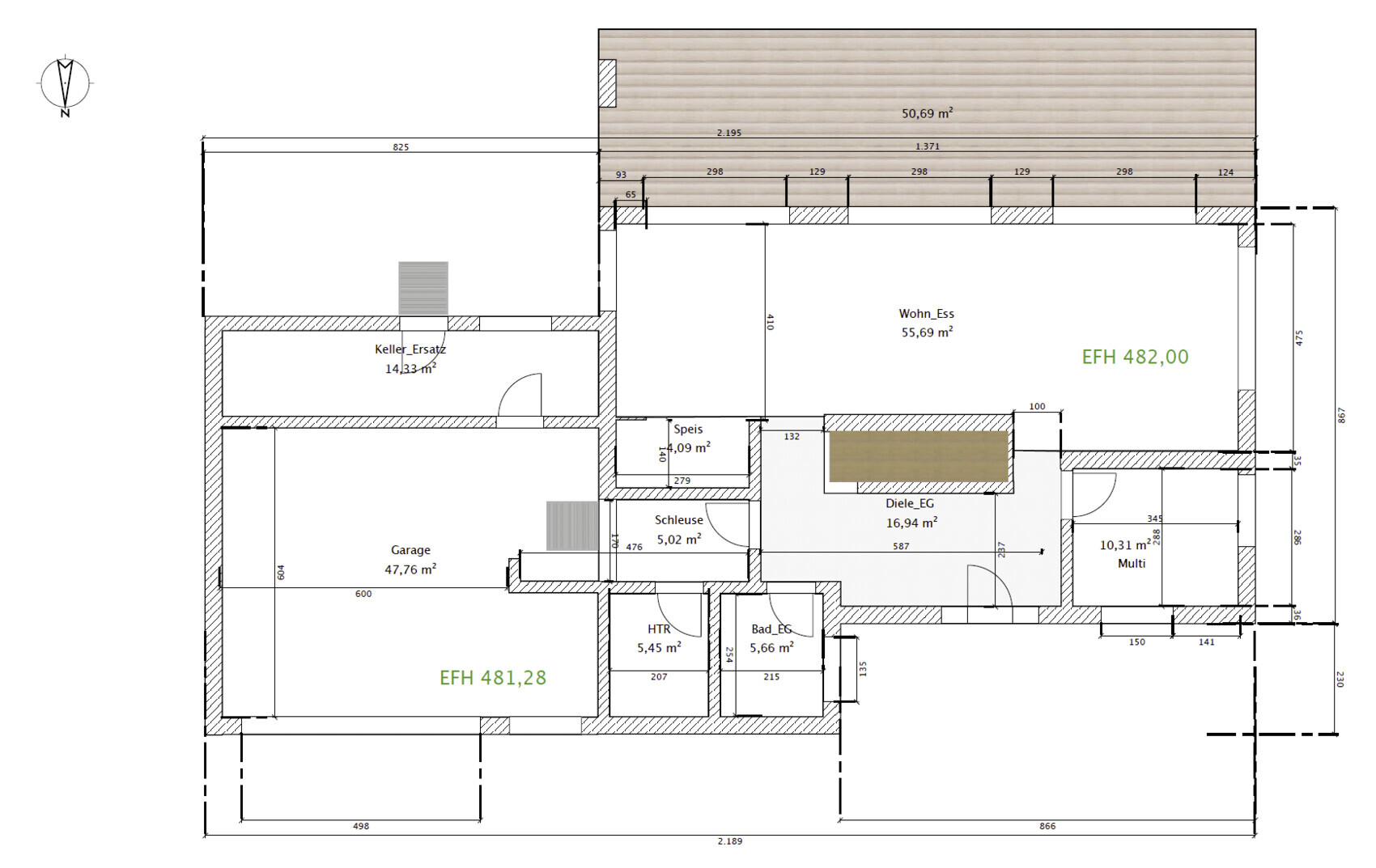

GF: living/dining/kitchen; study; shower/WC; utility room; basement substitute room; gallery

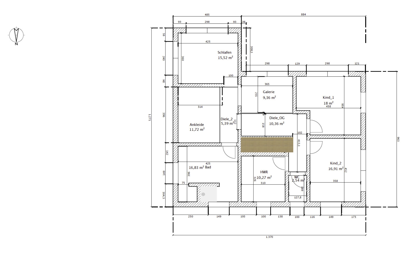

UF: master bedroom; child 1; child 2; walk-in closet with central block; bathroom; WC; laundry room

- Location on the plot and in relation to neighboring buildings
- South-facing garden + large exposed window front
- Arrangement of garage and house
- Cantilevered bedroom

- Transition to the garden
- Gallery

- Master bedroom with bathroom and walk-in closet

- Upper floor hallway is slightly large

- garage – airlock – kitchen
- laundry room near laundry source
- master suite including walk-in closet
- bike parking at entrance
- garden tools stored near place of use without garden shed
- split-level garage to comply with boundary building regulations

My spontaneous ideas based on the current floor plan... For example, you could:
- Convert the utility room and ground floor bathroom into a utility room of about 11sqm (118 sq ft)
- Use the utility room on the upper floor as a “children’s bathroom”
- Give up part of the 17sqm (183 sq ft) dressing room/hallway
- Convert the upper floor WC into a storage room for brooms, vacuum cleaner, etc.
- Reduce the size of the living/dining area so that an adjacent bathroom for the au pair / guest WC can be connected to the “multi-purpose” room
However, this would still not be ideal. I have the impression that the house was designed mainly around the “parents’ section.” Meanwhile, whether the layout is actually practical was neglected. Less is often more. Clear structures and fewer nooks and crannies (some of which are quite small rooms) would probably be better. On this footprint, it should definitely be possible to create a workable plan that meets your needs.

Just a few clarifying questions:
- Is the pantry not separated from the kitchen by a wall, but only by furniture?
- Is access to the open-plan living area generally without doors that can be closed?
- Is the staircase completely enclosed by walls on both sides, like a tunnel?
- What is the multi-purpose room intended for? An office?
- The bedroom faces south— is cooling planned for this room?
- The bedroom layout is unclear—please show a 2m (6.5 ft) wide bed with 70cm (28 inches) clearance on each side. Where is it supposed to be placed? Under or in front of the window?
- Dressing room without a window? Is the light supposed to come only from the gallery? That will be quite dark.
- Disproportion: 17m² (183 sq ft) master bathroom, 10m² (108 sq ft) utility room, 2.5m² (27 sq ft) WC for the kids. I’m sure there’s room to add a shower and a separate kids’ bathroom.
- Hopefully, the disadvantages of the open void above the staircase for children sleeping on the upper floor are known?
- The staircase exit width of 1m (3.3 ft) is very tight—you end up right in front of the child’s bedroom door. I wouldn’t want to have to fit a closet in the bedroom there.
Overall, a nice concept but not yet fully developed, in my opinion.
