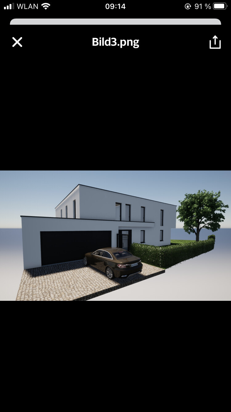

gutentag18 Apr 2022 22:42
Are there any finalized plans by now?
soneva2012
19 Apr 2022 07:37
gutentag schrieb:
Are there any final plans yet?
Yes, although the layout has not changed. The small windows (especially on the north side) are now different. These images are more or less final – with one large window on the south side instead of two.
Modern white villa with garage, paved driveway, dark brown car, hedge, and tree.
Modern white villa with large terrace, dining table, fire pit on the left, and garden.
