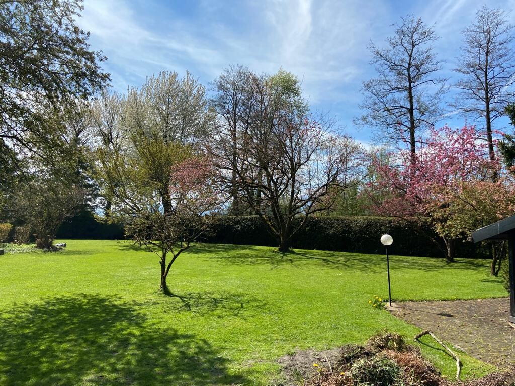

And here is a photo of the southern view that we really want to see from the bedrooms.Now be honest: if you already find bath time difficult with three children, when and how do you plan to enjoy the view from the bedroom? You don’t stand pressing your nose against the window or stay there on purpose just to look at a wallpaper. You quickly pass through the east-facing kitchen to make coffee and catch a glimpse of the scenery from there. Sleeping on the south side can also be quite uncomfortable.
