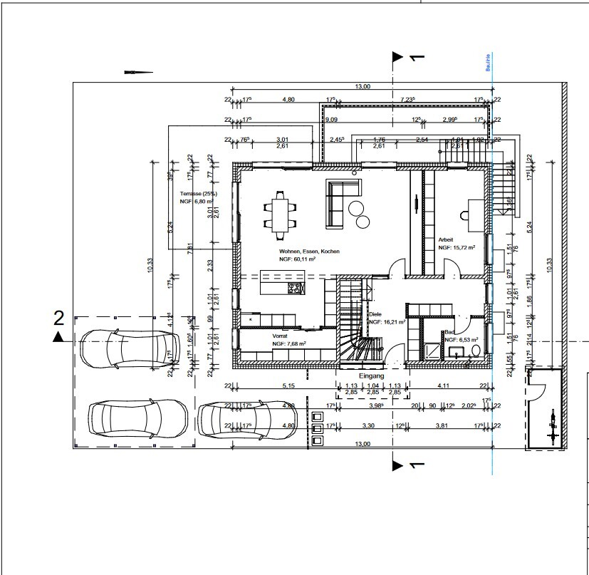

Ground floor:
Upper floor:

Option 1:
Ground floor:
- Bad: Kitchen too small, freestanding kitchen island measuring 2.35m x 1.1m (7.7 x 3.6 feet) does not fit, entrance to living area too narrow
- Good: spacious hallway, open staircase with landing
Upper floor:
- Bad: Access to children’s bathroom through utility room, entrance to master bedroom through dressing room, makeup table in master bedroom instead of dressing room
- Good: spacious master bathroom, size of utility room and children’s bathroom

K a t j a schrieb:
So option 2 is off the table due to lack of an office.
Regarding option 1 – given the requirements, I think it turned out quite well. Personally, I’m just not a big fan of the master bedroom area. First, I really don’t like sliding doors in the bathroom. You have to find one that seals completely tight, which is not easy. Also, from the bed you look directly into the walk-in closet, the door, that section of wall, and then to the right, the bathroom. It all feels very open, busy, and not cozy – it’s hard to really relax there. But other than that – why not? Yes, we also find the bedroom a bit restless because you enter the bathroom and walk-in closet directly from there. We’ll discuss this with the architect on Friday. Do you maybe have another idea on how to solve this differently?

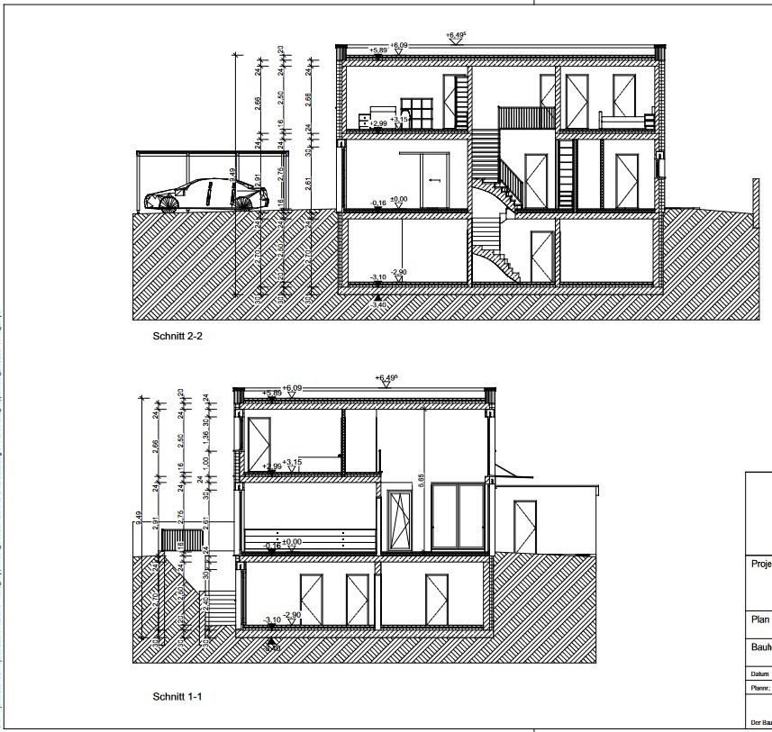

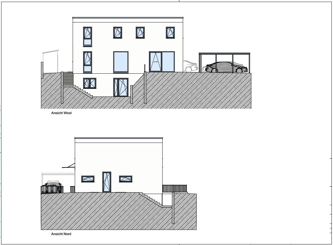

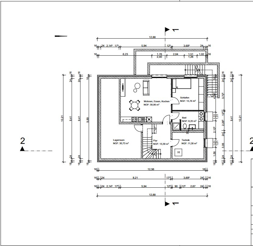

This is almost completely the opposite. Unfortunately, the original site is missing. Either the plot is as incredibly flat as shown, in which case the basement is an absolute luxury. Or the level ground still needs to be created (and it might be forgotten that moving earth with an excavator bucket also costs a bucket of money).
