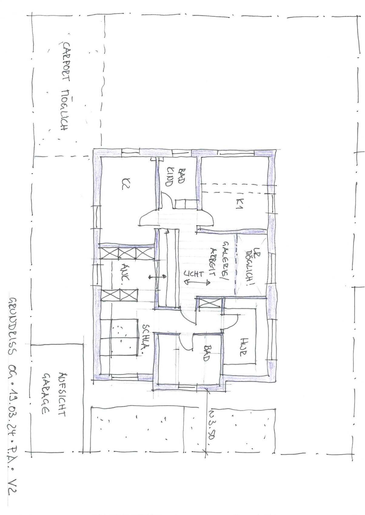

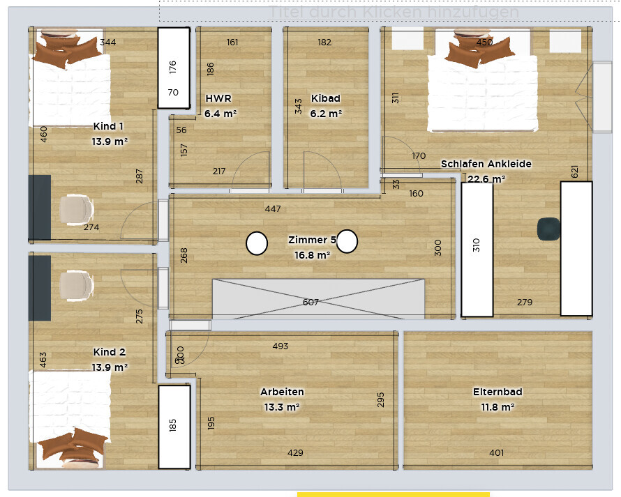

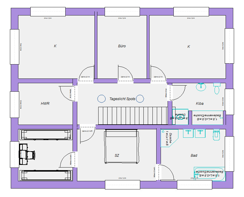

Dear forum,
The architect has been busy and sent us two different options for the upper floor. Both variants have their pros and cons. Variant 1 offers a brighter hallway and a better layout for the master bedroom area. Unfortunately, the office is somewhat smaller. In Variant 2, there is no separate office, and it would also be too noisy due to the open space above the kitchen. Additionally, the utility room is located in the master bedroom area.
We look forward to hearing your thoughts.
hanghaus2023 schrieb:
I would reduce the ceiling height by one step right away. This will ease the overall floor plan (budget). I really don’t like that the front door is placed so far back and the parking spaces so far forward.Thanks for the tip about reducing the ceiling height! The garage is planned to be at the back (right side of the plan). We also don’t like that the front door is at the back, but we wanted the living room to be at the front, not the entrance hall.Cubus3f schrieb:
We’re curious to hear what you think about it. So, option 2 is out due to lack of office space.
As for option 1 – I think it works quite well given the requirements. Personally, I’m not too fond of the master area. First, I find sliding doors in the bathroom really problematic. You need to find one that seals properly, which is not easy. Also, from the bed you look directly into the dressing room, then at the door, a bit of wall, and to the right is the bathroom. It all feels very open, chaotic, and uninviting – not relaxing at all. But other than that – why not?
