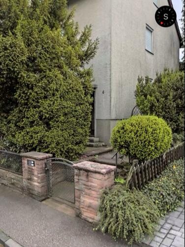

I still don’t know where the front door is planned. I would also be interested in some photos, especially of the outside and the staircase.So far, we’ve thought of keeping the front door where it is. Here’s a “photo” of the entrance from the outside. I don’t have any photos of the indoor staircase right now. I will take some next time I’m there.

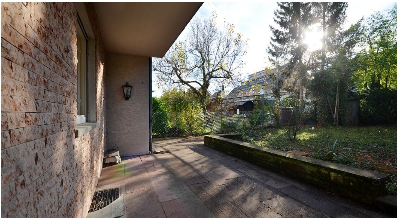

(How does the window there relate to the terrace?)The terrace door / exit from the dining room should not be a problem. The basement window has a light well.

You then have to go up a few more steps on the ground floor level inside the house, right?Yes, exactly. After the front door, there are still 6 steps leading up to the ground floor. At least the exit to the garden and the garden on the south side are level.
