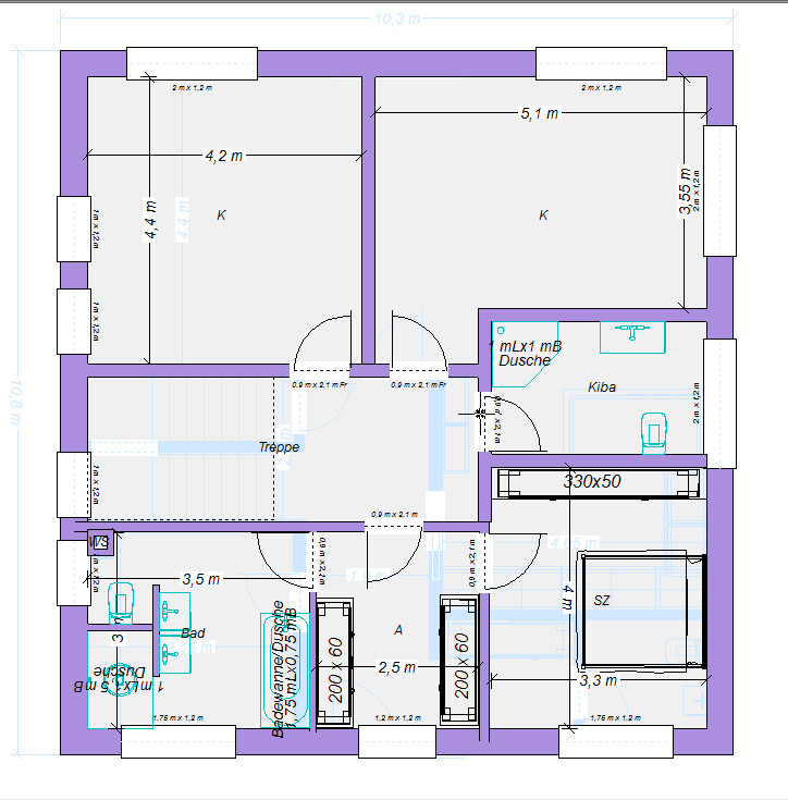

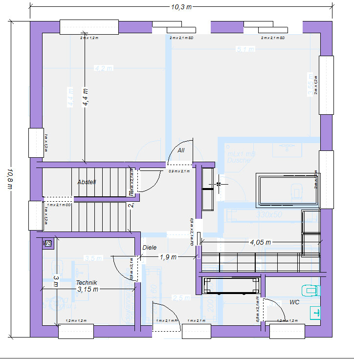

- Where could it still be optimized? Would you recommend different window dimensions or sill heights?
- What do you think is poor or what would you do differently?
- A partition wall will be added in the walk-in closet. That would theoretically allow watching TV from the bed. I am considering a lightweight wall. I plan to place a 211cm (83 inches) Pax combination wardrobe in the closet. The closet is planned with a raw width of 218cm (86 inches). Do you think 218cm is enough for the Pax once the walls are plastered, or how wide should the rough dimensions preferably be?
- Is the hallway on the ground floor too narrow?
- Would you raise the ground level? The house would be 40cm (16 inches) below street level. If I build a terrace into the garden, it would be about 1m (3 ft) difference. You could raise only the house level, resulting in approximately 1.6m (5 ft) difference between terrace and garden. I don’t know anyone living below street level. Raising the garden would probably not be allowed without permits, and affected neighbors likely wouldn’t agree. On the sides of the house adjacent to neighbors, raising is permitted only up to certain limits. I am overwhelmed with the decision.
- Do you have any ideas for arranging the sofa differently and placing the TV sensibly? My husband doesn’t want the sofa back facing a window. I still need to get used to placing the sofa in the middle of the room.
- Is the kitchen size sufficient for a nice kitchen with an island?
What do you think about the floor plans?
Shiny86 schrieb:
As parents, we should have the larger bathroom with a bathtub and two sinks, and the children should have only a small bathroom with a shower. ...
What do you think?Hallelujah! Better late than never:
Something like this:
Shiny86 schrieb:
How large is the children's bathroom approximately?In this case, 6.6 m² (71 ft²) – but you can work that out to the centimeter (inch) with your architect.Yes, we will discuss that.
Somehow it bothers me that the right child's room is no longer rectangular. Is that understandable? I’m quite a perfectionist.
What if we adjust the floor plan to 10.5 m x 11 m (34.4 ft x 36 ft)? Would it then be possible to keep the rooms rectangular? Maybe the living room width of 4.5 m (14.8 ft) can also be maintained.
Isn’t it rectangular?! You mean square? You need to move away from focusing on the lines on the paper and start imagining the rooms mentally. A square room might seem nice at first, but it’s actually harder to furnish than a rectangular one. The rooms shown are basically the same size, each over 18m² (190 sq ft). Both have good room depths, are not narrow corridors, and have natural light from two sides. I think that’s a luxury for children and I’m really happy for the two of them. There’s no need to “butcher” the other rooms because of this.
If you want to try it out yourself with the centimeters, just get a software program. I believe there are even free ones – but don’t ask me which.
Yes, Katja is right. A square room is not easier to furnish than a rectangular one, since a lot of unusable space remains in the middle. Everything fits well in your case. It’s not a narrow or elongated space. We have a narrow layout with three children's bedrooms on a smaller area. Three rooms of 5m² (54ft²) each (though with lofts above them of 7m² (75ft²))—and that’s really a bit inconvenient, but it couldn’t be avoided because we wanted all rooms, including the master bedroom with balcony access, to face south. I would probably do it differently now. Our house is over 14 meters (46ft) wide and only 8 meters (26ft) deep.
So, I wouldn’t change the dimensions. I really like Katja’s suggestion. For me, almost everything fits perfectly.
