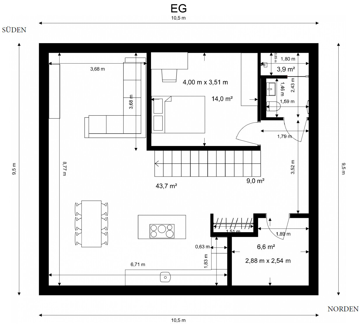

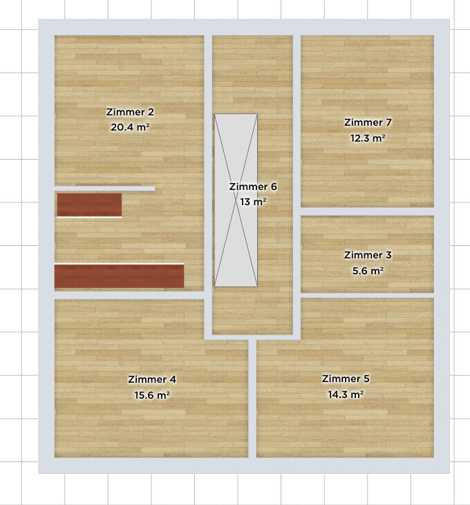

a new update from our side: since the "large" version (11 x 9.5 m (36 x 31 feet)) exceeds the budget, we want to take a middle-ground approach. I have therefore drafted floor plan designs based on a footprint of 9.5 m x 10.5 m (31 x 34 feet).
The staircase is now 4 m (13 feet) long and 1 m (3 feet) wide. Otherwise, everything should be fine for a preliminary sketch. What do you think? Despite your feedback, I would like to send this to the architect as it is, since it ultimately builds on their design with slight adjustments. In particular, the assessment of the structural engineering / feasibility would still be important from the company.

Why does the guest room need to be relatively large? The living room already feels a bit cramped to me.
A wardrobe for four people seems very questionable. I would place a walk-in closet in the bedroom as a sound barrier to the children’s room.

We would adjust the living room wall at the top of the plan back to 4m (13 feet), as it was before. That way, the guest room/office still has 13 sqm (140 sq ft), which is sufficient.
Could you please provide me with a sketch of your bedroom?
7 Jun 2024 17:17
K a t j a schrieb:
Why does the guest room have to be relatively large? The living room already feels a bit cramped to me.

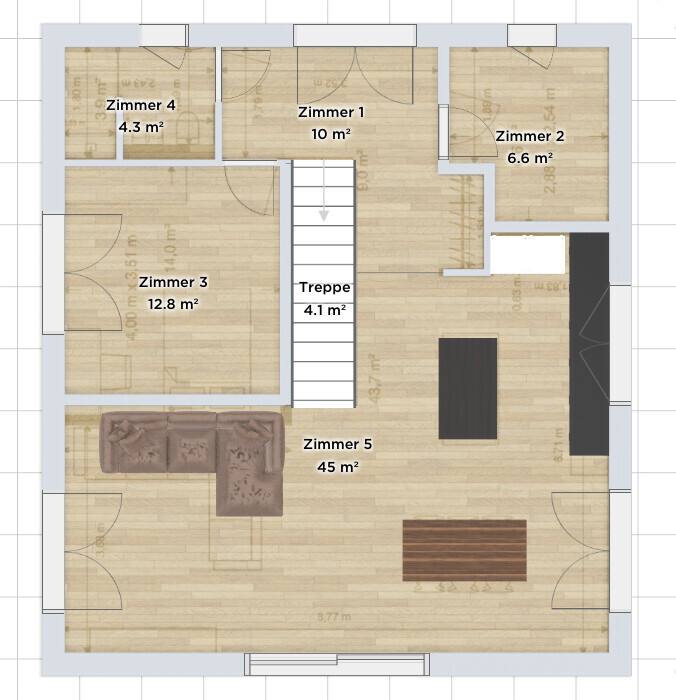

Widened to 4 meters (13 feet):
Floor plan of an upper floor with rooms, stairs, living room, and dining area
LeFy2023 schrieb:
Could you please show me a sketch of your bedroom?
This is what she means:
Floor plan with six rooms (2,3,4,5,6,7) and wooden flooring; red furniture in room 2.
K a t j a schrieb:
A wardrobe for 4 people is highly questionable.
I see the problem that, due to the lack of separation, the "kitchen" has to serve as a cloakroom, meaning a cabinet or dresser is placed under the stairs, so it’s quite practical to put your hat etc. on the island.
However, one doesn’t work without the other, namely the intended line of sight.
Is the orientation with the north and south indications correct? I’m a bit confused. I wouldn’t put the guest room in the southwest. Actually, the design should be mirrored.
