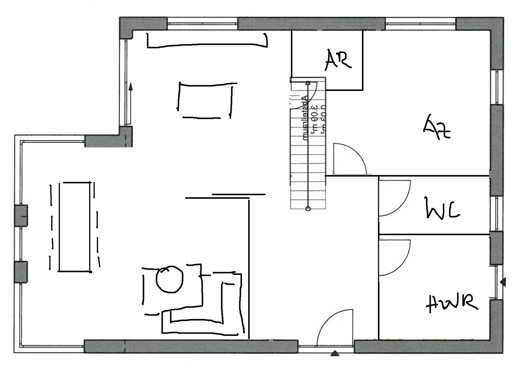

We have reserved a plot of land and are now planning together with our preferred building company. We have not signed anything yet, but the planning is already quite advanced, as are the discussions with the bank regarding financing. Since a further phase will follow after the initial plan and signing, during which detailed planning will take place together with an architect from the company, I would appreciate any feedback that we could still take into account.
Thank you very much.

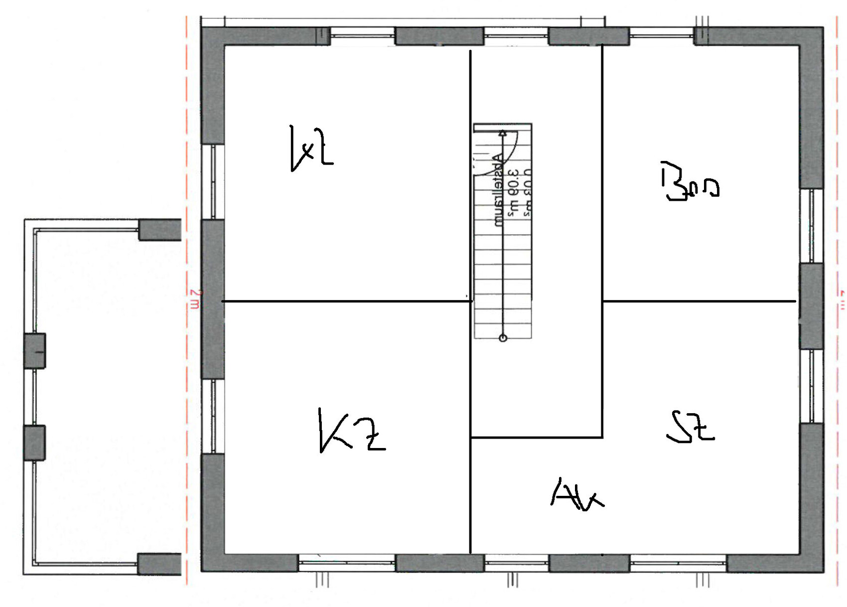

- Upper floor requirements: 2 children's bedrooms, bathroom, master bedroom

- Is the dining/living area sufficient for a large dining table (in front of the windows) and a couch, etc. in the niche on the right by the hallway wall?
- General feedback on the room layout
- Can the staircase be better positioned, or would a different staircase be more suitable?

- Positioning of shower, etc. in the upper floor bathroom will not remain as shown

We have now signed the contract and are waiting for appointments with the architect to start the detailed planning.
In advance, we have already clarified that the staircase can be rotated. The idea is attached.
Furthermore, there is a tendency to switch to a shed roof. We didn’t like this style at first, but now we are really excited about it.

Furthermore, there is a trend to switch to a single-pitch roof. Where exactly would the high side be then? Does that mean the knee wall reduction is off the table again?
nadori schrieb:
We had already agreed in advance that the staircase can be rotated. You’ll find the idea attached. Overall, I think this is a better solution. However, I believe the staircase could be a bit longer than you have drawn. Railings on both sides—hmm—that can quickly create narrow corridors that weren’t expected with such a central hallway layout.
