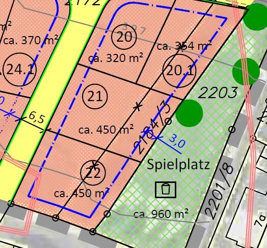

hanghaus202321 Apr 2024 19:49Do you prefer a terrace on the west side while your plot faces east?
hanghaus2023 schrieb:
You prefer a terrace facing west, but your plot is oriented toward the east?
You are working with the initial draft of the development plan. During the site preparation, the plan was revised and the plots were reduced in size. In principle, the plot shown in your image and the one below it (plot no. 22) would be suitable. A terrace facing west would indeed be nice.H
hanghaus202321 Apr 2024 20:10Please share the selected plot. Your plan does not fit the #22. I don’t have time right now to look for the new zoning plan.
Please upload the selected plot. Your plan does not fit on lot #22. I don’t have time right now to look up the new zoning plan.We have planned the basic layout and floor plan for plot no. 21 or alternatively no. 22 (both 450 sqm (4,844 sq ft), similar shape).

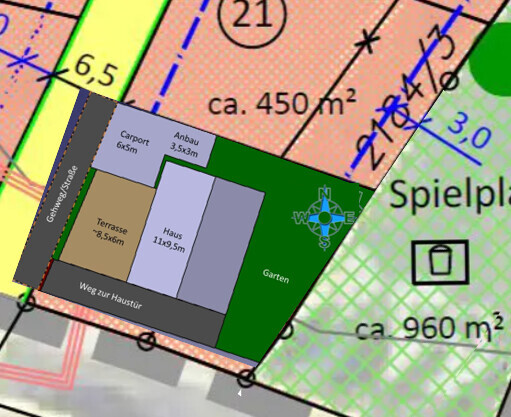

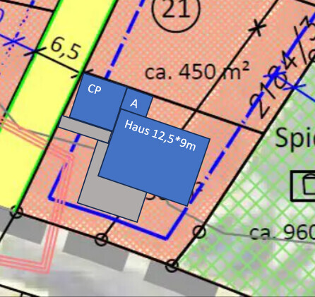

Allthewayup21 Apr 2024 22:28You already mentioned that the design is your own work, and you can see that in every detail. In my opinion, orienting the terrace toward the street is one of the biggest mistakes. I would also always position the front door as close as possible to the driveway or street so you don’t have to walk 15 meters (50 feet) to reach it. Since the plot allows it, I would use the 11 meters (36 feet) in an east/west orientation to get more “southern sunlight” inside the house, which is especially beneficial on sunny winter days. Of course, this requires some sun protection in the summer. The guest bathroom could be smaller, even with a shower. We managed easily with 6.5 square meters (70 square feet). I also find the kitchen and dining area somewhat impractical. Try drawing the furniture to scale along with the sanitary fixtures—that often helps clarify things and can reveal better solutions here and there.
