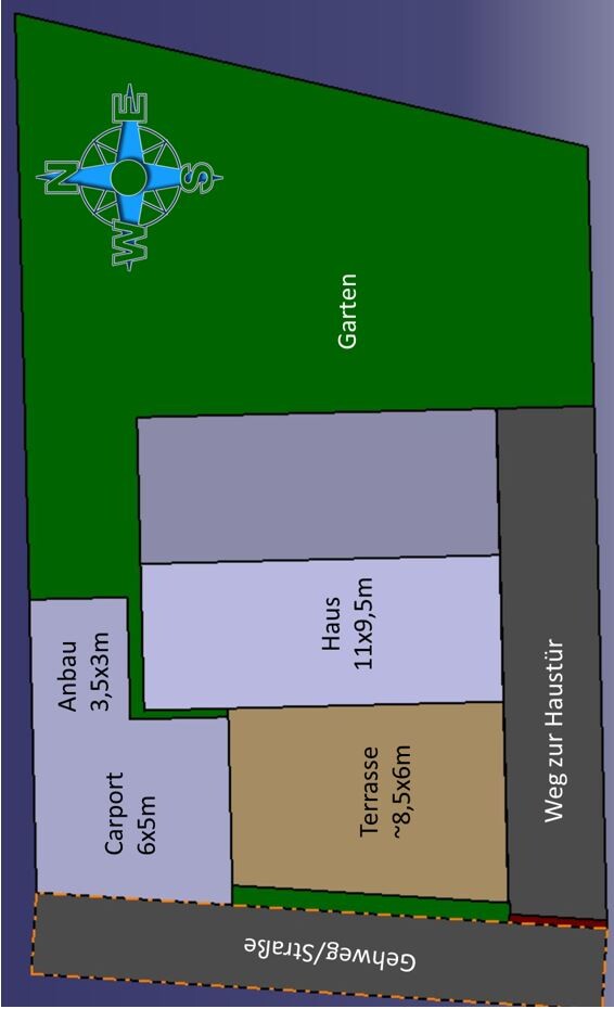

Plot overview:

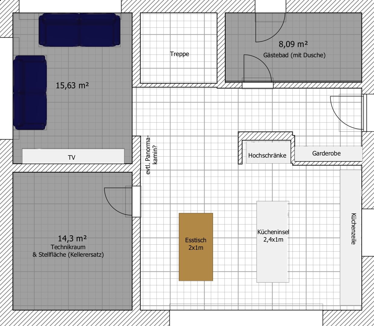

Ground floor:

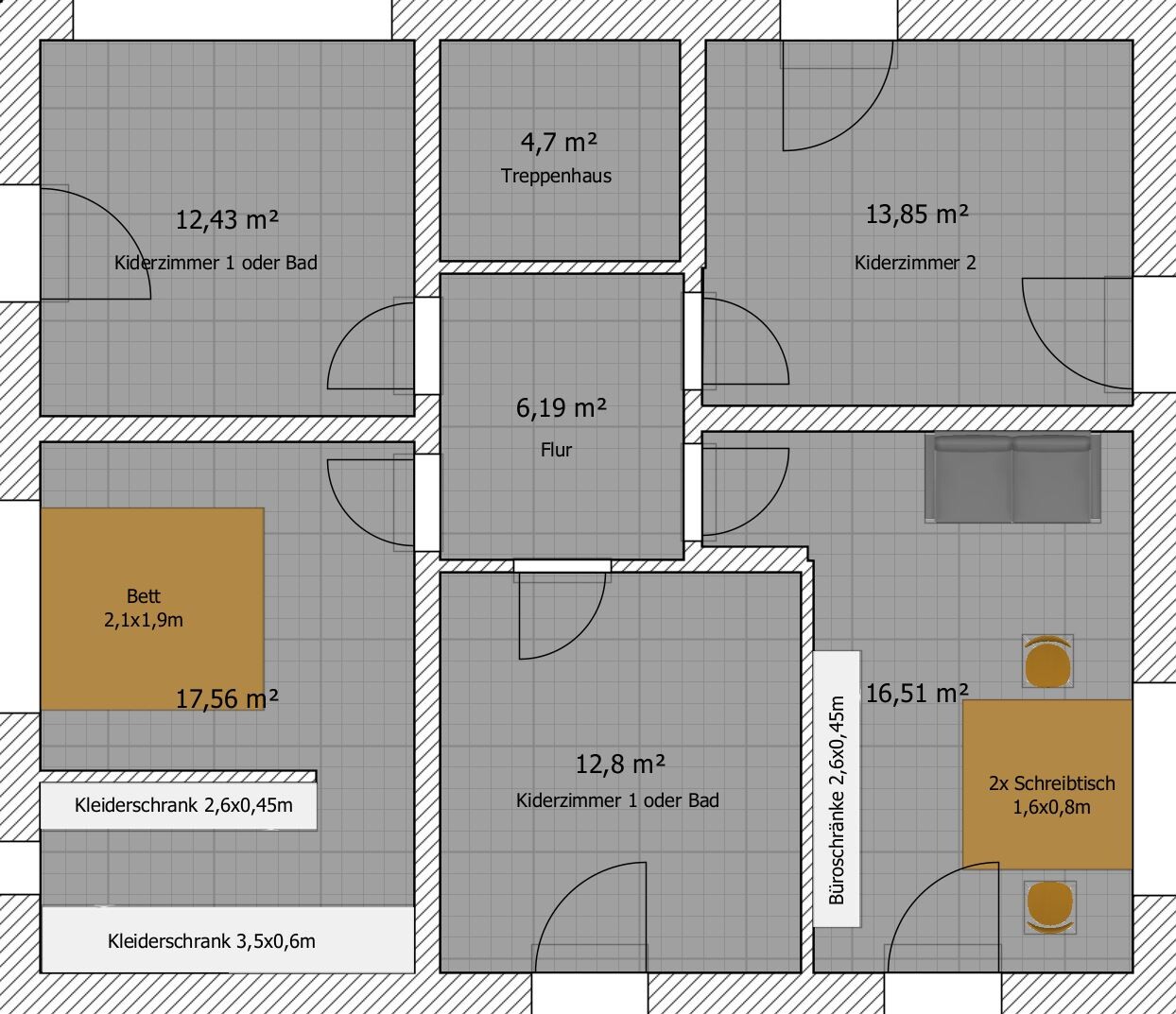

Upper floor:

hanghaus202321 Apr 2024 12:07Is there no local development plan?
Dimensions of the plot?
hanghaus2023 schrieb:
Is there no zoning plan?
Dimensions of the plot?There is a zoning plan. I have included the requested points from it above, and I can provide more information if needed. What exactly is missing?The plot measures approximately 18 x 25 m (59 x 82 feet), but it is not perfectly square, as shown in the plot overview image.
hanghaus202321 Apr 2024 12:43Since you don’t know what to focus on, it’s better to show the plan. No link.
Bau_BAY schrieb:
What exactly is missing? The plan with the building envelope and the surrounding area. One wonders why everything is pushed forward, as if there were a plague in the east, or a nuclear power plant or landfill site.
Bau_BAY schrieb:
Floor area ratio: 0.4 Out of 450 m² (4844 ft²), that equals 190 m² (2045 ft²). But in your case, it turned out to be a bit more.
