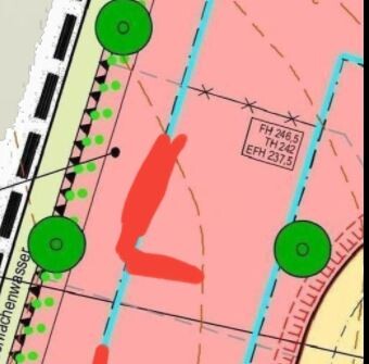

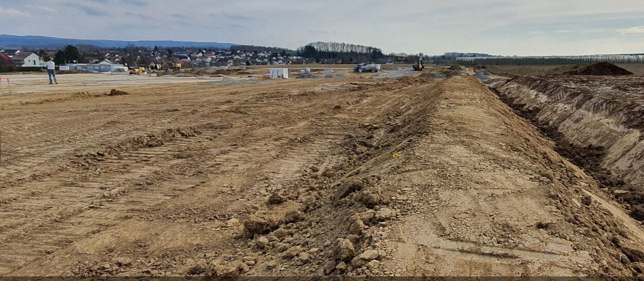

Kati.com schrieb:
So, I wanted to build the house at the retaining wall height so that the garden, which is already small, doesn’t get any smaller.
Um... do you want to raise the entire plot to that height (have you already calculated the costs for that?), or what is the purpose of raising the house?
11ant11 Jun 2021 01:02
kbt09 schrieb:
Um... do you want to raise the entire plot to this height (have you already estimated the costs?) or what is the purpose of raising the house?
Kati.com schrieb:
The problem is that there is a small earth embankment (about 60cm (24 inches)) along the western property boundary. We want to raise the whole house a bit so that we can level out this embankment. The maximum single-family house height is 1m (39 inches) above street level. We wouldn’t want to go that high, but as mentioned, around 50-60cm (20-24 inches).
I think the "problem" is that the original poster is imagining a much bigger issue than it really is and fears ending up in what feels like a basement behind the small embankment and dying from lack of light (or at least losing the distant view because of it). Unfortunately, neither facts nor technical measures help against such fears—both are treatments that don’t really address these concerns.

hanghaus2000
11 Jun 2021 08:05
I found the picture.
Large construction site: earth embankment, trench, construction vehicles; houses in the background.
It can really be disregarded. The slope of 1 meter (3.3 feet) on the property is also negligible.

hanghaus2000
11 Jun 2021 08:27
I would position the single-family house 0.25 m (10 inches) above street level, with a slight slope towards the street.
Approximately a total height of 5.20 m (17 feet), allowing for almost two full stories.
The slight offset of the ceiling towards the garage can be resolved, even with a wall height of 3 m (10 feet) for the garage.
Is there a street height reference point?
Has the plot already been surveyed for elevation?
