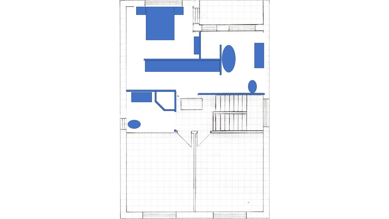

We are (almost) ready. The desired building plot is reserved, and the house planning can begin.
We will be building with a (related) architect and will tender all trades ourselves. We are aware that this approach involves significant time and financial risks, but we want to take the chance.
It is meant to be our dream house, and we want to be able to decide ourselves how it will look.
Our architect suggested that we first draw our own ideas of how we imagine the house and what is important to us. Afterwards, we will sit down together and analyze the plan step by step.
After days of drawing, I have “designed” a floor plan that our whole family is quite satisfied with.
Here are some details:

What do you especially like? Why? Office and WC with the possibility to convert them into a separate living unit (for old age), kitchen island in the middle of the room, back kitchen so appliances don’t have to be on the island, large windows on the undeveloped side, stairs in the living room instead of in a hallway, large master area on the upper floor.
What do you dislike? Why? No double garage due to space constraints. We don’t want to shift the house too far south.
Cost estimate by architect/planner: ???
Personal price limit for the house including fixtures: 600,000
Preferred heating technology: air-to-water heat pump (deep drilling is not allowed due to water protection zone)
If you have to give up certain details/features:
- Can give up: slightly smaller office. However, I like the option of converting the office and WC into a second living unit (for grown children, caregiver, bedroom in old age).
- Cannot give up: open kitchen, back kitchen, large windows to the southwest
Why does the design look the way it does?
I created the design completely independently. A modern, open style is important to us. Since there is an unobstructed view to the west of fields and vineyards, we want to make use of this with large windows.
A separate master area would be very welcome. A luxury bathroom as in this plan would, of course, be a highlight.
An attic is planned for additional storage space.
I am quite concerned about the single garage. We need two cars, and the second would always have to be parked outside. Unfortunately, I don’t see a possibility to position the garage differently. If I reserve the minimum 6m (20 feet) on the northern boundary for a double garage, the house would have to move further south. I do not want that.
I look forward to your suggestions.

Tolentino schrieb:
A sliding door usually provides poorer sound insulation, which is typically a key requirement for a door in a bedroom. Maybe add an extra door to the actual sleeping area (opening inward)? That way you would have a) sound insulation towards the outside, b) sound insulation within the parents’ area in case of different daily schedules, and c) children who feel claustrophobic could use the parents’ bathroom without having to lie half in the bed.
Alessandro9 Sep 2021 13:05Tolentino schrieb:
A sliding door usually provides less sound insulation, Thanks for the tip. I hadn’t considered that.
I share that concern. However, the door is drawn running in front of the wall and would effectively reduce the usable stair width at the exit. That was just my internal drawing. The sliding door would be fully recessed into the wall.
Myrna_Loy schrieb:
I always wonder why people plan a children’s bathroom and then keep it as tiny as a guest bathroom at only 3.5 sqm (38 sq ft), while they build themselves a 9 sqm (97 sq ft) spa. Do you all think the bathroom is really that small? It’s just meant for showering and brushing teeth in the morning and before bed—so we don’t get in each other’s way. The large master bathroom is, of course, accessible to everyone and not just reserved for the parents.
Myrna_Loy schrieb:
I would keep the entrance facing forward as closed as possible and instead plan a large glass area towards the terrace. For anyone entering, the effect is almost the same, but you still maintain privacy. If I close it off, it will get dark. Half of the window will be operable. This way, the children’s friends can enter the garden directly from the street without having to go through the living room.
Kati.com schrieb:
The large master bathroom is, of course, open to everyone and not reserved just for the parents.However, I would think carefully about the access situation; as shown here (and also in the nice design by @Alessandro), it would feel far too little privacy for me.M
Myrna_Loy9 Sep 2021 17:50Master bathroom 😱 Please, please not.
