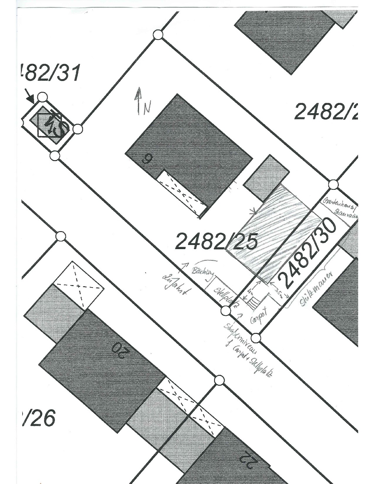

On the site plan, you see the entire property outlined in yellow, including the existing buildings. It consists of two cadastral parcels.

Is there perhaps a sketch showing the overall plot with the planned house, parking spaces, and southeast terrace?
Could the house maybe be set back a bit further?

First of all: Attached is the site plan with the house and parking spaces sketched in. You can see the driveway in one of the photos. This means that the terrace facing the street will be bordered on one side by a slope and on the street side by a parking space. Behind the parking space, a hedge will be planted for privacy; overall, this will result in the smaller terrace.
Moving the house further back: yes, our architect is trying to get this approved by the building authority (building permit / planning permission). For now, we have to assume the current placement. Moving it further back would be great in one way, but it also means that the entrance door would have to be shifted because the garage (existing structure) extends further forward into the house. This would make the entrance area darker. That’s why I’m not fully convinced about moving the house 2m (6.5 ft) back. 1m (3 ft) might make sense (though the line, the front door and passage to the living area would also have to be sacrificed, which I actually like architecturally because it’s very linear), but 2m (6.5 ft) would make the entrance area too dark for me…

I also noticed the house shift, of course..
