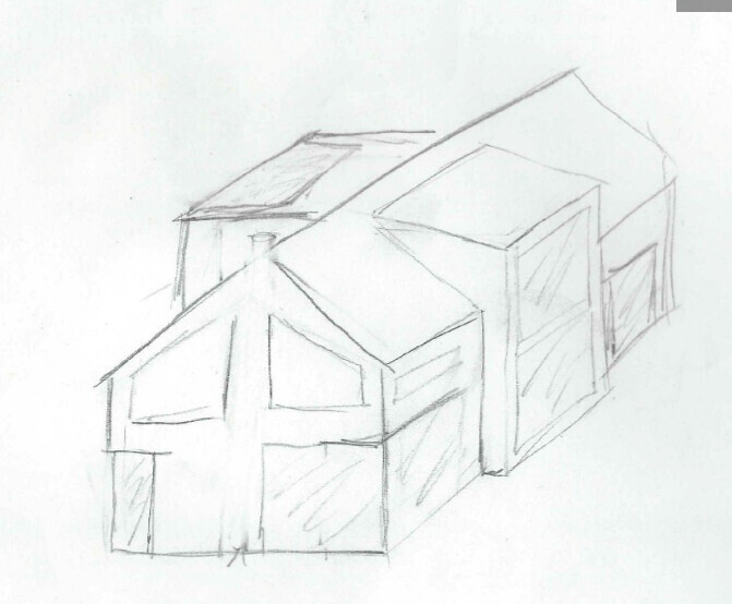

My partner and I had already developed a fairly precise layout concept; but the new architect didn’t want to look at it. He asked us what our must-haves were, what was necessary, what would be nice, and what could be, and then took a look at the site.
A few weeks later, he presented his layout – and, surprise! – it was very similar to ours! A great idea from him was to share my mother’s driveway, which reduces traffic paths on the property. We hadn’t thought of that, of course, and it’s fantastic!
Basically, he mirrored our design 180°, added an open space (which I had marked as a nice-to-have) above the dining area, and now we are in the concept planning phase.
Before submitting another (possibly unsuccessful) preliminary application, our new architect will work closely with the planning office in advance, so things like setback distances will be settled prior to submission.
So I can’t say anything final yet about the knee wall height we will achieve, nor which roof style it will ultimately be (the planning office currently wants a 31° gable roof, but we would prefer a flat or shed roof – so we still have to find a compromise *smile*).
But we are allowed to build there, and the setback distances are mostly fixed (the architect thinks we can move the house a bit further back, let’s see... I’m not fully convinced yet, but that would be great).

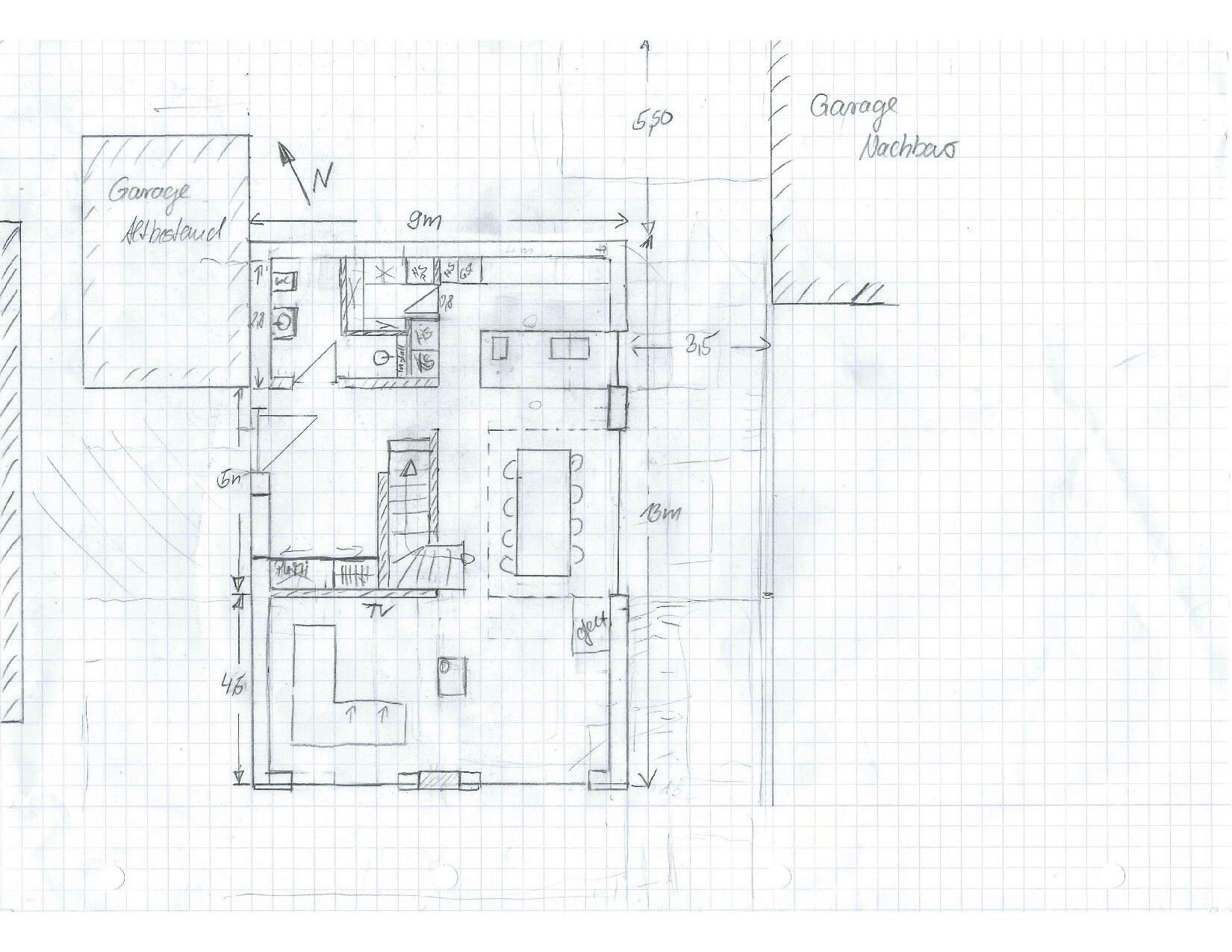

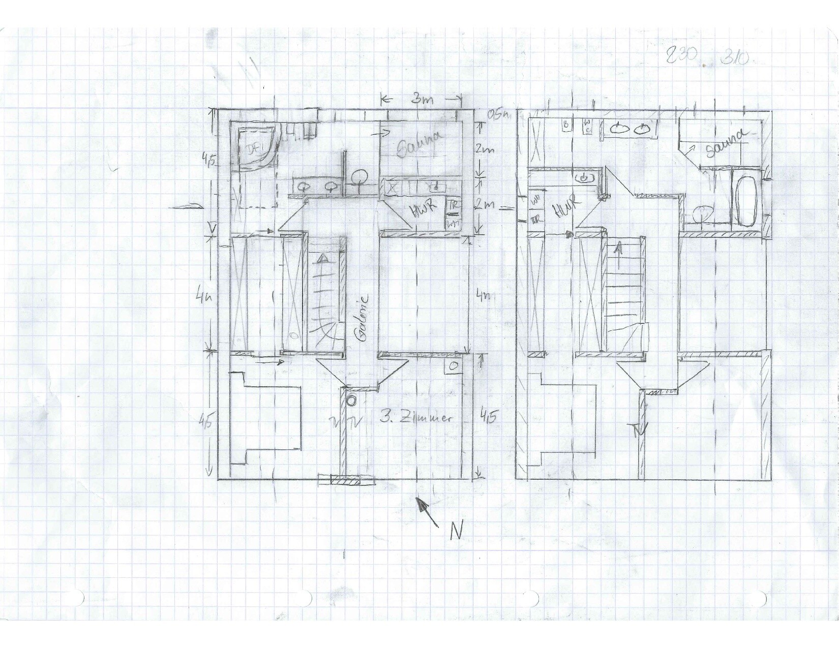

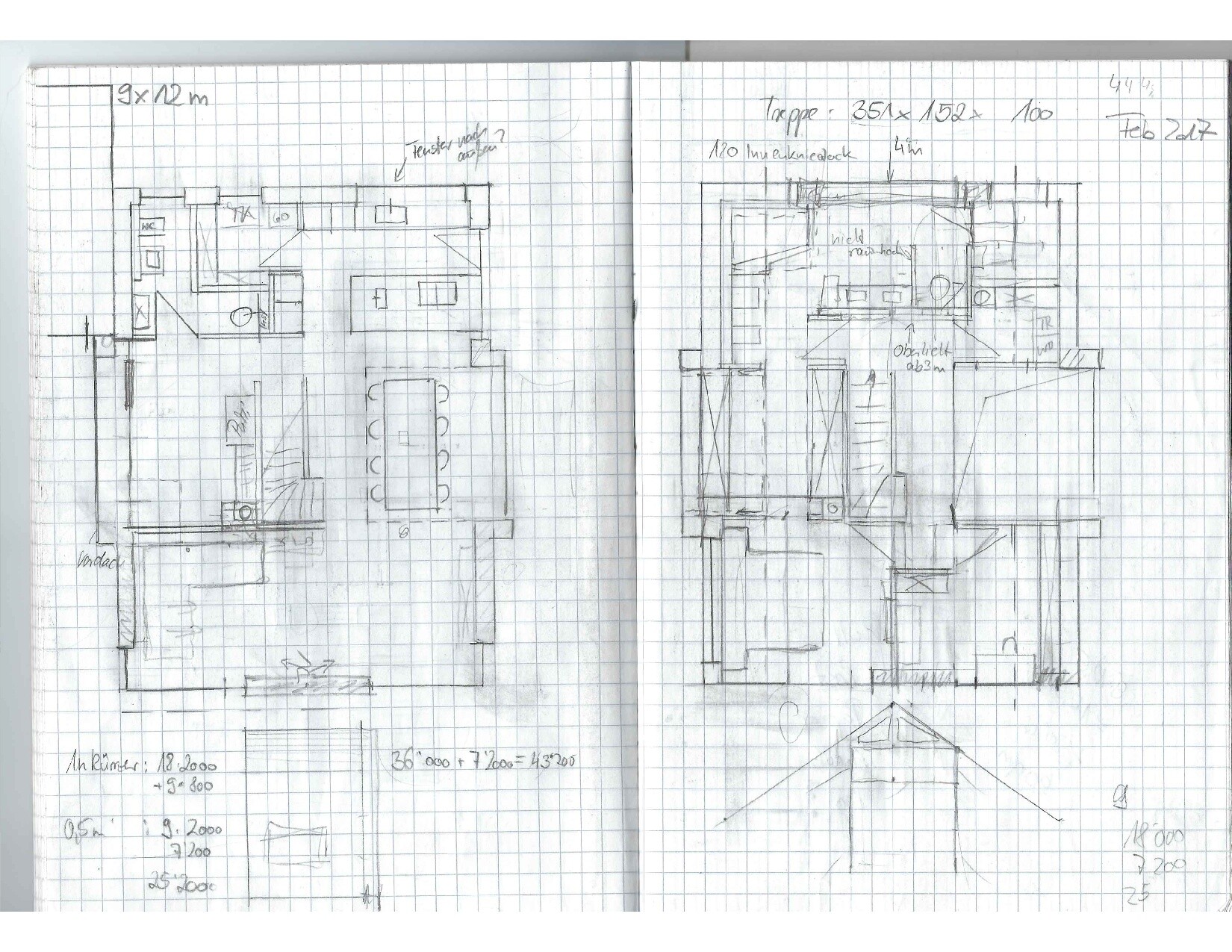

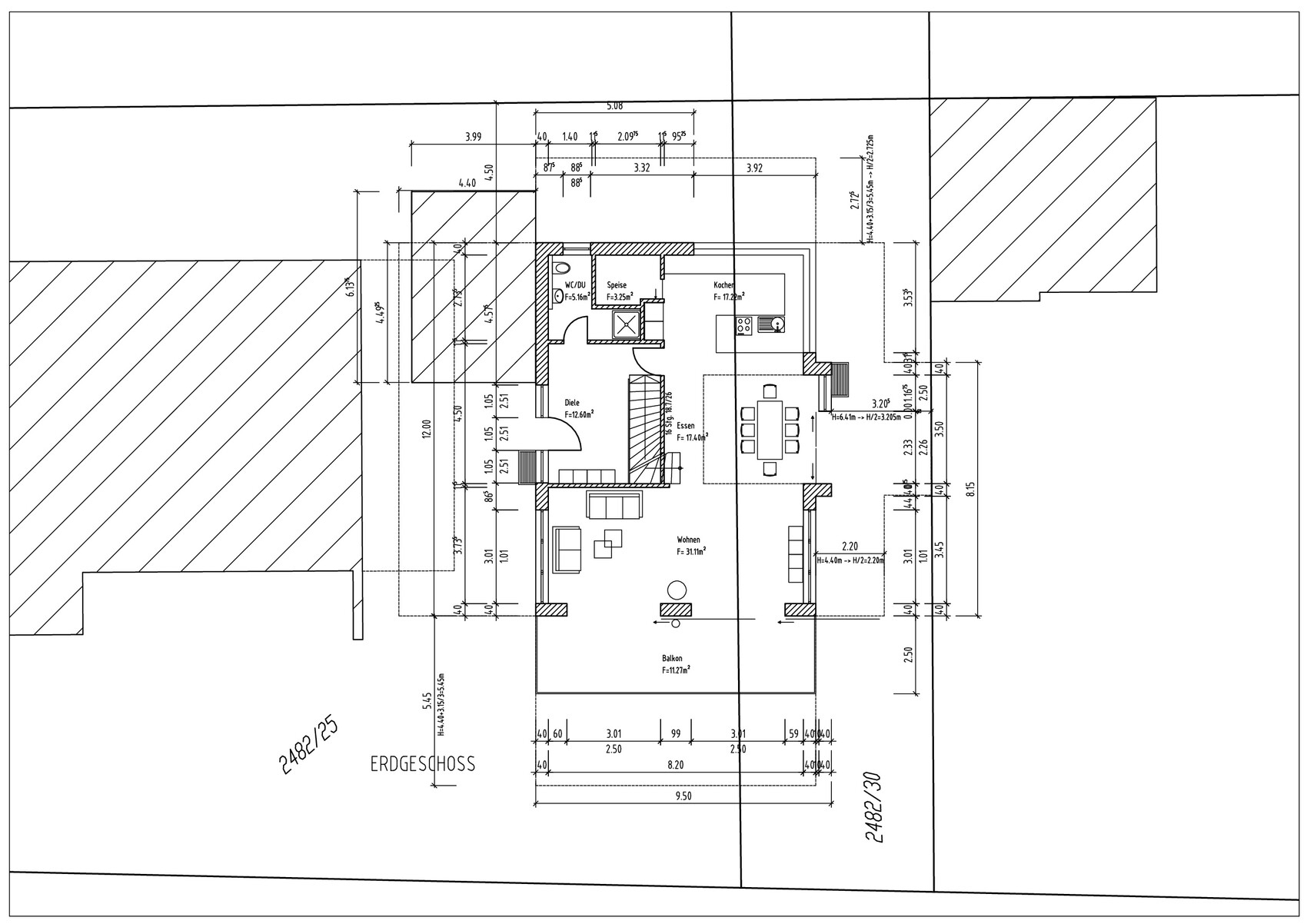

What I would like to discuss here is the layout concept.
Our main challenges were our large bed (2.30 x 2.30 meters [7 ft 6 in x 7 ft 6 in] with nightstands each 0.45 x 0.45 meters [1 ft 6 in x 1 ft 6 in]) and our vision of a beautiful large bathroom with a sauna, plus a practical utility room on the upper floor.

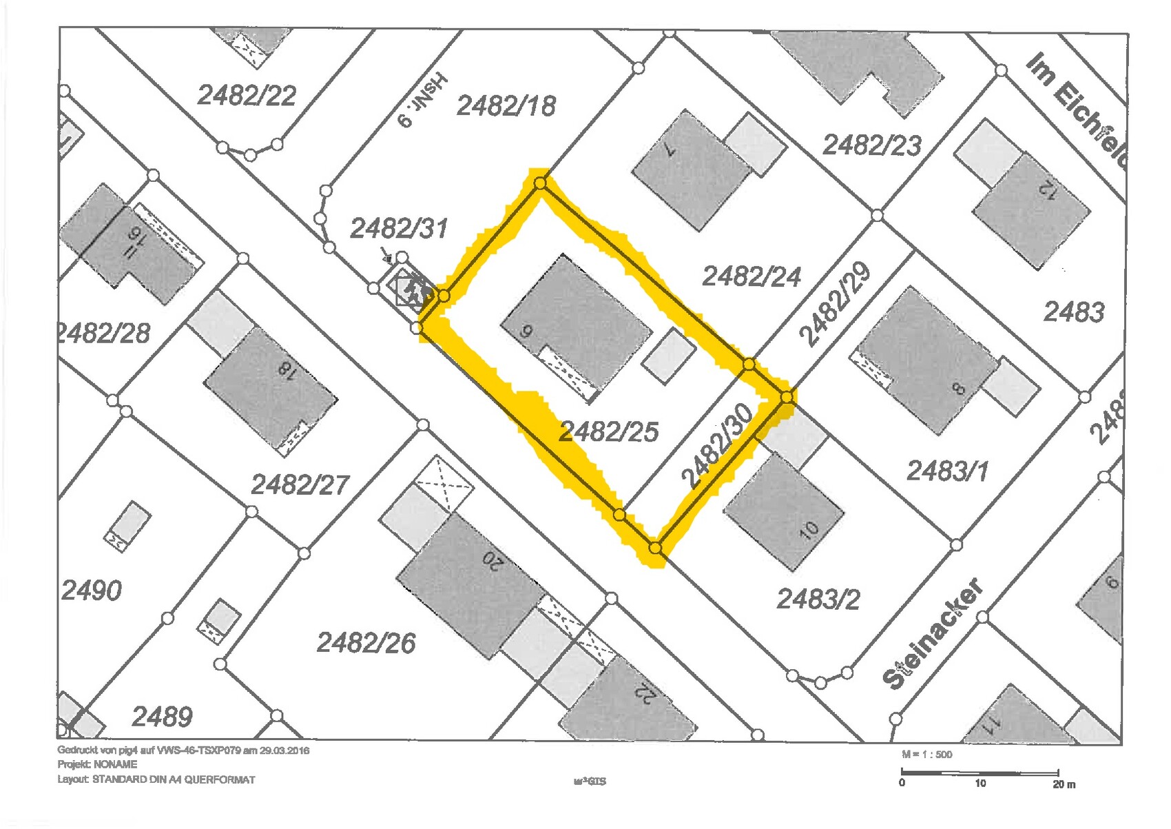

On the site plan, you see the entire property outlined in yellow, including the existing buildings. It consists of two cadastral parcels.

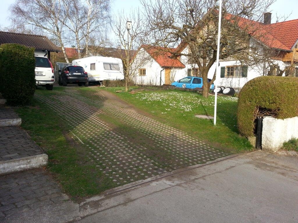

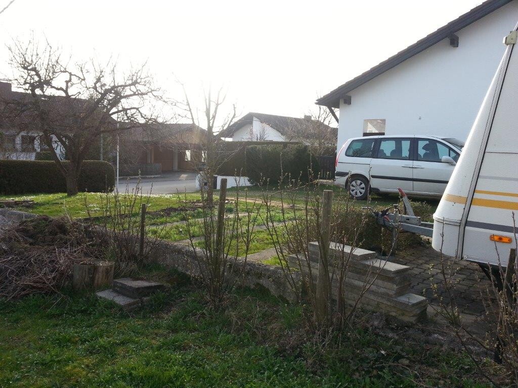

I also added two pictures of the property to give an impression of the slope.

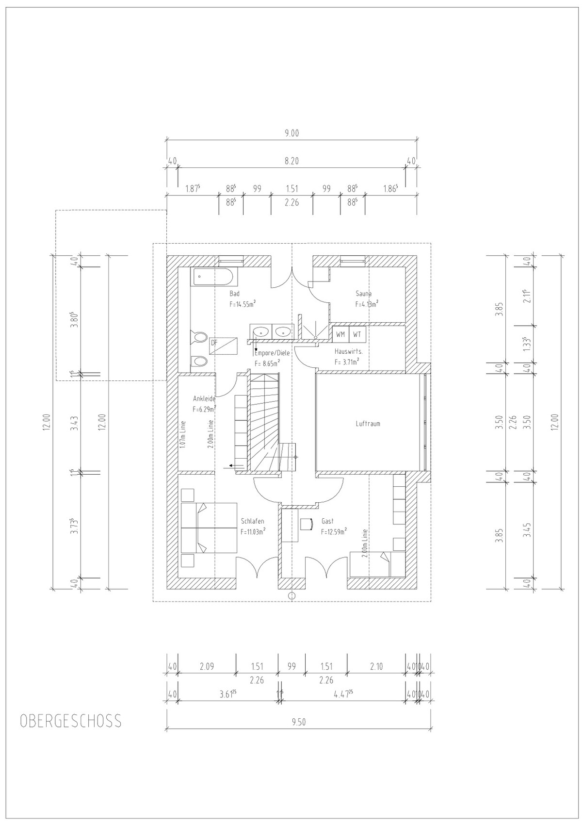

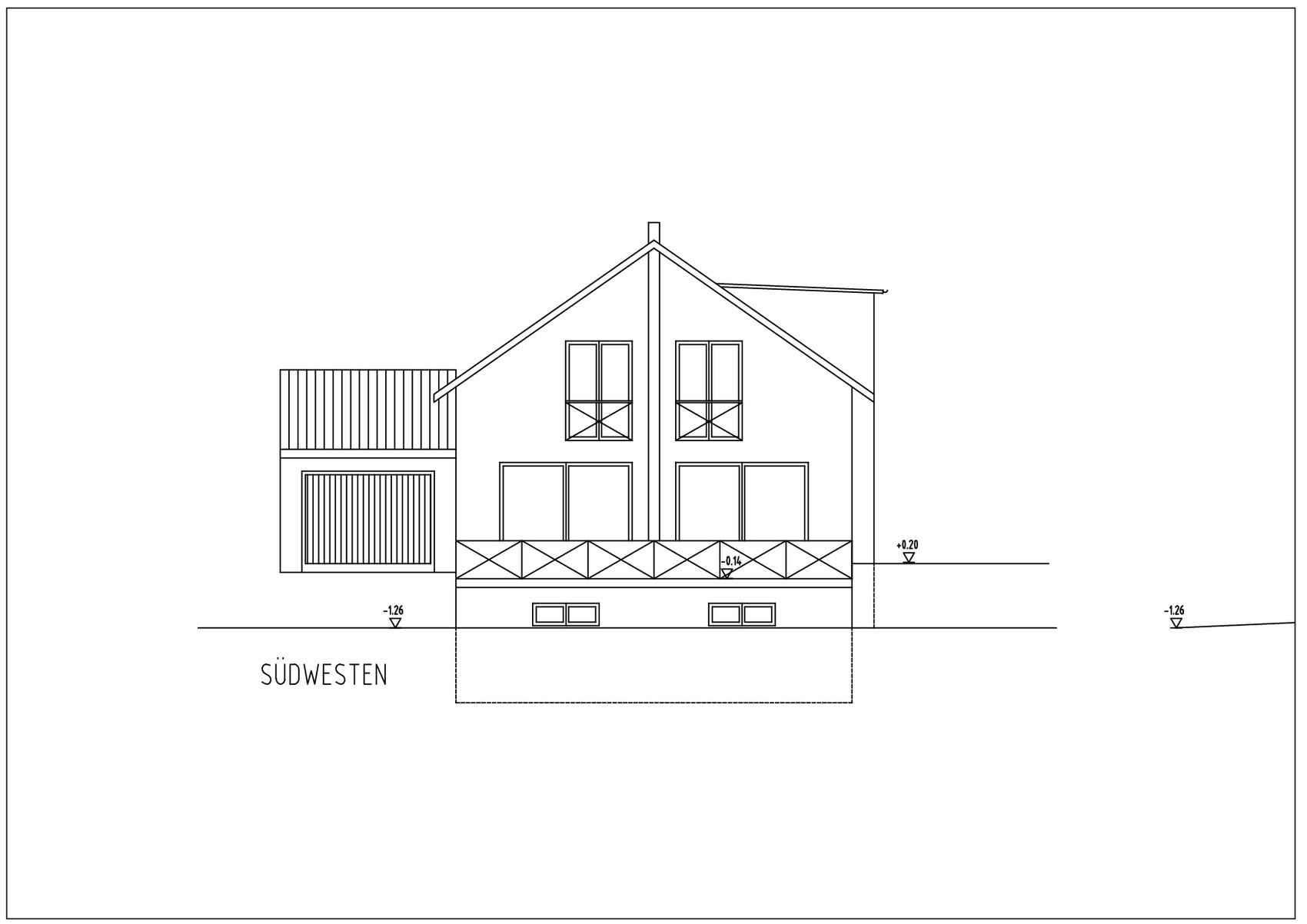

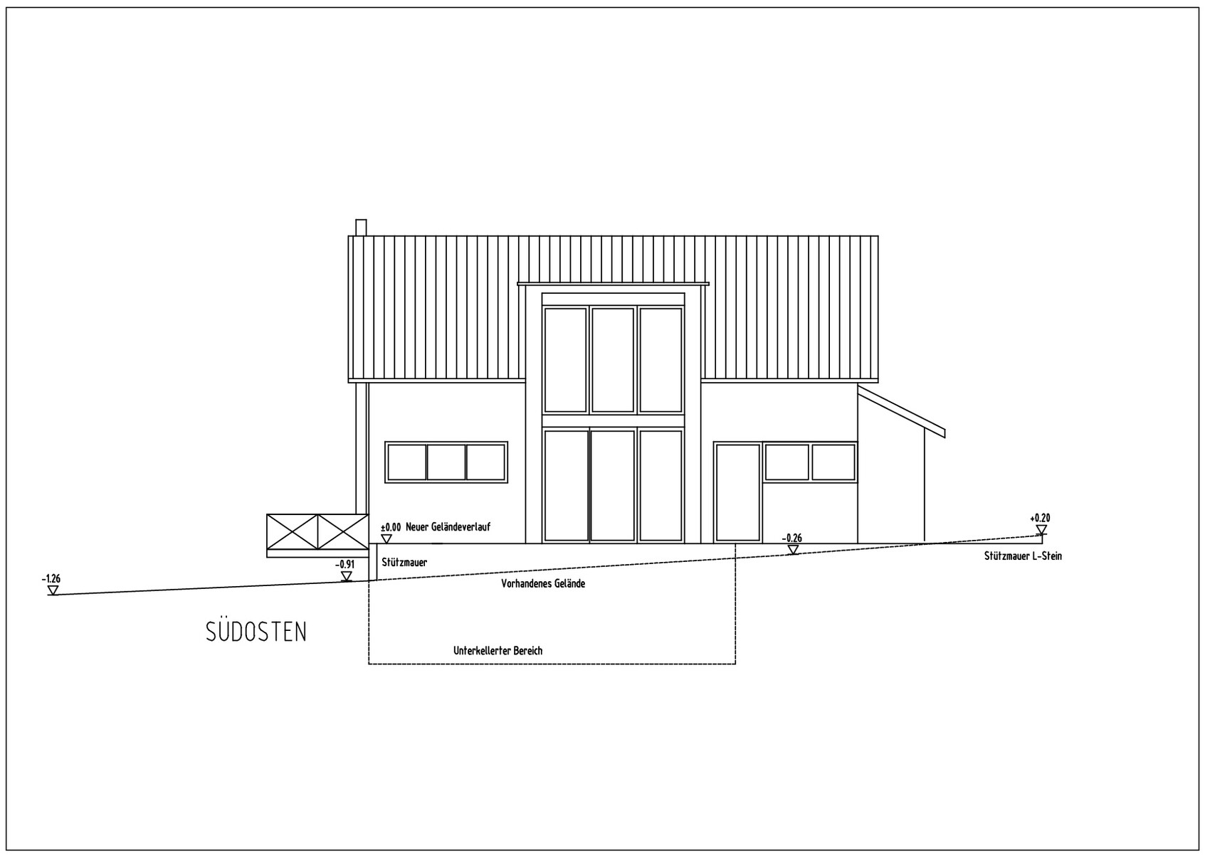

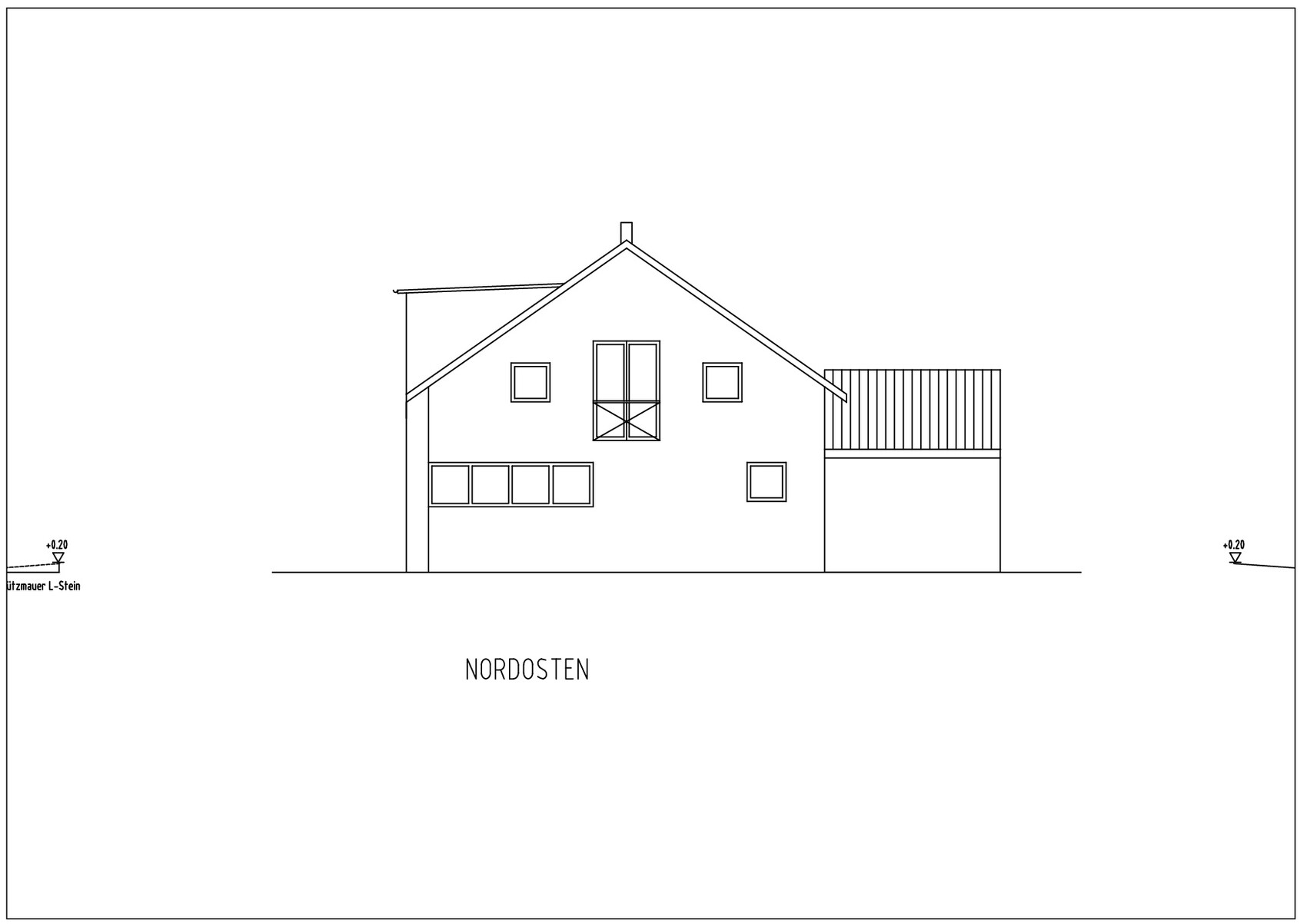

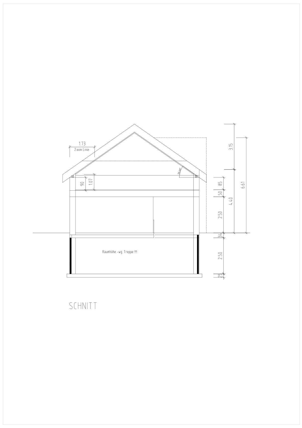

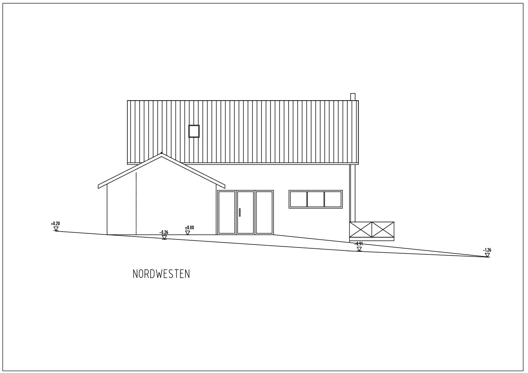

So, I’m revisiting my old topic now.
I have received the first plans from our architect (properly drafted plans).
In between, there was a lot of planning work, ideas added and partly discarded, etc.
Currently, there is already a preliminary agreement with the building authority / planning permission; the house will be approved as planned. Now, we are focusing on the interior layout and, in a second step, on the exterior design.
But one thing at a time. Since we weren’t entirely happy with the walk-in closet, we eventually came up with the idea of adding a return corridor on both sides. Here is a rough sketch to give an approximate idea:
This would create enough space in the walk-in closet and expand the dining area as well as the open space towards the front.
After the initial cost estimate, we reluctantly decided to remove the dormer on the west side (intended for the walk-in closet), even though that was basically the reason we wanted it in the first place. Well, currently we only have the dormer facing southeast, in the dining area/open space.
I’m attaching the architect’s plans. North is in the top left corner—exactly where the house has the corner in the top left, as indicated in the plans from the first post.
We have reduced the planned basement. This is partly due to the rapidly rising costs of excavating the entire house for a basement. This is because of the existing garage, which doesn’t have a basement; excavating there would require extensive shoring work. We considered possibly demolishing and rebuilding the garage, as that might be cheaper. So, we decided to scale back the basement.
However, we are still not completely satisfied with the plans:
1. Overall, the facades are too plain and boring. There is a lot of potential to improve them.
2. The walk-in closet currently has no window; at least a roof window (skylight) must be added.
3. The draftsman enlarged the dining area at the expense of the entrance area. Whereas in my plan the center of the house aligned with the middle of the stairs, the staircase and corresponding walls are shifted left (west). This is not a bad idea; we don’t need a large foyer, but it also reduces the size of the walk-in closet. The closet currently drawn there no longer has a 60cm (24 inches) depth and is basically unusable. This makes us reconsider adding the dormer again. As it stands, it doesn’t work. We need a 60cm (24 inches) deep closet where longer items can be hung. The knee wall is only 1.07m (3.5 ft), so a closet of the necessary height won’t fit there.
4. The kitchen is incorrectly planned. We’re sticking to our layout with a patio door between the kitchen units, but this is not a major issue at the moment.
5. Basement: it still extends too far into the garage and could be reduced further. Basically, it can start at the stairs, which should be sufficient and better structurally for the garage.
6. Regarding the basement layout: we don’t like it at all. Both rooms have skylights facing forward, but we don’t want the utility room there. We want the stairs to match the upper floor, exiting to the right (east), with the hallway there, two rooms at the front, and the utility room behind the stairs (currently the hallway).
7. Utility room on the upper floor: we want to enlarge it by a few centimeters at the expense of the sauna, and add a sink (I don’t want to carry the dryer’s condensate water all the way to the bathroom).
8. The roof window above the toilet/bidet will be enlarged. This will provide not just more light but also more headroom.
9. The ground floor staircase is open to the entrance area but has a wall on the living room side. We actually want the opposite: open to the living area and walled on the entrance side. Then the staircase wall would run continuously from basement to upper floor.
10. Window layout in the living room is unacceptable. Besides looking very dull and uninspiring from the outside, we don’t know where to place the TV, for example. The row of windows on the right (east) side will definitely be removed and replaced with shelving. We’re also considering removing the window on the left side facing south—replacing it with a wall (not extending fully to the middle), where a stove and TV could be placed. A larger window, possibly wrapping around the corner, could then be installed to the left.
11. The bathroom windows are boring, too. I like to have a nice view when I’m bathing, so we will definitely change something there. At the moment, it just looks plain.
No, nothing like a wart: a beam that runs through the entire house. Our nod to the Bauhaus style, which we would have loved to build.
No, it really came about this way because the dressing room couldn’t be arranged differently. And if it’s double-sided, it has a certain something. That’s why I’m not entirely happy with the current design either...
Eliminating the wart failed here due to the low knee wall.
Otherwise, we have an appointment with the architect on Friday, and I’ve already thought of quite a few ideas (even more than what I’ve shared here; these are the main points), but maybe I’ll get some useful input here for our meeting.
Climbee schrieb:
a beam that runs through the house. Our tribute to the Bauhaus style, which we would have loved to build Where do you see "Bauhaus" in a dormer with a shallow pitched lean-to roof (or even a cross beam made of two of these)?
If the list of requested changes is so long and the fitting of the rooms can only be achieved by disturbing the roofscape (and even then only moderately satisfactorily), I would take that as a signal to scrap the plans.
The list of details to "preserve" should be kept as short as possible, otherwise the next design will get stuck at the same point.
