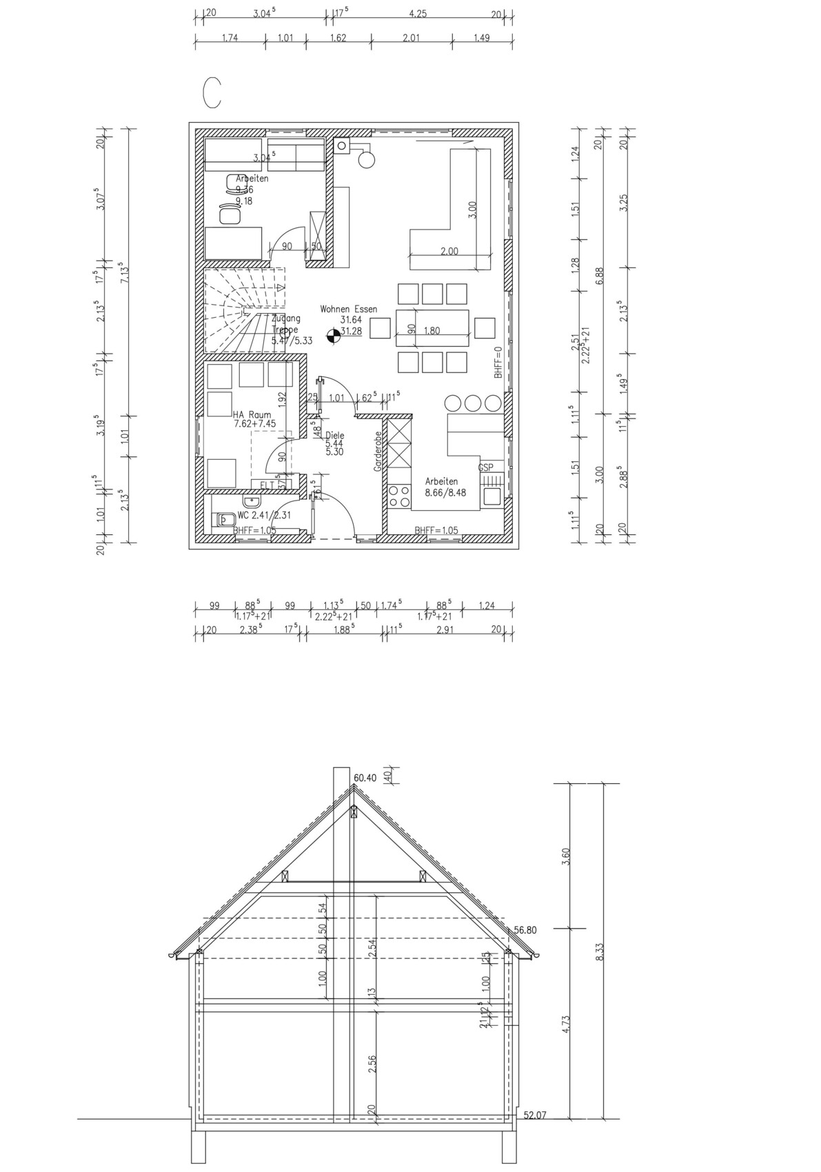

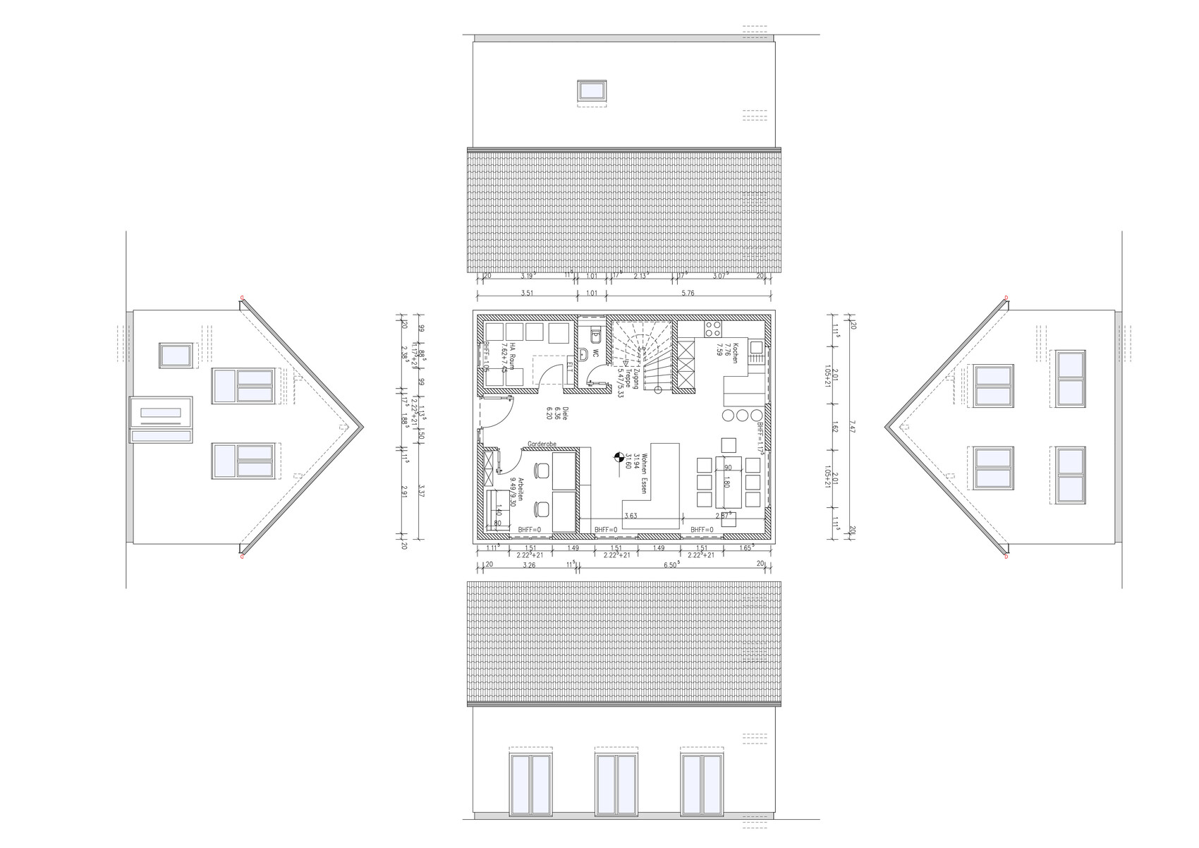

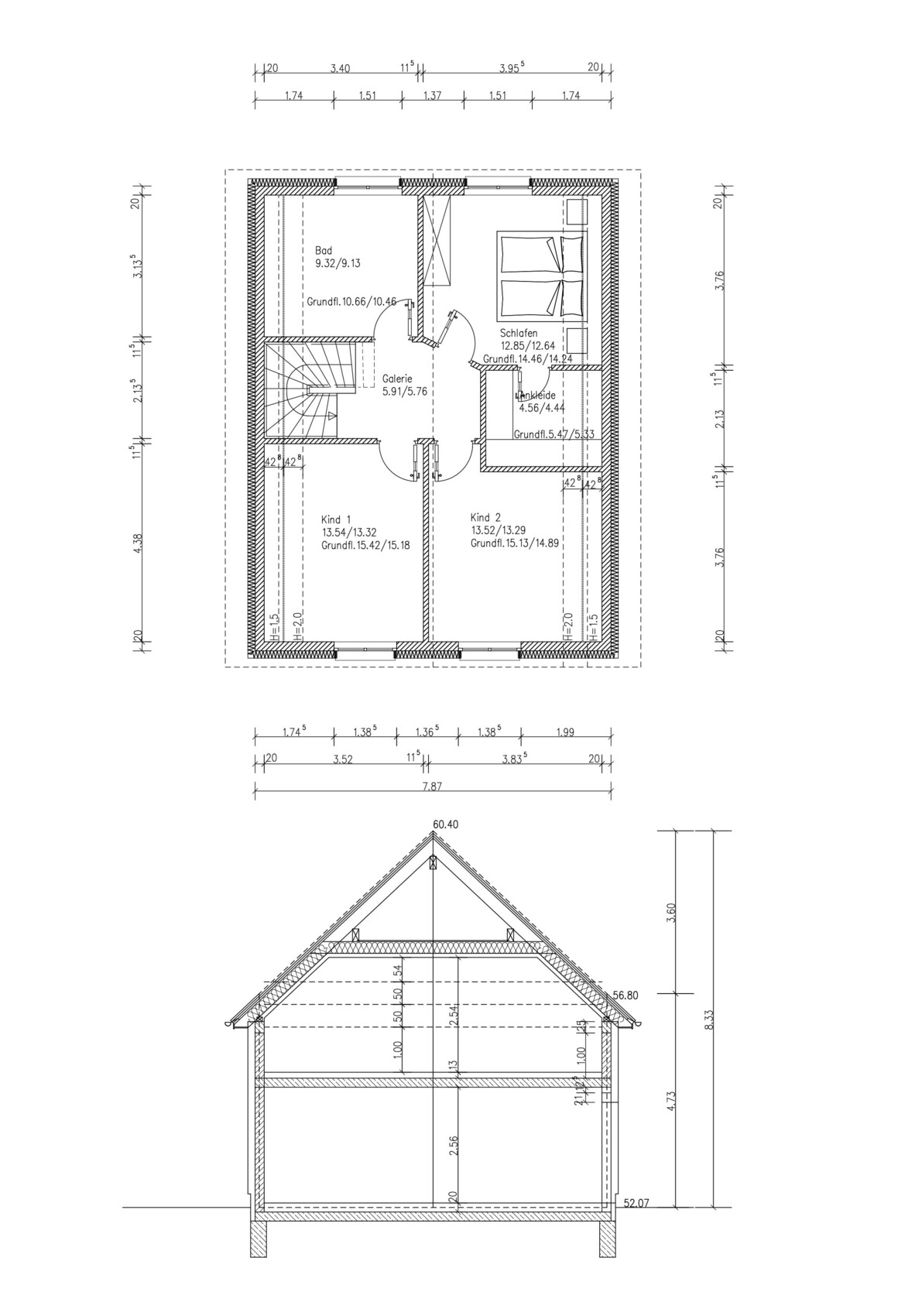

Hello everyone, and thank you very much for all your answers and ideas. Unfortunately, we faced another setback, and we were actually thinking of giving up for good and building elsewhere... After some back and forth with the building authority / planning office, things are looking better now.
The architects have now created a floor plan based on the surveyor’s data—actually two versions: one with a fireplace and one without. I was quite surprised by how many square meters (square feet) we have.
What do you think?

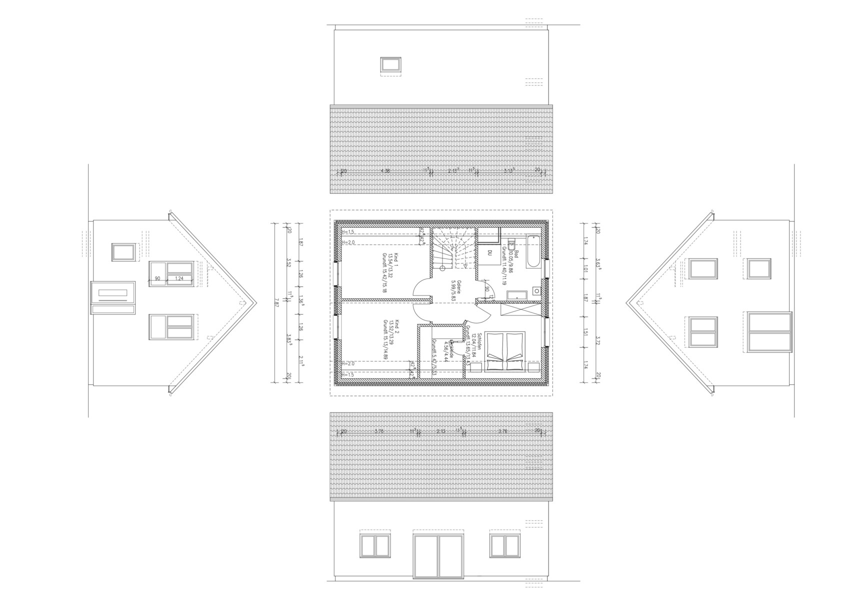

23 Mar 2023 07:46
Here is the plan including the fireplace and a slightly modified floor plan.

K a t j a23 Mar 2023 08:07
The reasons behind this layout would be good to know. How is the house planned to be positioned on the plot? Where are the parking spaces and driveway located?
It doesn’t really impress me at first glance. But maybe it suits your needs perfectly.
