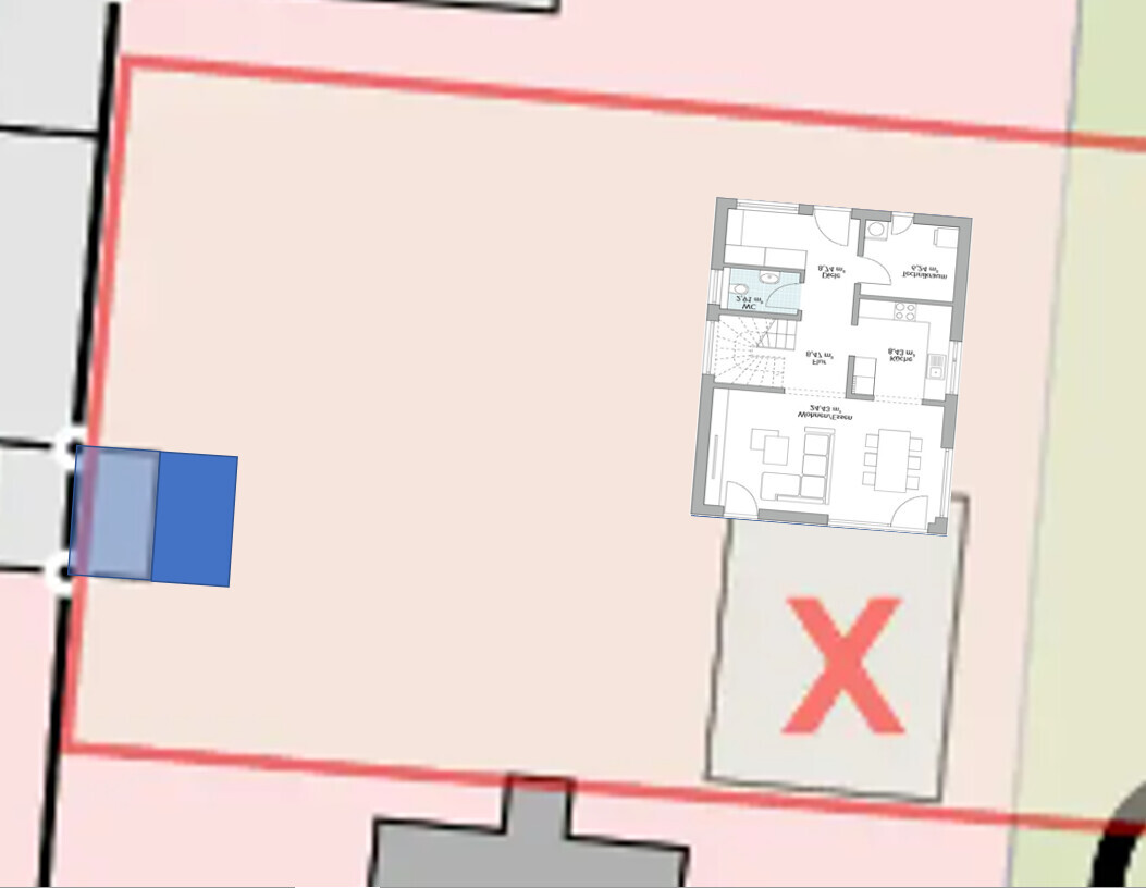

We are a family of four (children aged 4 and 13) and have been trying since 2017 to obtain a building permit for a plot of land owned by my parents, located south of Potsdam.
The main challenge is the location of the property. Since my parents’ house is the last house on the street, the residential area also ends there, and despite having 10 hectares (25 acres) of land, our building options are extremely limited. After a long legal dispute, we have at least secured a preliminary approval for a building permit. However, this comes with the compromise that the new building must be constructed on the current site of an old barn (key point: model effect when building in rural areas) and must adhere to the barn’s existing volume. We need to demolish the barn and then build our new home on that spot, which means we have very strict requirements for the floor plan.
We have had an official site plan prepared. Since our original plan (an L-shaped bungalow) was basically the opposite of the current planning, I would be very grateful for any advice on room layout and orientation, as I have not found a good approach so far. The barn’s footprint can only be shifted along the axis to the extent that the property boundaries do not overlap. According to the building authority, a wall thickness of 25 cm (10 inches) is allowed as an increase in volume, but any further enlargement (bay windows, altered roof pitch, etc.) is not permitted. Our equity amounts to around 250,000 €.
We already have a planning meeting scheduled with an architect (March 1, 2023), but it would be great to get some ideas here on what we should consider beforehand. Perhaps someone has similar dimensions and ideas on how to create a nice floor plan.

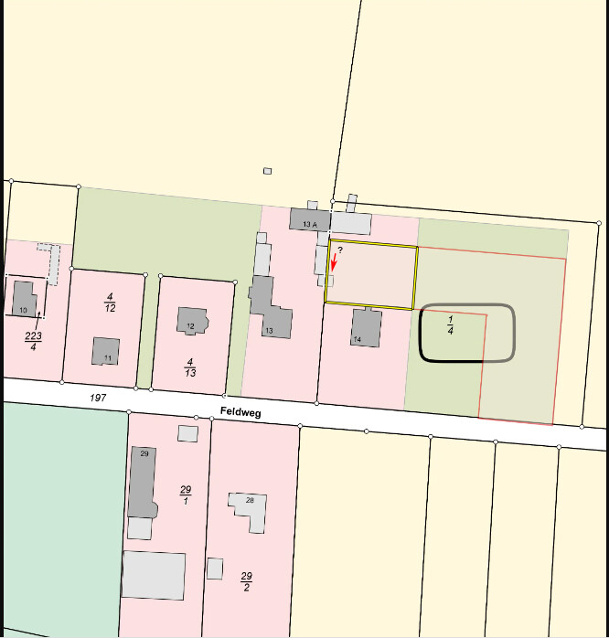

hanghaus202320 Feb 2023 19:17Sumi2188 schrieb:
According to the building authority, a insulation thickness of 25 cm (10 inches) is approved as an increase in volume. However, no further enlargements (bay window, altered roof pitch, etc.) will be allowed. The equity capital amounts to approximately 250,000 €. You probably meant insulation. So the allowed dimensions are W = 7.64 m (25.1 ft) + 2 * 0.25 m (10 inches) = 8.14 m (26.7 ft); L = 10.05 m (33 ft) + 2 * 0.25 m (10 inches) = 10.55 m (34.6 ft).
Or am I reading something into this that wasn’t intended?
Where is the carport located?
Sumi2188 schrieb:
There are no other restrictions besides staying within the building volume. 🙂I assume the yellow area is your building envelope? Can you freely move within that? Or would it also be possible on the right side of the plan? What about the utility lines? Can you extend them from your parents’ property?
Can you rotate the small house, or is the ridge direction fixed?
What kind of building is that on your land? Looks like it belongs to the neighbor? Does the plot have an angle or kink there? How high is it?
