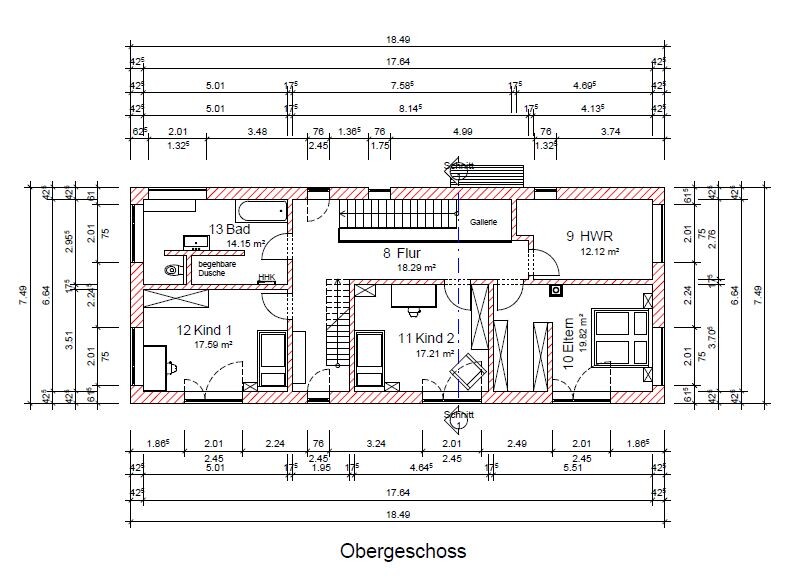

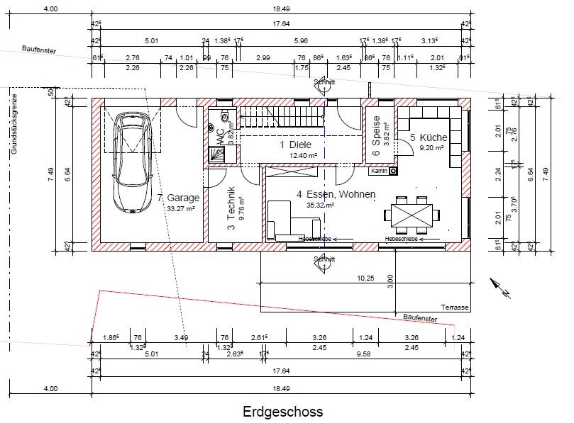

We are currently working on the floor plan designs. We approached a general contractor with the following requirements:
- Exterior dimensions approximately 18.0 x 7.5m (59 x 25 feet), solid masonry with 42.5cm (17 inches) brick walls
- Ground floor layout: entrance area, cloakroom, technical/storage room, toilet including shower, straight staircase, pantry, living/dining/kitchen (kitchen on the north side with a view of the driveway), (garage)
- Upper floor layout: 3 bedrooms, bathroom, utility room + hobby room
- Two full stories, roof with 45° pitch

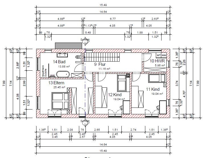

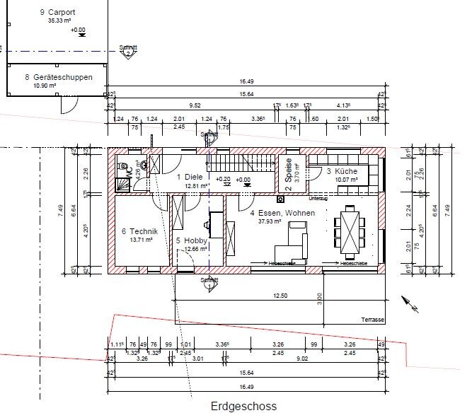

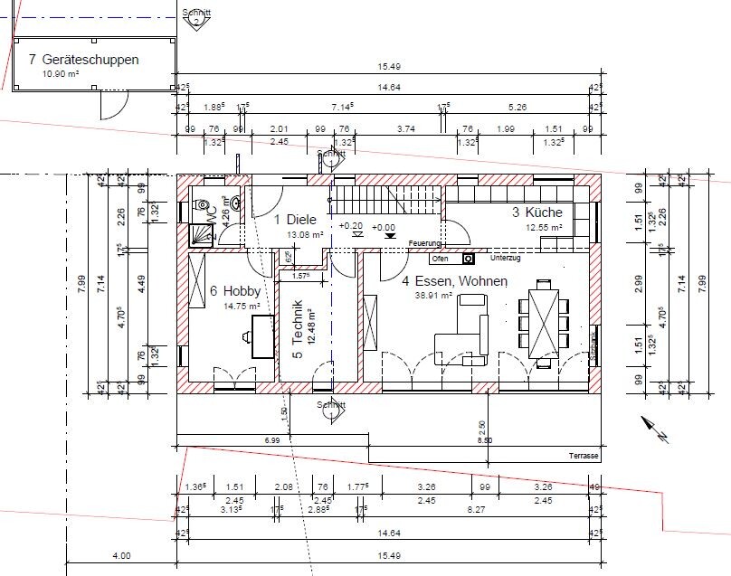

The latest update has been completed. Major changes:
@11ant: The plan is for the attic to be accessed via two space-saving stairs from the children's rooms.
Further feedback is welcome.
Christoph.
- Exterior dimensions are now 15.5 x 8.0 m (51 x 26 ft)
- Pantry removed
- Adjusted window positioning on the northeast side
- Relocated fireplace
Christoph.

In the master bedroom and bathroom, I would place the windows similarly to the ground floor. This reduces splashing in the shower area and allows the bed in the master bedroom to be positioned with the headboard flush against the outer wall, providing comfortable space on both the right and left sides of the bed. A sliding door running inside the partition wall would be suitable for the dressing room.
On the ground floor, a practical kitchen layout needs to be designed, as the window positions do not allow for strategic placement of tall cabinets.
