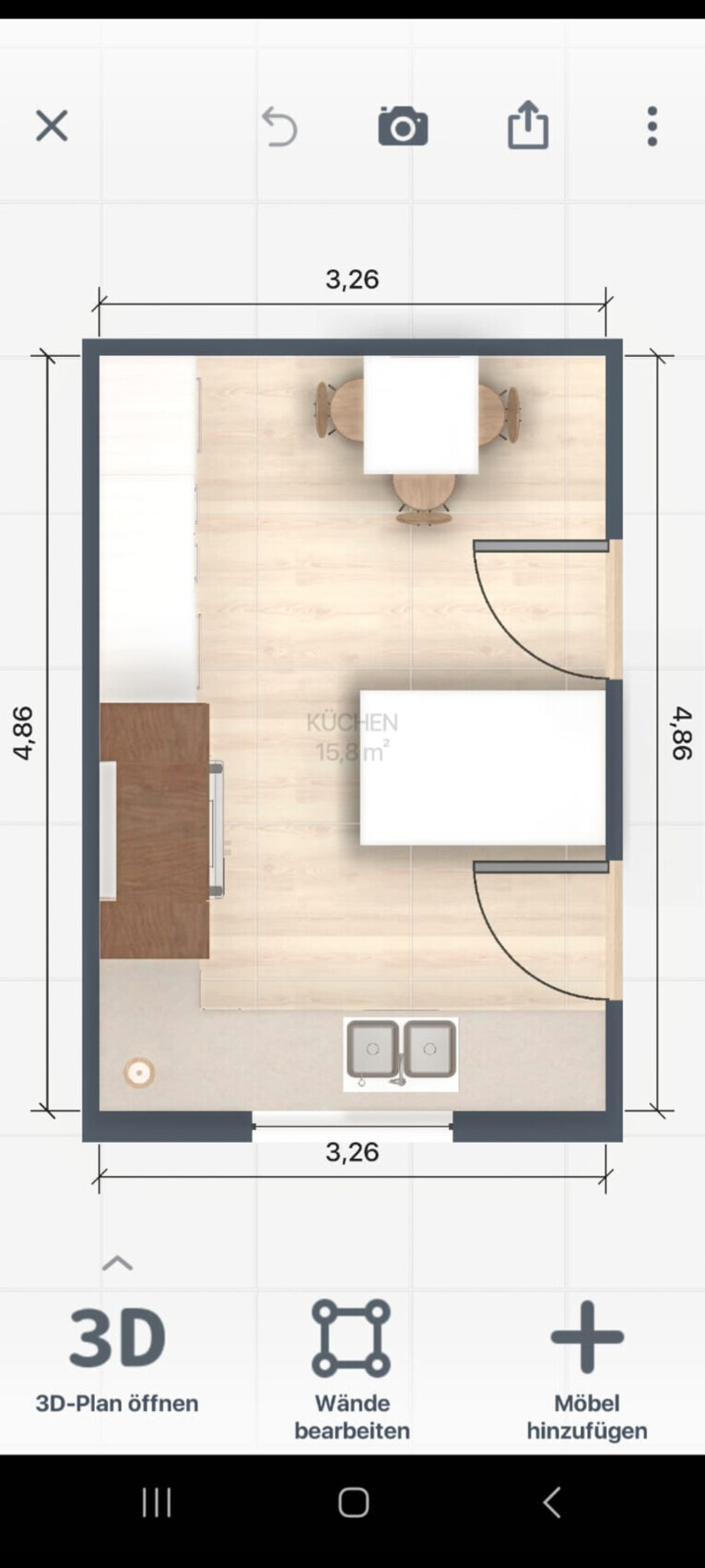

If you place a sink run at the bottom of the plan, it should be at least 80 cm deep (31.5 inches) so that the distance to the island is not too large and you can still pass to the right towards the dining table. The circle marks the problem area. If the niche is wider, the island can be a bit longer and the sink run a little less deep.This looks good but it is an open kitchen. We want a closed one.Here is a design from a kitchen builder:
Counter with stove.
The doors are sliding elements.
The brown area is a refrigerator.
One of the tall cabinets would be the passage to the utility room.

My sample drawings were meant to show that the house design isn’t finalized yet. Just trying to share kitchen layouts that are suitable for families of five and houses around 194 m² (2090 sq ft). Oh, right, thanks.
Yes, it’s supposed to serve a bit for breakfast or when someone is in the kitchen so that others can sit with them...
Schorsch_baut17 Oct 2024 15:21Benutzername12 schrieb:
That looks good, but it is an open kitchen. We want a closed one.
Here is the plan from a kitchen designer:
Counter with stove.
The doors are sliding panels.
The brown one is a refrigerator.
And one of the tall cabinets would be the passage to the utility room.I would quickly change the kitchen planner.Similar topics
