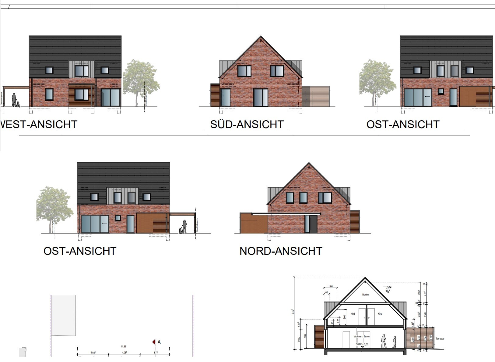

we are now also starting to fulfill a small dream of owning our own home. I am very curious about your opinions and experiences.
Currently, we live in a 4-room apartment of 70 sqm (750 sq ft).
We are planning for just under 200 sqm (2,150 sq ft).
We need a room for each of our three children; the house should be functional.
From the outside, it should have a modern appearance.
We would like two full floors with a small flat or hipped roof. Unfortunately, this is not possible, and these restrictions apparently only allow what has been designed so far.
I would like the dormer at the front and the front extension to be larger purely for aesthetic reasons, but the architect says it is not necessary.

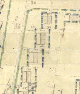

Attached is the third house/plot from the top.
Plot size: 700 sqm (7,535 sq ft)
- Minimum distance to the street is 7.0 m (23 feet)
- Building depth is 12.0 m (39 feet)
- Orientation MUST be ridge side facing the street according to the development plan

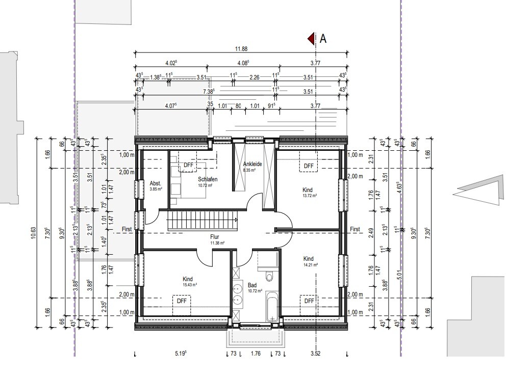

A few things I’ve noticed:
- The kitchen is quite far from the terrace.
- What is the very narrow utility room intended for?
- Where will the main service connections enter the house?
- The storage room door opening outward into the carport will probably not be ideal for the car’s fender.
- The entrance platform in front of the front door will not be very deep, otherwise it will be difficult to pass by safely with a car.
- The low bed access on one side in the master bedroom seems interesting to me.
- What is supposed to go into that very narrow utility/technical room?
- Where are the main utility connections coming into the house?
- The outward-opening door of the storage room leading to the carport will probably cause issues with the car’s fender.
- The entrance platform in front of the main door won’t be very deep, otherwise cars won’t be able to pass without damage.
- The low headspace on one side of the bed in the master bedroom seems interesting. There will also be a terrace at the kitchen/dining area. It faces southwest.
The utility/technical room is considered sufficient according to the architect. It is supposed to house the building services... hmm.
The house connections come in from the street side where the utility/laundry room is located. We are considering enlarging the office and moving the technical equipment into the utility/laundry room, and removing the cloakroom, since the current design of the utility room is not very functional.
You’re right about the storage room.
The architect says we don’t need an entrance platform.
The distance from the neighbor’s property line to the house wall/entrance is 3.40 meters (11 ft). That should be enough for a car to pass, right?
Or do you have another suggestion here?
You are right about the bedroom.
What would be a practical solution there?
Also, won’t it get very hot upstairs in the attic during summer?
