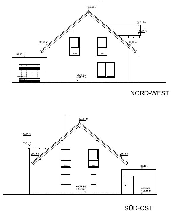

Cico1
15 May 2017 11:05
Hi,
Yes, I would also like to place the cloakroom in the utility room, meaning the wall will be moved.
The sizes and arrangements of the windows on the ground floor and first floor will still be changed.
Attached are the elevations – the site plan will follow.
Architekturzeichnung: Haus mit Garage; Nordost-Ansicht (Eingang, Fenster) und Südwest-Ansicht (Dachgaube).
Nord-West- und Süd-Ost-Elevation eines Satteldachhauses mit Garage, Fenstern und Kamin.
15 May 2017 11:56
While many prefer fixed windows or ones with a window sill, I like an open view of the garden and the opportunity to step outside everywhere.
In this respect, I would design this window in the living room as a patio door – eventually, you’ll regret not having direct access to the garden from this side.
Regards, Yvonne

15 May 2017 13:01
I would possibly also provide access to the stairs from the living area, if this is feasible.
Many people I know who have the staircase right by the front door are annoyed because dirt from outside may be carried upstairs by walking through.
11ant15 May 2017 13:50
Cico1 schrieb:
Do you still have any suggestions for improving the floor plan?
They’re already there:
Curly schrieb:
In the ground floor hallway, I might consider creating an alcove in the utility room to make space for a coat rack. I also find the windows on the ground floor facing the front too narrow,
Aotearoa schrieb:
If possible, I would also consider accessing the stairs from the living area.
I would also put the coat niche there and widen all the narrower windows to 1.26 m (50 inches) in width. I like the idea of reversing the staircase direction.
Cico1 schrieb:
Yes, it’s a cozy fireplace that will be lit occasionally on weekends.
We haven’t chosen a model yet.
I recommend the model “None.” That “occasionally” happens less often than you think. Then you turn the heating in the living room up by three degrees and watch the fire in HD TV. Your mind says “fake,” but your feelings “remember” sitting in front of the fireplace afterward. Psychology or whatever it’s called.
