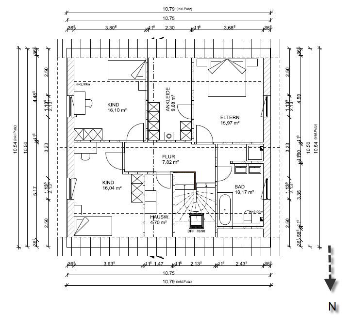

What don’t you like? Staircase, layout of the upstairs bathroom
Preferred heating technology: undecided yet between air-to-water heat pump or gas (but gas needs a storage tank for the energy saving regulations, right?); geothermal energy not allowed
Please provide suggestions for improvements or optimization. I would especially like your opinions regarding the staircase. We would probably move the roof window from above the dressing room to above the stairs, any thoughts?

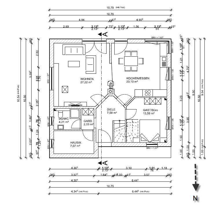

Hi everyone,
after a long time and some back and forth with several things, we are now moving forward with the plans.
We have a meeting with our planner at the end of the month, and until then I would like to outline some tips from you and prepare the drawing.
Attached is the current status with measurements. I have drawn a north arrow in the bottom right corner.
Regards
P.S. If this doesn’t work, I can upload the files elsewhere.
Regards
Who designed this plan?
There are two drains running through a room on the ground floor, the wall on the upper floor is not aligned at all and has an unnecessary offset, and the same issue appears on the ground floor with the open partition wall.
The staircase passing through the ground floor room is the absolute highlight.
Regards, Yvonne
Regards, Yvonne
Cico1 schrieb:
After a long time and some back and forth with several issues, the plans are now progressing.Your planner should refund their fees. Unfortunately, I can’t open the initial plans; they must have been even worse if you have now made changes.Maybe @Bauexperte will respond, as they seem to be familiar with your general contractor and hopefully have good suggestions for you.
Bauexperte is no longer active here!Active somewhere else?Back to square one!
This simply won’t do. I fully agree with the previous commenters.
What kind of planner is this????
Very funny: the crooked sliding door around the stove (that’s supposed to be a stove, right?). They can’t be serious. If someone installed a sliding door like that in an existing building with unmatched DIY spirit, I’d laugh and shake my head, but if this is actually planned, there’s only one thing to do: immediately dismiss the planner.
The staircase through the guest room... well... not ideal, but at least you could make a built-in closet underneath.
I find the bathroom layout awful. When I enter through the door, I’d immediately bump into whoever is brushing their teeth at the outer sink. And poor guy coming out of the shower, drying off just outside—he’s constantly at risk of the door slamming into him.
The cloakroom is basically useless since it’s practically inaccessible due to two doors leading to the toilet and utility room. Definitely impractical for a four-person household.
