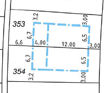

eltorodani7 Nov 2016 17:14Wow, many thanks in advance to everyone taking the time to read my post. I know it can be quite abstract, especially writing to strangers :-) THANK YOU! I have attached the plan of our plot, and please excuse me if I forget to share some details... as I said, I’m just at the very beginning (at least I already have the plot:-)).
You can see the dimensions quite clearly on the plan. I think the advice about the hose is great... we were actually thinking that because of the narrow width, it would make sense to create more living space through the length.
We are allowed to build a maximum of 6.5 meters (21 feet 4 inches) in width, and between 12 and 16 meters (39 feet 4 inches to 52 feet 6 inches) in length on the ground floor. On the first floor, a maximum of 12 meters (39 feet 4 inches) is permitted, so if the full 16 meters (52 feet 6 inches) are used on the ground floor, only a terrace, balcony, or a flat roof could be constructed above. The garden faces west.
I also think a guest room will be difficult... but your input is already very helpful. As mentioned, I’m not looking for professional architectural advice but for suggestions to be better prepared when it comes to the details; practical tips are also welcome :-)
