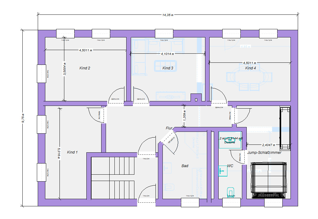

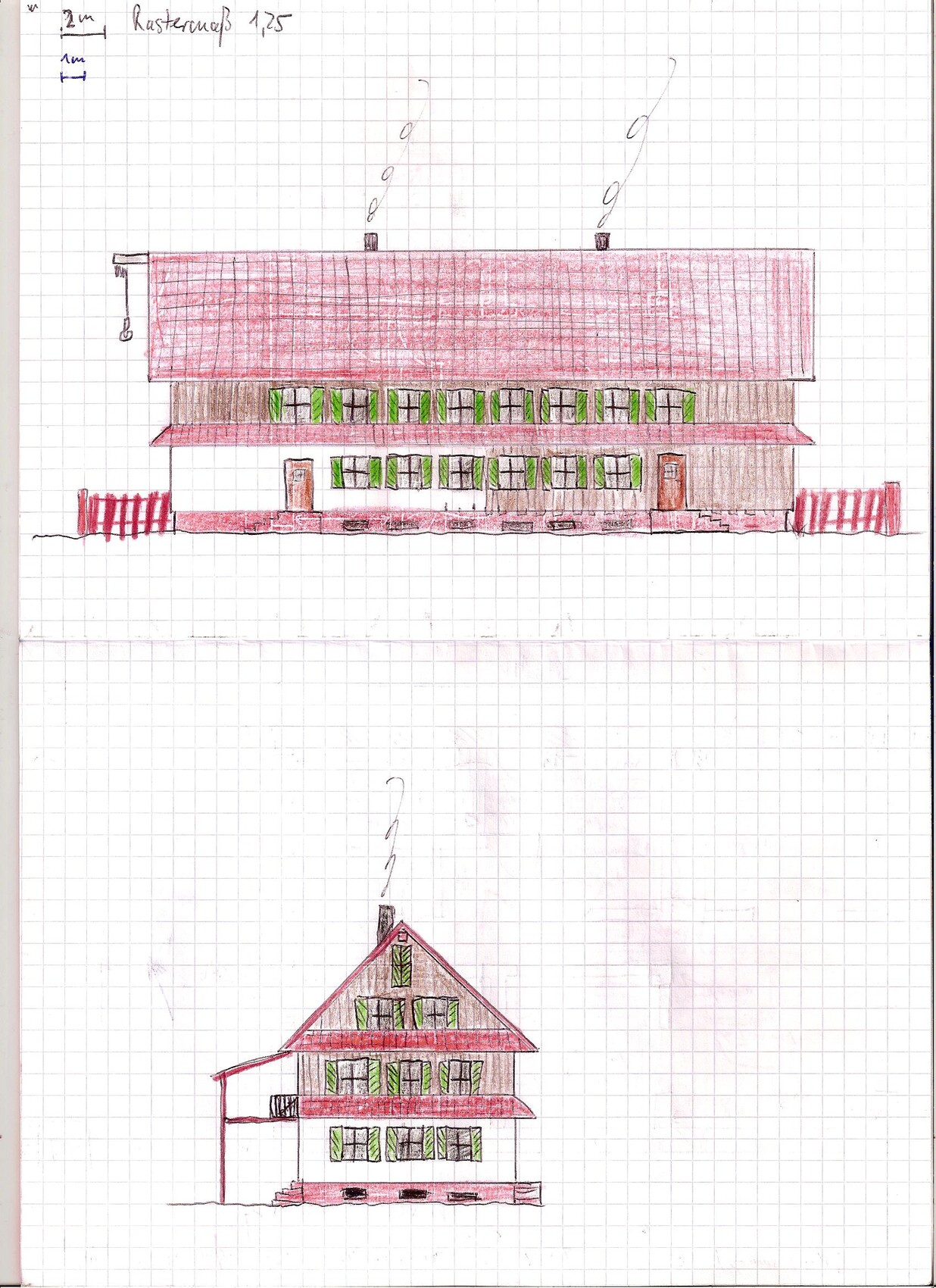

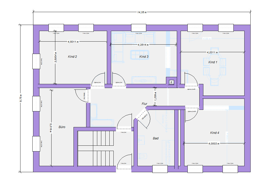

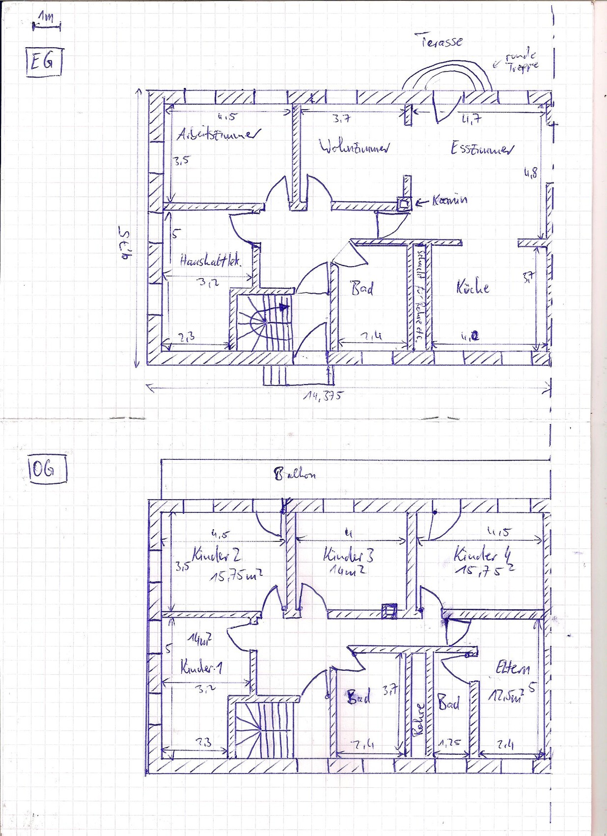

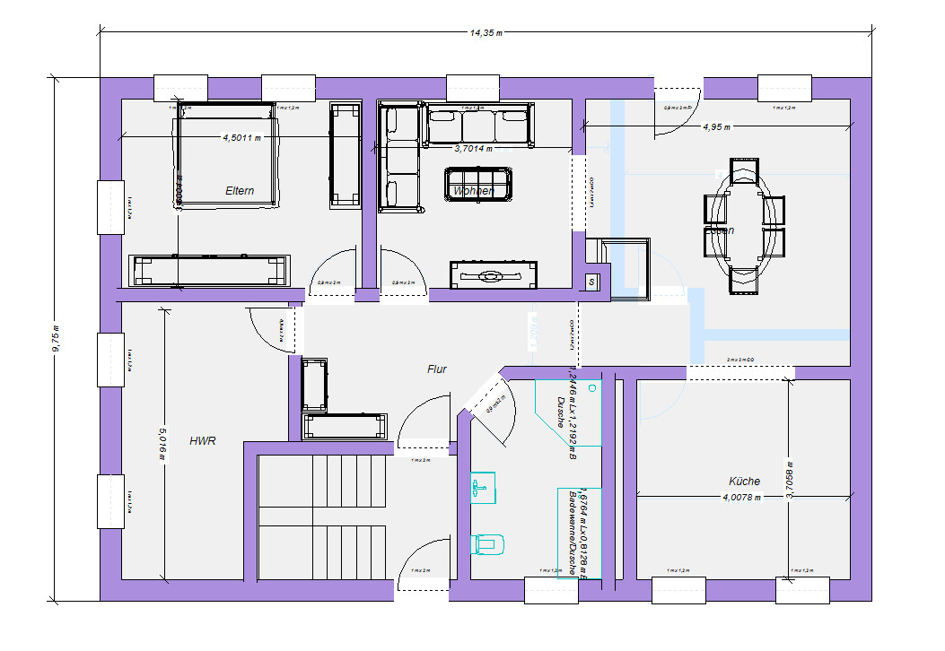

At the moment, we are planning to build a semi-detached house together with my brother’s family. We already have a plot of land on the edge of the village, see attachment.
The plan is for a timber frame house. Before consulting an architect for detailed planning, we want to first draft a preferred floor plan ourselves to clarify our own wishes.
Since this is our first house, we hope to get some suggestions regarding our ideas here.
The two halves of the house should be mirror-symmetrical in terms of the ground area in the first draft, to keep the building simple. The room layout can basically differ but, due to similar requirements, it is also planned to be mirror-symmetrical. The floor plans of one half are outlined in the attachment.

The bedroom doesn’t work. There is no space for a bed.
The living room also feels very small.
Where is the building services equipment located?
A large wardrobe for six people is missing in front of the staircase.
As it stands, the staircase is located in the dirty zone near the entrance.

@haydee .. Technical installations are probably in the basement .. I agree with you about the bedroom.
@creuter .. Where is east in this floor plan?
I would typically position the kitchen facing the terrace, especially with four children. So maybe swap the kitchen and living room, and locate the chimney shaft closer to the plumbing stack.
Also, if the semi-detached house is divided into two separate living units, which room would be used as the bedroom? I think none of the rooms are very suitable for that purpose.
