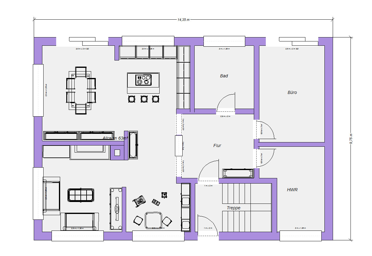

At the moment, we are planning to build a semi-detached house together with my brother’s family. We already have a plot of land on the edge of the village, see attachment.
The plan is for a timber frame house. Before consulting an architect for detailed planning, we want to first draft a preferred floor plan ourselves to clarify our own wishes.
Since this is our first house, we hope to get some suggestions regarding our ideas here.
The two halves of the house should be mirror-symmetrical in terms of the ground area in the first draft, to keep the building simple. The room layout can basically differ but, due to similar requirements, it is also planned to be mirror-symmetrical. The floor plans of one half are outlined in the attachment.

What do you think of the shown floor plans, especially the chosen room layout?

Children in the utility room at night? Someone has to explain that to me!Not me!ypg schrieb:
I would design a living room that all family members can use together. Give it space where children can play and the others can communicate.Yep.
Layout options with and without a play area.
too many walls can also limit you where they don’t need to, kaho You mean already too many walls? We’ll just tear them down – sure. I’m also in favor of fewer! However, a separate kitchen was requested – so we still need to convince them to remove the walls.
As mentioned, I consider the maintenance shaft to be excessive. In other words, the reasoning is understandable and absolutely correct, but it applies to buildings of a different scale than a single- or two-family house. With highly calcareous water, on average, you might have to remove a wall every 60 years or so. However, an installation wall can be worth considering. For this purpose, a load-bearing wall can also serve as a placeholder in the floor plan regarding thickness.
The modular dimension of 62.5 cm (25 inches) as a planning framework can practically be ignored nowadays. This often results in spaces being planned either too tight or too wide just to stay within the grid. I would apply such a planning grid only to exterior walls and be flexible at least with non-load-bearing internal walls.
kaho674 schrieb:
You mean too many walls already? We’ll just tear them down – sure. I’m also in favor of fewer walls!
However, a separate kitchen was requested – so we still need to convince them that the walls should be removed.... in the living room
