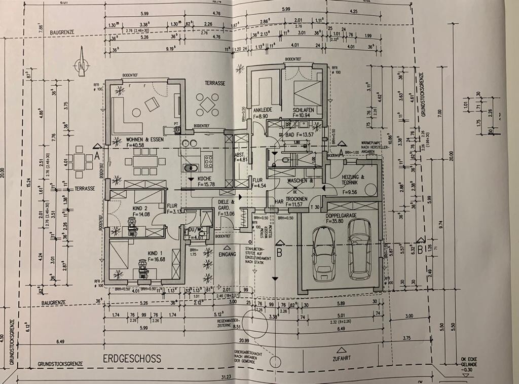

Brief status update:
After yesterday’s discussion with the architect and a subsequent site visit of the shell construction, we are considering abandoning our current plans and possibly changing the house style to a single-story design. The basis would be a previous project with the same plot orientation.
Overall, in my opinion, not much would need to be adjusted:
- Incorporation of an office
- Reduce overall width and extend to the rear
Ground floor plan of a house with terraces, rooms and garage.
face2611 Jan 2020 09:19
maxl229 schrieb:
We are considering abandoning our plans and possibly changing the house style to build a single-story house instead.
Why?
- Integration of an office
- Reduce the overall width and extend the building towards the back
But that would completely change the current (quite complex) floor plan.
Or am I misunderstanding?
Usually, you can’t just make a floor plan narrower in one area and longer in another because otherwise the rooms won’t function properly.
Edit: What kind of roof is planned for that?
maxl229
11 Jan 2020 09:50
face26 schrieb:
What type of roof is planned for that?
In this version, there is a shed roof on the left and right sections, with a flat roof in the middle and a flat roof over the garage.
L
ltenzer
11 Jan 2020 10:11
maxl229 schrieb:
In this version, there is a mono-pitched roof on the left and right parts, with a flat roof in the middle and a flat roof over the garage.
It can look nice. Personally, I am not a fan of flat roofs on residential buildings unless they are functionally necessary. The risk of a leak developing at a joint and water seeping into the house is always higher than with conventional pitched roofs. With the garage, this is less of an issue.
