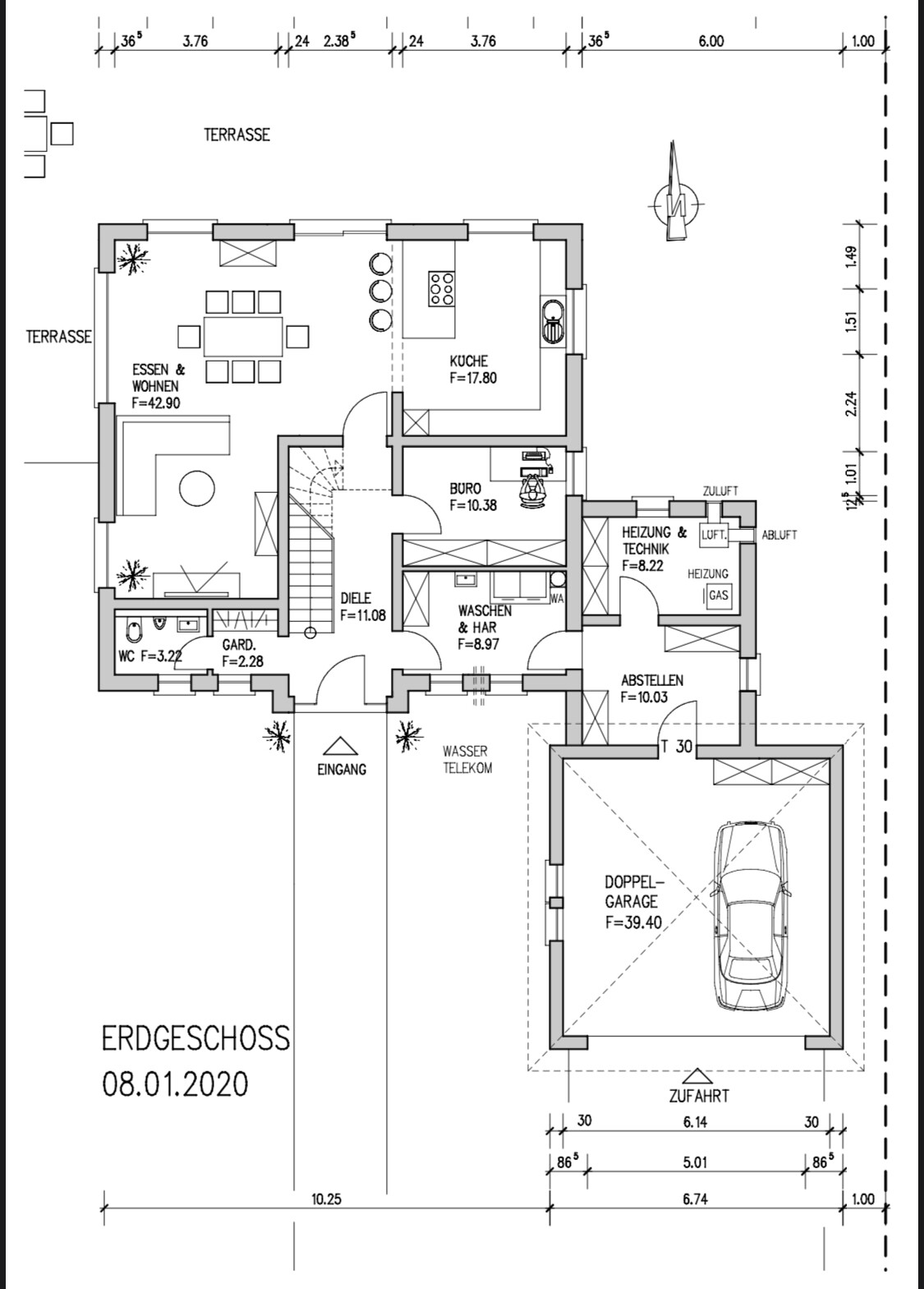

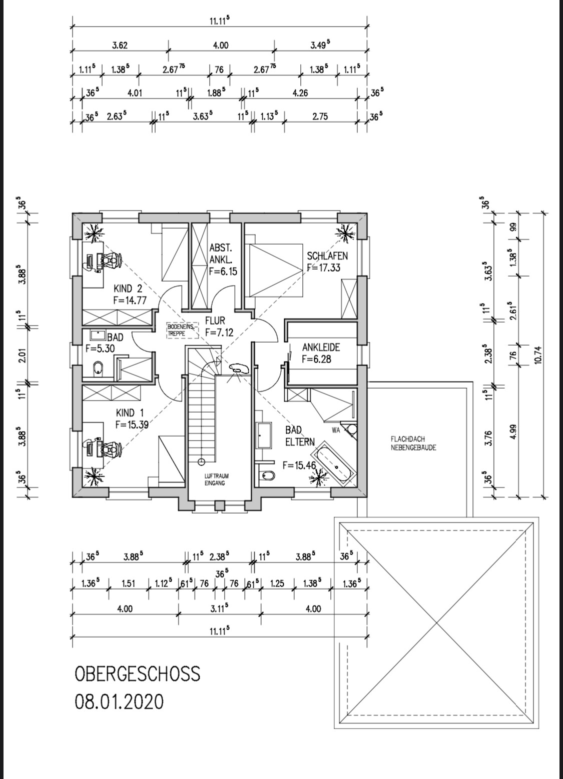

The upper floor layout was implemented as discussed;
The architect added an open space in the entrance area, which we find very good.
What do you not like? Why?
Since we did not want a flat roof on the garage, a double garage with a hipped roof was planned, followed by a flat roof extension to provide direct access to the house.
However, the layout of the rooms for laundry + drying, heating + technical equipment, as well as pantry + utility room, feels somewhat awkward.
If possible, we would like to switch the pantry with the laundry room and add a pantry off the kitchen.
This would allow the outbuilding to be slightly smaller and the kitchen window to be enlarged. However, I suspect this will increase the overall footprint.

Schema section: residential house and garage with roof structure and measurements
Right side view of a two-storey house with extension, window fronts, and garden plants.
Rear view of a two-storey house with terrace, side extension, and hillside location.
Left side view of a two-storey house with outbuilding and trees.
Front view of a two-storey single-family house with central entrance and garage on the right.
Upper floor plan: hallway, master bedroom, walk-in closet, master bath, 2 children’s bedrooms, storage room
Ground floor plan: living room, dining area, kitchen, office, WC, double garage, terrace.

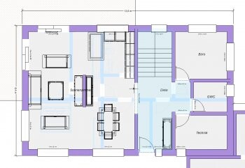

maxl229
8 Jan 2020 17:48
attached is a new draft.
The following points have, in my opinion, been improved:
- Living area with west-facing orientation
- Utility room including laundry replaced with "storage"
The following issues remain:
Since the entrance of a townhouse is usually located in the middle, the staircase cannot be changed with the existing rooms.
As a result, in this draft the living room is too small and the kitchen too large. Of course, swapping these two rooms would be possible, but this would negatively affect the lighting in the living room.
In any case, the living area must be enlarged, whatever the solution may be.

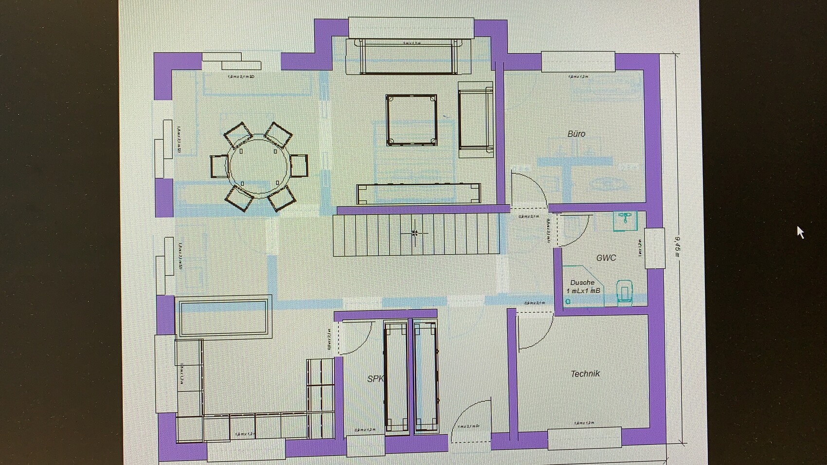

kaho6748 Jan 2020 19:10
Since you don’t want to change this layout ( ), the only option left is to get creative and add a large bay window. However, that would be quite expensive. Otherwise, I can’t think of any other solutions.

Basically, I could imagine moving away from that.
You also provided, thanks again for that, some alternatives.
Unfortunately, none of them really convinced me.
In one version, the view while dining faces the street, and in the other, I’m not quite happy with the room layout..‍
