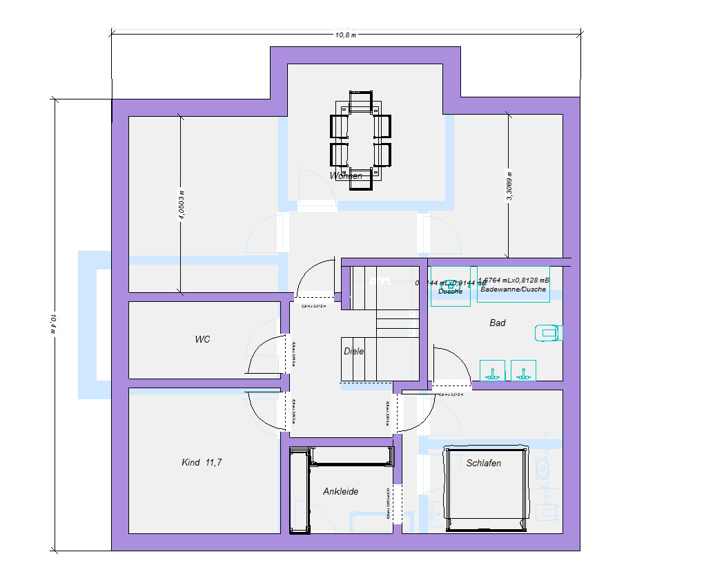

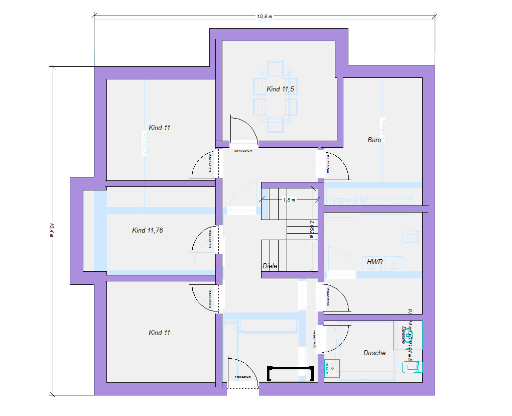

kbt09 schrieb:
I gave it a try myself.Sorry, I’m joining this conversation quite late and honestly have no idea what it’s about. I just wanted to say that I really like kbt09’s design. That’s why I took the liberty of grabbing it and making some adjustments. What I didn’t like so much—also in the original draft—were the doors for Child 3 and 4 on the lower floor and the small bedroom upstairs. So I thought, if the budget allows, it might be beneficial to add bay windows here. Due to financial reasons (the roof!), I would probably skip that upstairs. But I left the one in the living room for now. It could probably be removed as well.I reduced the kitchen size to make the bedroom bigger. Was anything special planned for the kitchen?
The stairs have slightly different dimensions, but according to Staircase 101, it should be okay.
On the 3m (10 feet) to the left, a shed, carport, or similar structure may be built right up to the boundary.
There are two cars. One is parked in front of the house, the other, for example, on the left with the wheels under a carport.
Perhaps I should mention that we are committed minimalists and promptly give away anything unnecessary. Three of our children don't even have a proper wardrobe yet because the shelf has sufficed so far and they did not feel the need for one.

@kaho674 ... so you have actually made the house smaller—right? The dining table is 220cm (87 inches) long, and the piano needs to be accommodated. Unfortunately, a few measurements are missing from the drawing. Also, bay windows are a cost factor.
@Arifas ... please sketch the house, shed, garage, carport, and parking space for a second car on the site plan.
