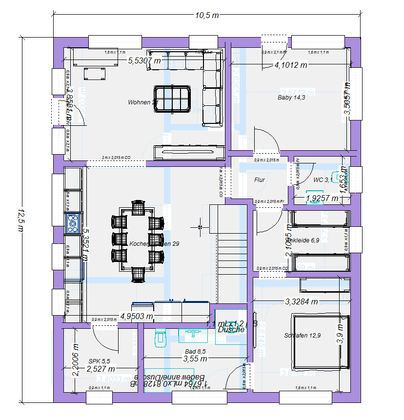

A different approach, larger – suitable for 7 people in my opinion. Aims at the initially mentioned 10.5 x 12m (34.4 x 39.4 ft).
The staircase to the attic is unnecessary since it is a pantry – saves heating costs.
The office would need a light well – feasible and sufficient?
I found it important to have a spacious dining/living area where there is simply plenty of room when you come upstairs. In the center, the large table invites you to play board games or do crafts.
