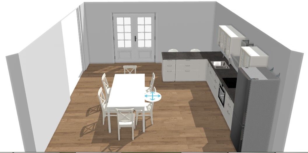

haydee schrieb:
For us, the table would be too small. It only fits 4 places to eat.
Just remove the pantry and plan a large peninsula instead of an island, or at least cabinets instead of a pantry.Here is a new layout (without pantry, without kitchen island).Terrace door 3m (about 10 feet) should also provide plenty of light.

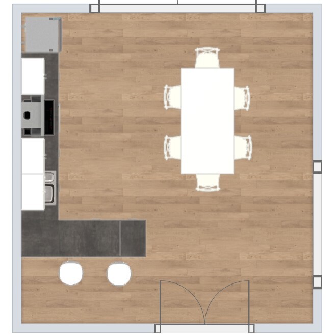

evelinoz schrieb:
Your open-plan room dimensions don’t fit at all, neither front nor back.
[ATTACH alt="hbforum1.jpg"]69428[/ATTACH]
The kitchen is too dark, too long, and too large for a 135m2 (1450 sq ft) bungalow. Even if you remove the unnecessary pantry and straighten the living room wall, it’s still too much kitchen.
The living room door should preferably open into the hallway. It’s oversized for a 135m2 (1450 sq ft) bungalow. You should have at least 250cm (8 feet) of wall space to the left side of the door, a bit more would be better.
The terrace door needs to be moved further to the right on the plan. The partition wall at 5m (16.4 feet) is completely in the wrong place.
Instead of the pantry, place four 60cm (24 inch) tall cabinets on the back side in the hallway area, remove the storage room, enlarge the wardrobe and/or expand the utility room to create a better laundry space, something many forget or prefer to have a 60m2 (645 sq ft) open-plan room where the washing machine is squeezed into some dark corner. Thanks first of all for the feedback.
I’ve now designed the kitchen without a pantry and island.
Why is the partition wall wrong if I have the couch and TV behind it? I don’t want to sit in the kitchen/dining area or have a full view into it.

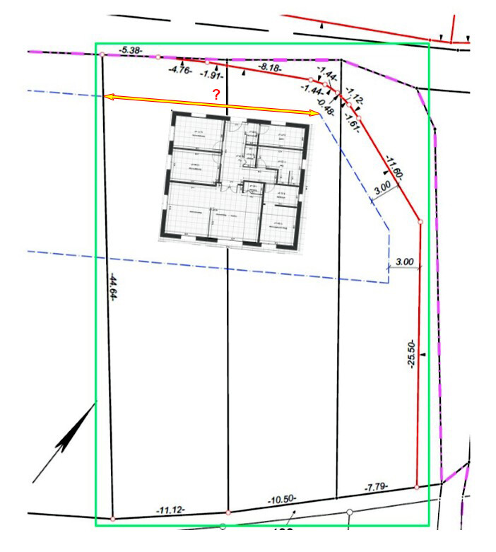

The plot is approximately 28m (92 ft) wide and 40m (131 ft) deep, with a building line set back 15m (49 ft) from the front.
evelinoz schrieb:
Because the table is against the wall? You need to move the wall.That's right, with an island there wouldn't have been enough space for a table. I removed the island.Henner77 schrieb:
The plot is on average 28m wide and 40m deep (building line 15m deep (49 feet))And how long is this distance?Similar topics
