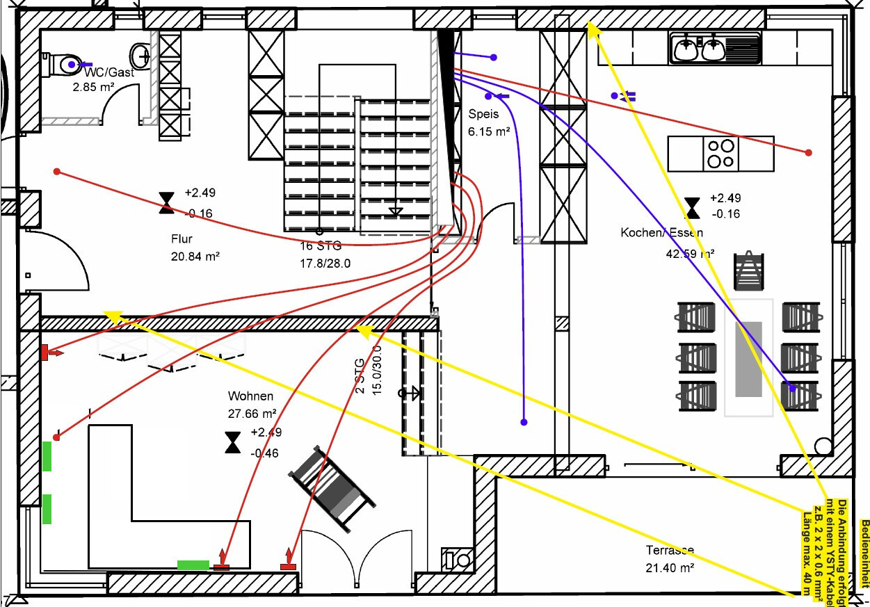

Originally, the system was planned with ceiling and wall outlets.
Here is the manufacturer’s plan, with the outlets we would now position on the floor marked in green (the sofa is schematic, it will be approximately 80cm (31 inches) away from the left wall).
Does this require a new plan? (The exhaust outlets in the ceiling of the kitchen, pantry, and restroom are still present.)

Mycraft14 Jul 2018 12:08
I see no reason not to do it this way. It can be done without any concerns.
