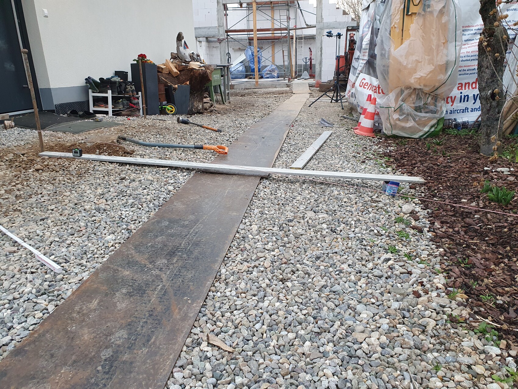

For the chamfer, I was thinking of using 45-degree triangular wooden wedges like shown in the picture?
Attached are a photo of our entrance and an image of how I imagine the platform.

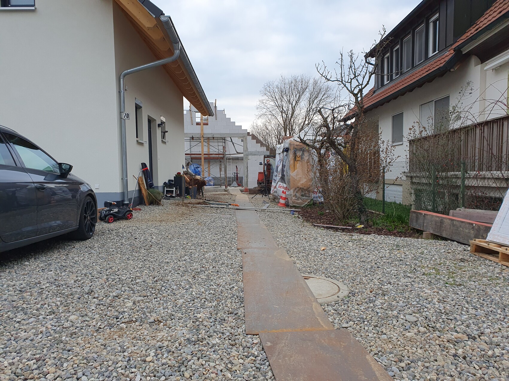

danielg4027 Feb 2024 17:28Yes, we want a single platform and no steps.
Therefore, the driveway would need to be paved with a slope of 3.5–4 degrees (°) downward toward the green strip outside.
The paving should be roughly level with the green strip there, maybe 5cm (2 inches) higher, so that soil doesn’t keep accumulating in the driveway.
Passing by the front door, there is also a driveway leading to the garage.
From the platform to the green strip, this driveway would be about 2.8m (9 feet) wide.
I would have the paving extend outward from the platform all around, sloping downward toward the front and back, so that the entire courtyard is at the same level.
hanghaus202328 Feb 2024 08:10danielg40 schrieb:
There is still a driveway passing by the front door, leading to the garage at the back.
This would be approximately 2.8 meters (9 feet) wide from the landing to the green strip. This is another reason against having a landing.
Looking at the pictures, there is still a lot of excavation needed to create the landing.
danielg4028 Feb 2024 08:37Hello,
Why do you think so?
I only added fill there as a transition.
I don’t need to remove that much to be able to build the platform.
The string line height would be the top edge of the platform; the batten on the left is 20cm (8 inches) below that, so the bottom edge of the platform.
And from the top edge of the platform to the green strip on the left, there is about a 45cm (18 inches) height difference.
