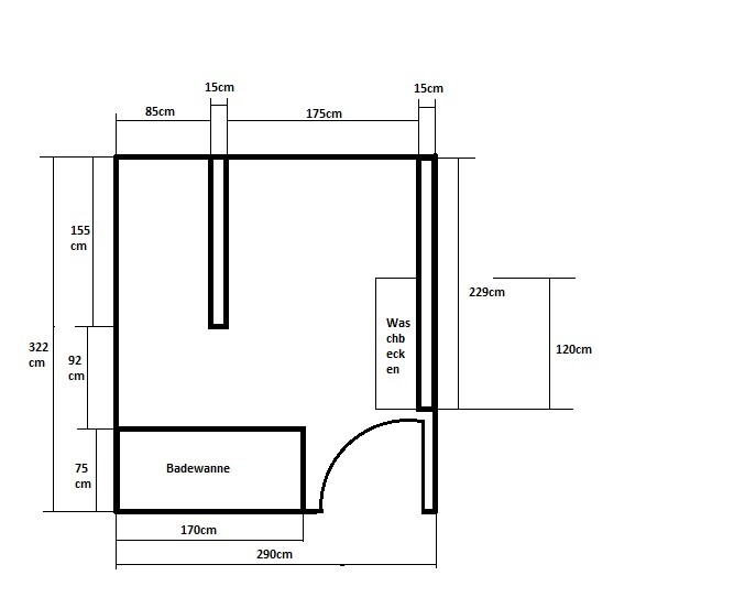

Golfi90 schrieb:
Attached is the dimensioned floor plan (plaster dimensions!) for our bathroom.
I’m looking forward to your ideas.
Unfortunately, I forgot to measure the position of the toilet (installed next to the washbasin). But that’s not that important anyway.Funny how everyone has their own preferences. Our bathroom layout is almost the same, and I really wanted the grout line in the shower to be centered since we have 60cm (24 inches) tiles. Everything else was planned around that. We also had the tiles cut on the back wall of the toilet so that they’re centered, because I hate when it’s not symmetrical.
So my tip: decide on what’s most important to you aesthetically, and everything else will follow.
For some, like me, the shower’s placement is key, while others care more about not starting the room with a half tile at the entrance.
By the way, as already suggested here, we used a different tile size on the wall, 45cm by 30cm (18 by 12 inches).
The tiler thought it was funny, but we had everything discussed in detail beforehand, and we measured and marked everything ourselves after learning from the mistakes in the bathroom on the ground floor.
