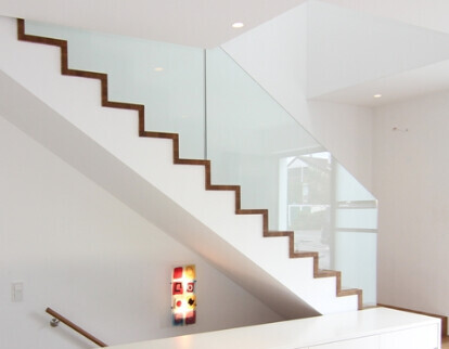

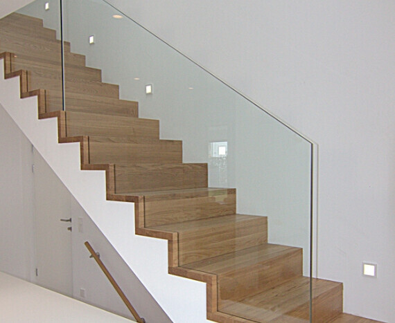

nordanney
3 Jul 2020 14:01
Alessandro schrieb:
What is lattice structure on a concrete staircase?
This:
Modern staircase with glass railings in a bright interior, white walls and dark steps
Modern wooden staircase with glass railing in a bright interior
Alessandro
3 Jul 2020 14:18
Thank you. I didn’t know that they are also called folded plate stairs when they have a supporting structure underneath. Learned something new again.
